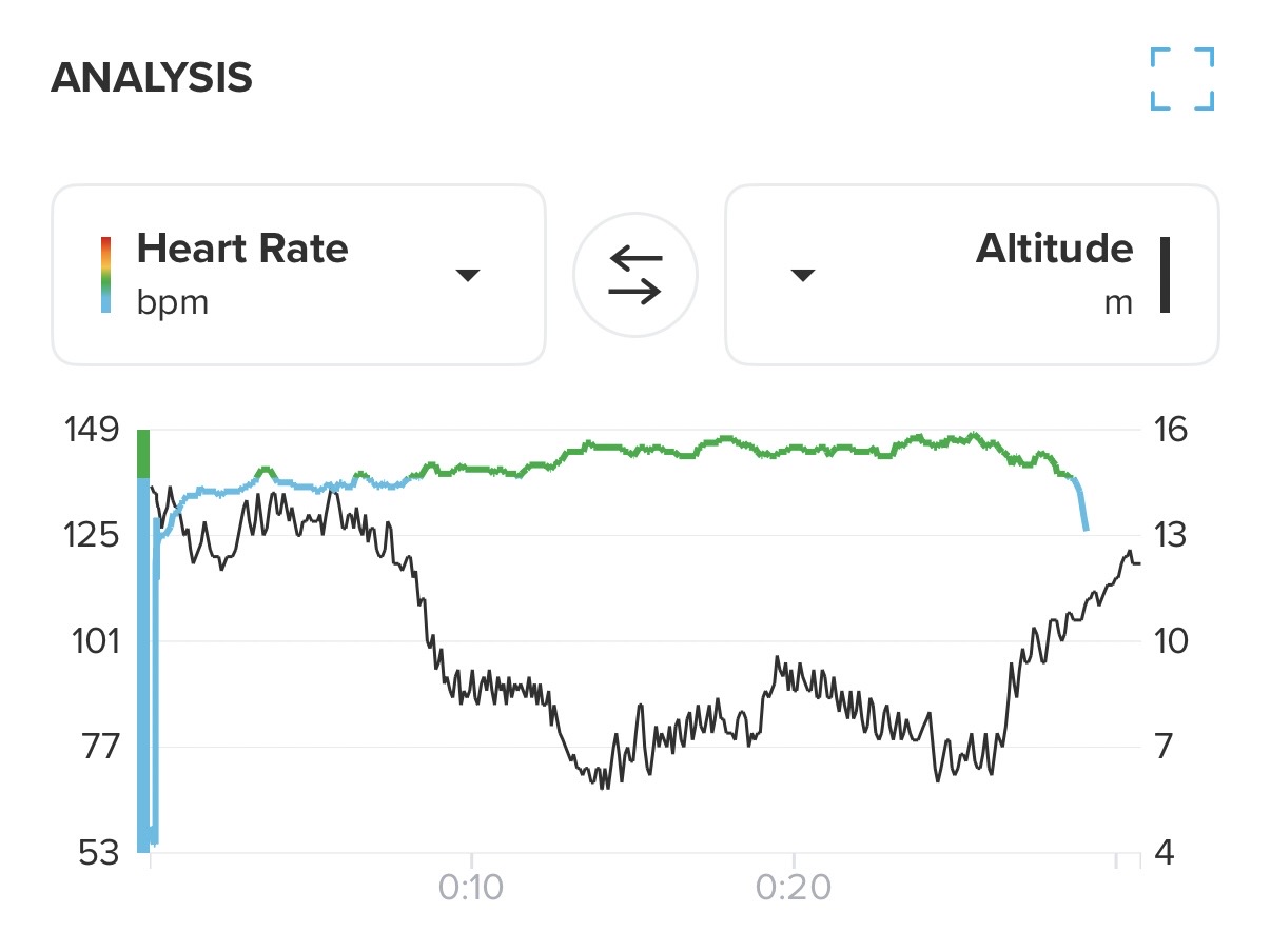

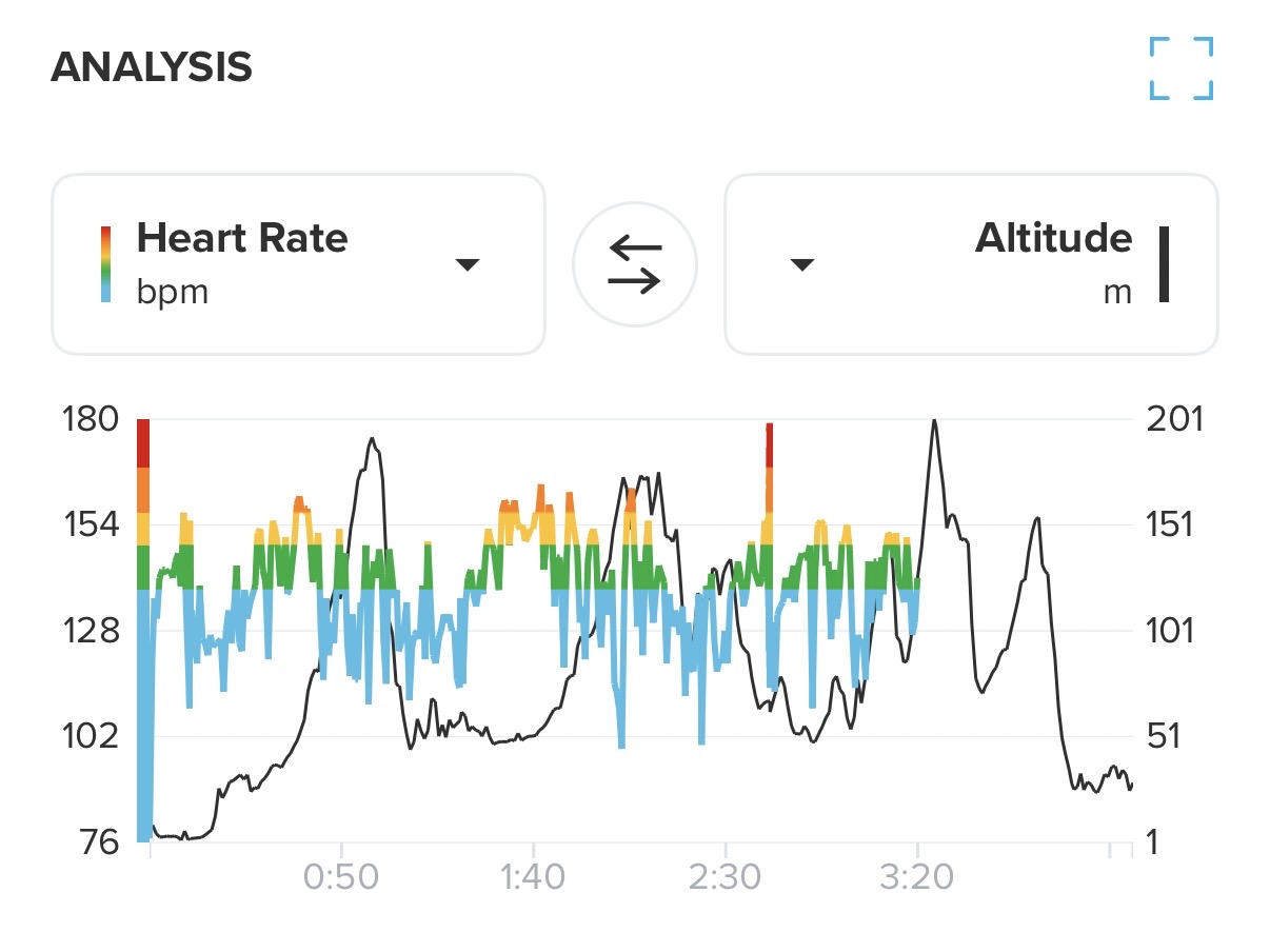

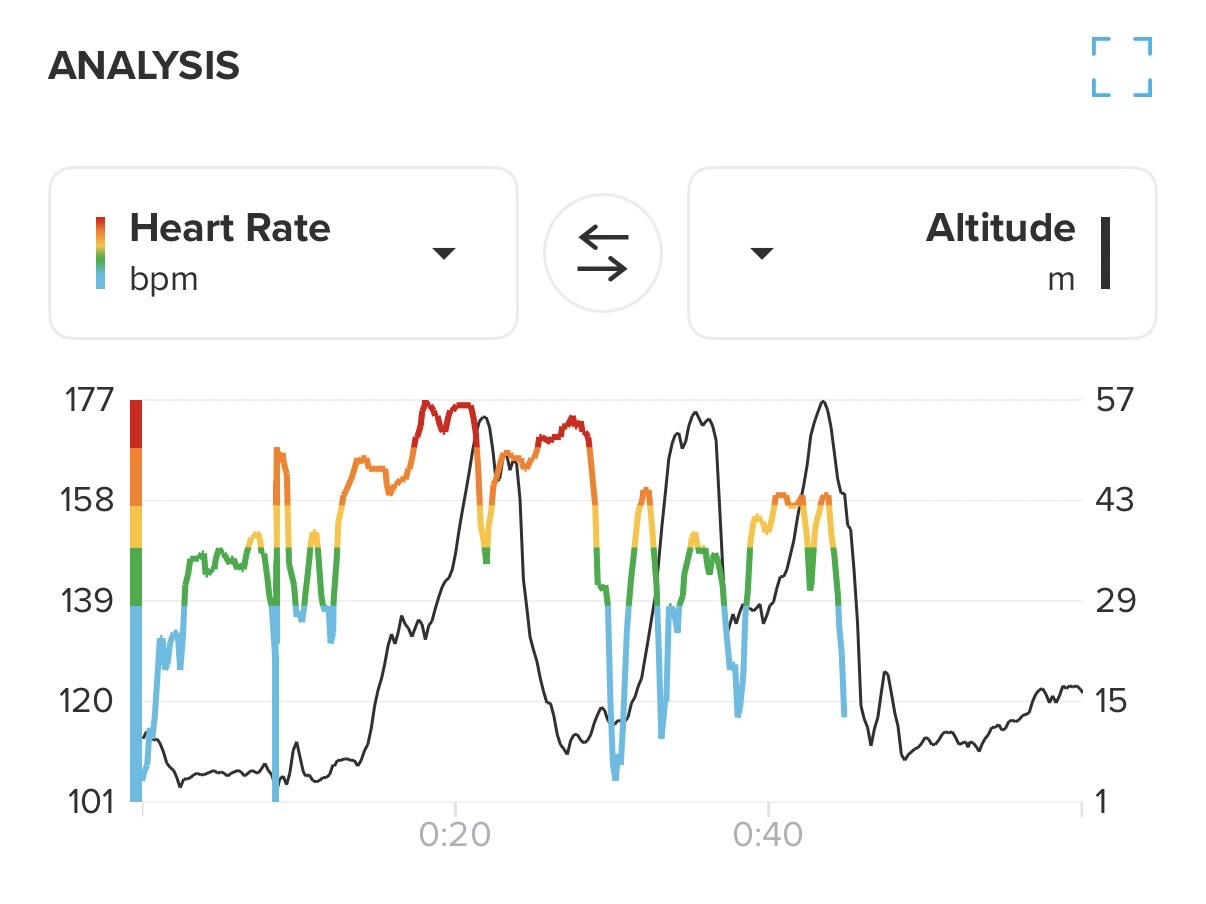

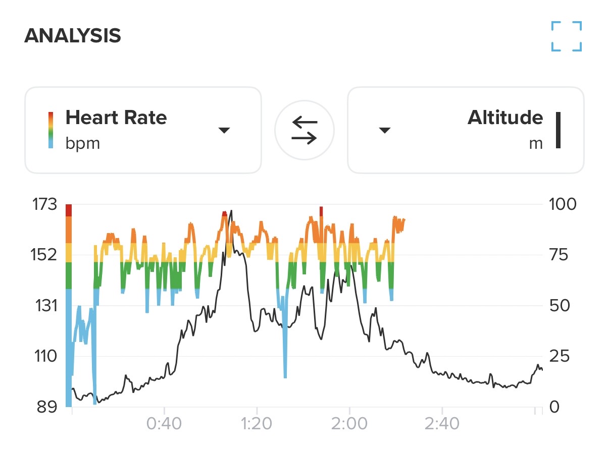

      I’ve been seeing issues where heart rate belt data just stops recording before the end of an activity. Not every time but probably like 20-30% of my rides and runs.
      You can see in the screenshots below how heart rate data just stops before the end. Sometimes it might be 5 minutes before, sometimes much longer. No specific event ties in with when it happens, it will just be seemingly random while I’m riding or running.

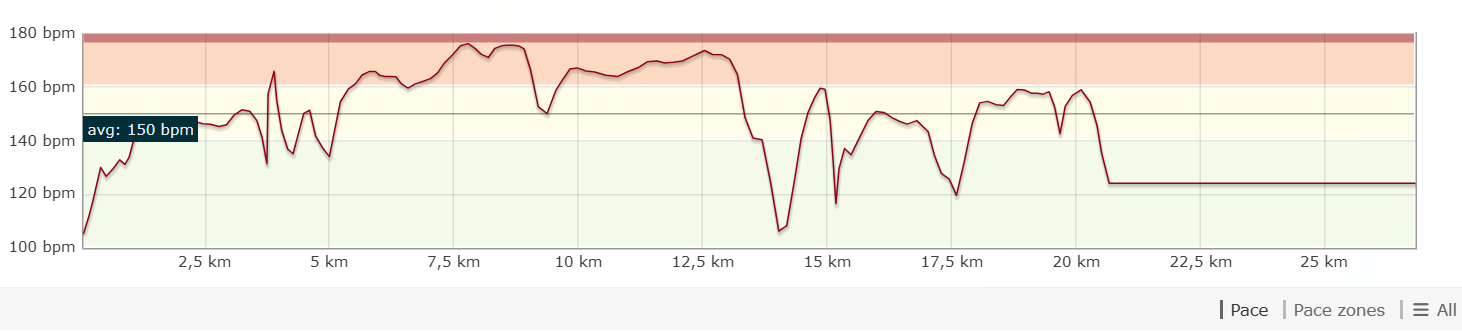

                          @Brad_Olwin right so I created a couple of Runalyze accounts and imported the Suunto Run fit file into one, and the Wahoo ROAM fit file into the other. Both were taking data from the same strap during the same activity as I dual recorded.
                          This is the ROAM activity:
                          This is the Suunto Run activity:
                          This looks really odd. It doesn’t appear that the Suunto is missing the data at the end, as the same pattern for the final 21-27km of the ROAM graph matches the 14-20km section from the Suunto graph. It looks more like the 4-11km section from the ROAM is missing from the Suunto graph.

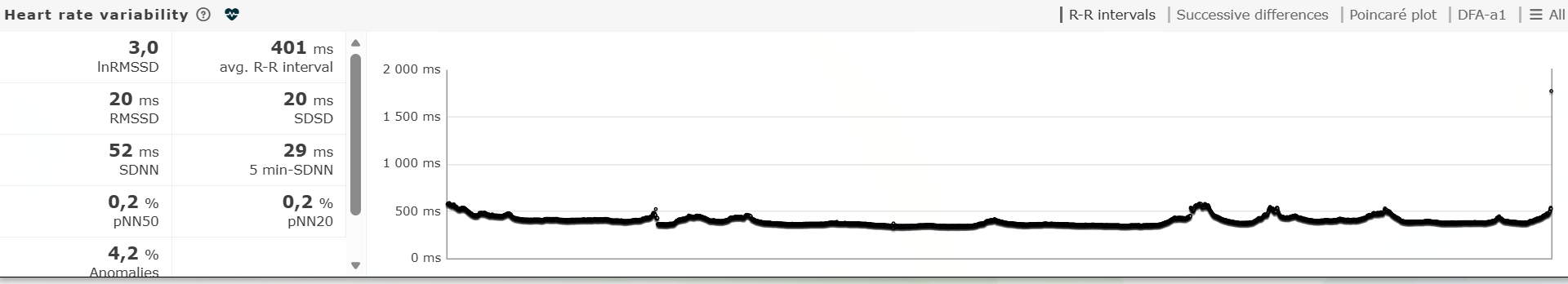

                            • O Offline
                              owend Bronze Member @Brad_Olwin
                              @Brad_Olwin ok this is what that graph shows for the Suunto activity. I don’t see the same graph on the Wahoo ROAM fit file:
                                Brad_Olwin Moderator @owend
                                @owend looks good

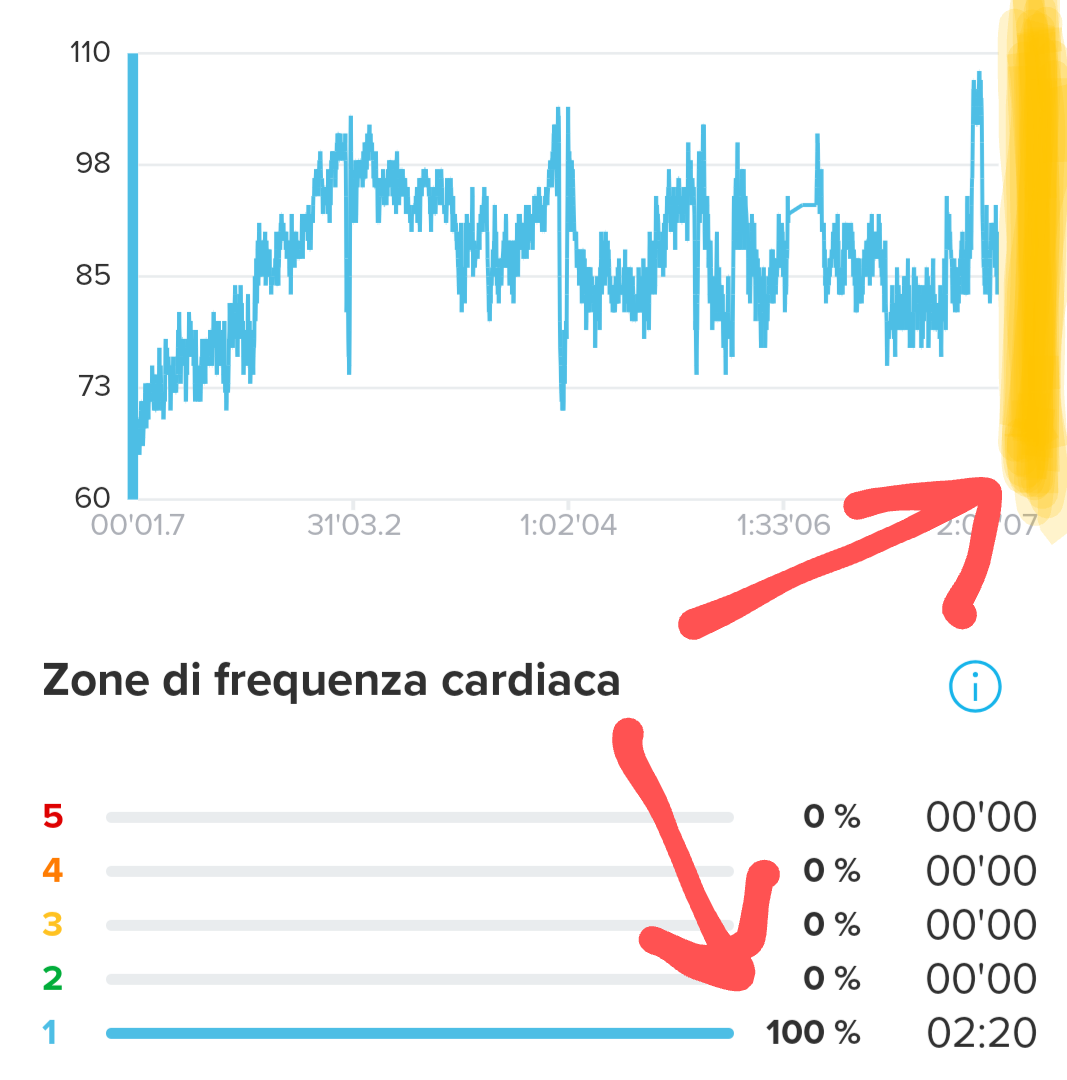

                                  @owend well, it happened to me too today, the activity lasted 2 hours and 20 minutes but the heart rate graph is missing the last 20 minutes or so.
                                  Suunto Run

                                      Hari Seldon @owend
                                      @owend It was a recovery session spent entirely in Z1 and I noticed that the time reported in Zone 1 corresponds to the total time of the session, so it seems to be just a “graphic” problem
