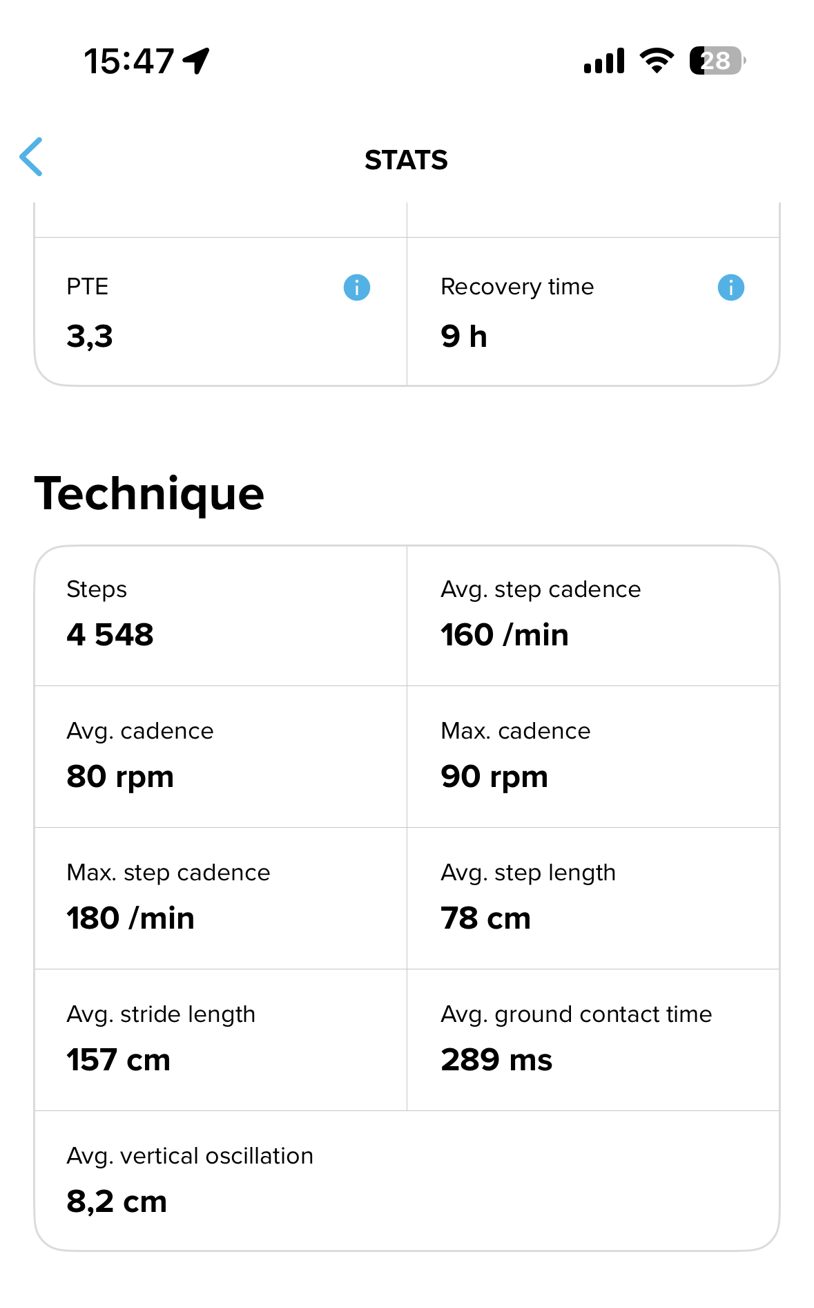

                                          I still don’ t understand how to see new running metrics (ground contact etc).
                                          I use Vertical 2 with latest firmware, with or without Stryd, with or without custom mode and in all cases I don’t see those metrics…
                                          Suunto App: Android Beta
                                          OutdoorManO EgikaE 2 Replies Last reply Reply Quote 0
                                            OutdoorMan Bronze Member @v.sacre
                                            @v.sacre I don’t have these on watch screen but these details are visible in the activity summary after you finish a run or in Stats in the app. Do you see this?
                                            v.sacreV 1 Reply Last reply Reply Quote 0
