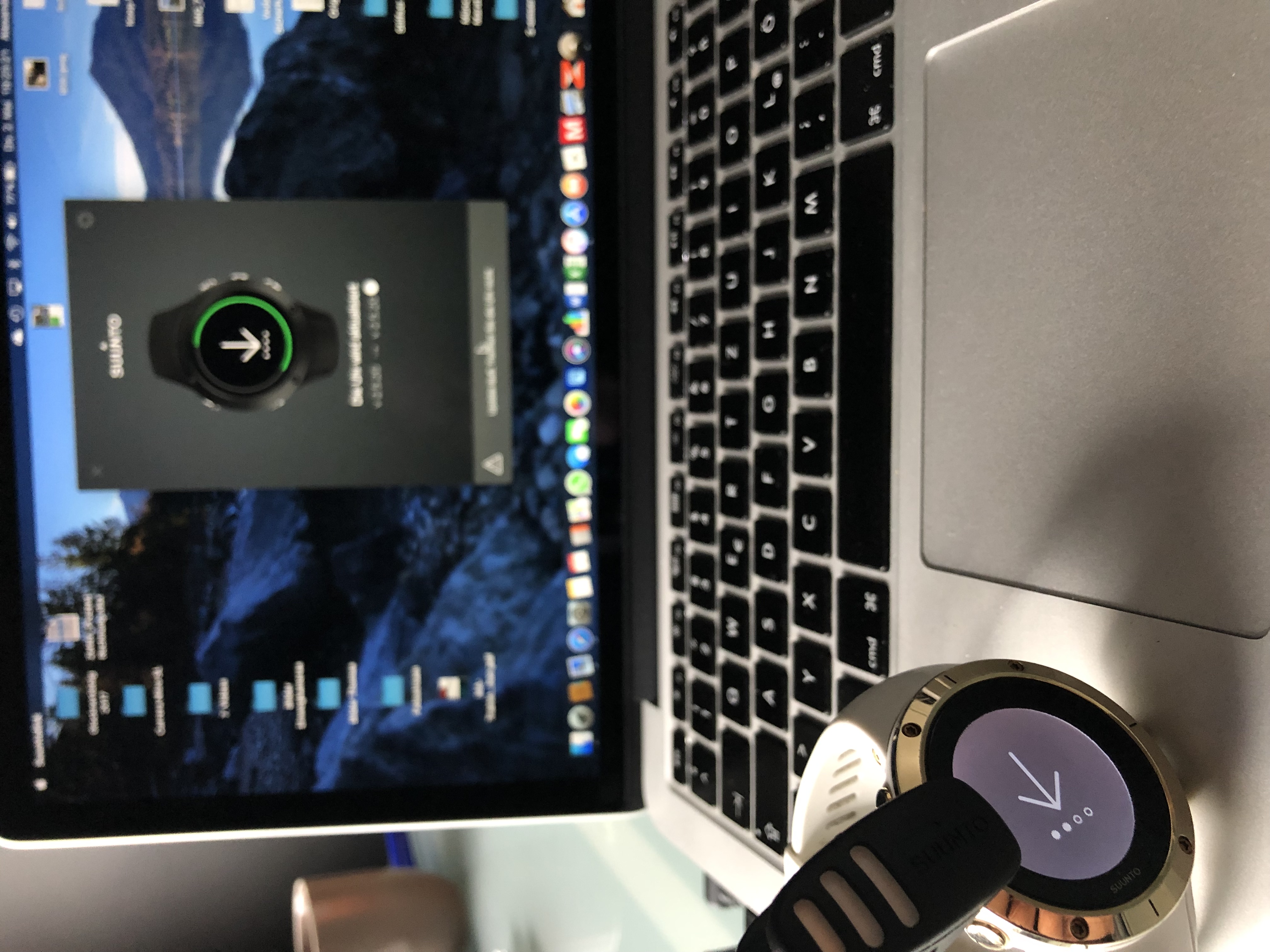

                    Alexander
                    the 5-finger-trick does not work, unfortunately. The first message (1.Image) is always “reset the clock required”, then he works, (Image 2,3) “the clock is updated” and then again message 1.
                    UPS comes tomorrow, the Watch is coming Home

                      Dimitrios Kanellopoulos Community Manager @Alexander
                      @Alexander-Scharl if you let the watch continue what does happen? Hangs there in the down arrow screen?
                      • AlexanderA Offline
                        Alexander
                        Yes, until the Battery is empty.
