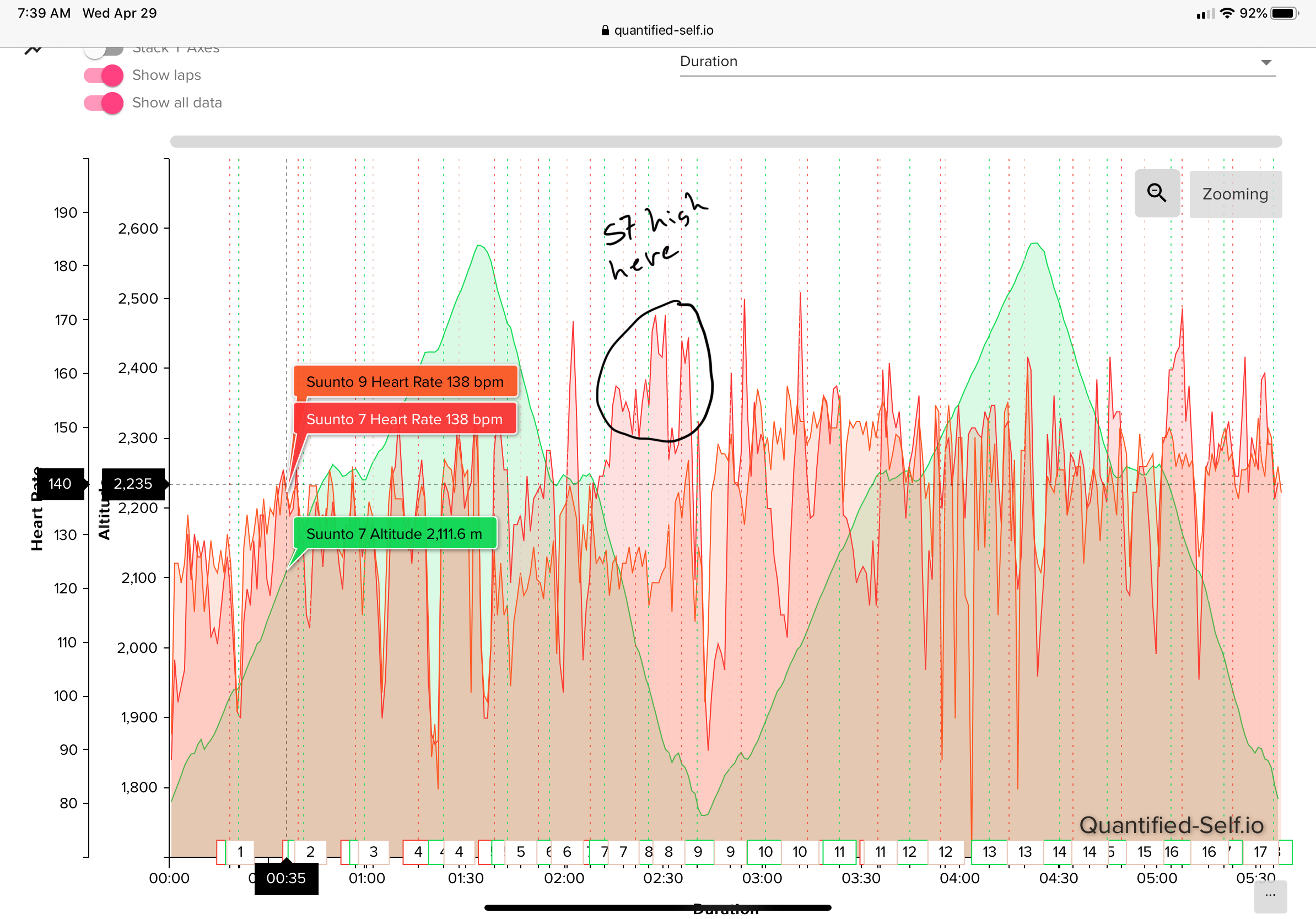

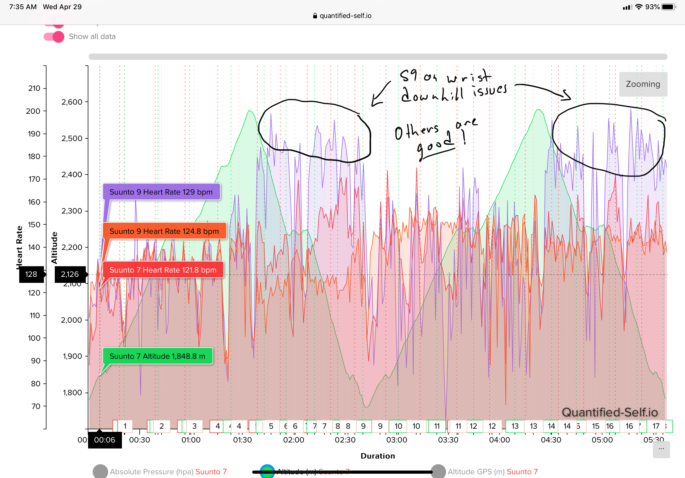

                            Brad_Olwin Moderator
                            Here is a comparison I did last weekend on a long run. One S9 with Velcro strap worn above the S7 (silicone on left wrist) on my forearm, one S9 on the right wrist (silicone strap) and the S7 on the left wrist. This was a very steep and technical trail so it is very hard for the watches when running downhill as they can bounce. The S7 only had a little trouble in one spot, and the S9 on my wrist was horrible, the other S9 was great. No strap but I can tell you the strap would like exactly like the S9 worn on my arm. All are OHR.
                            This shows the S9 OHR is fine, it just does not work well on the wrist for running. The S7 is much better.
                            JorgeFDJ 1 Reply Last reply Reply Quote 2
