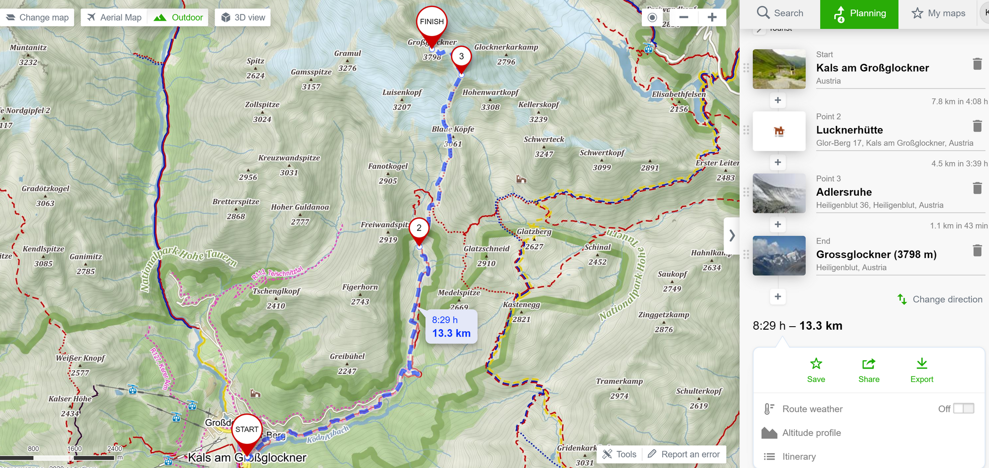

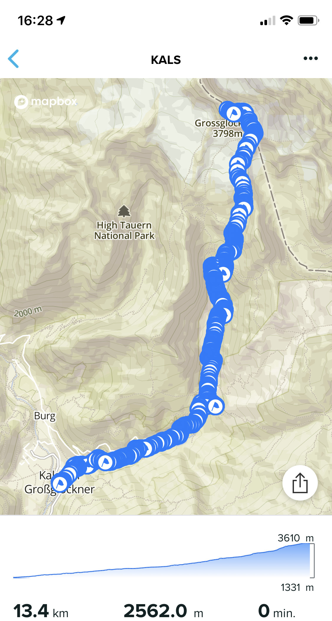

          OK, so here is my attempt to import a gpx route with WP to iOS SA using QS.
          It is a 13,3 km route with 2 WP.
          This is how it looks like:
          text alternatywny
          And this is the result in SA:
          text alternatywny
          Dimitrios KanellopoulosD paataP 2 Replies Last reply Reply Quote 0

            @kabzior that looks strange !

              @kabzior the same thing happened in my case when I used mapy.cz for gpx export and QS for import. Almost infinite amount of points.
                It can be the way it’s created. If they add a wpt (waypoint) for each dot sure.
                But that should not be the cases imo.

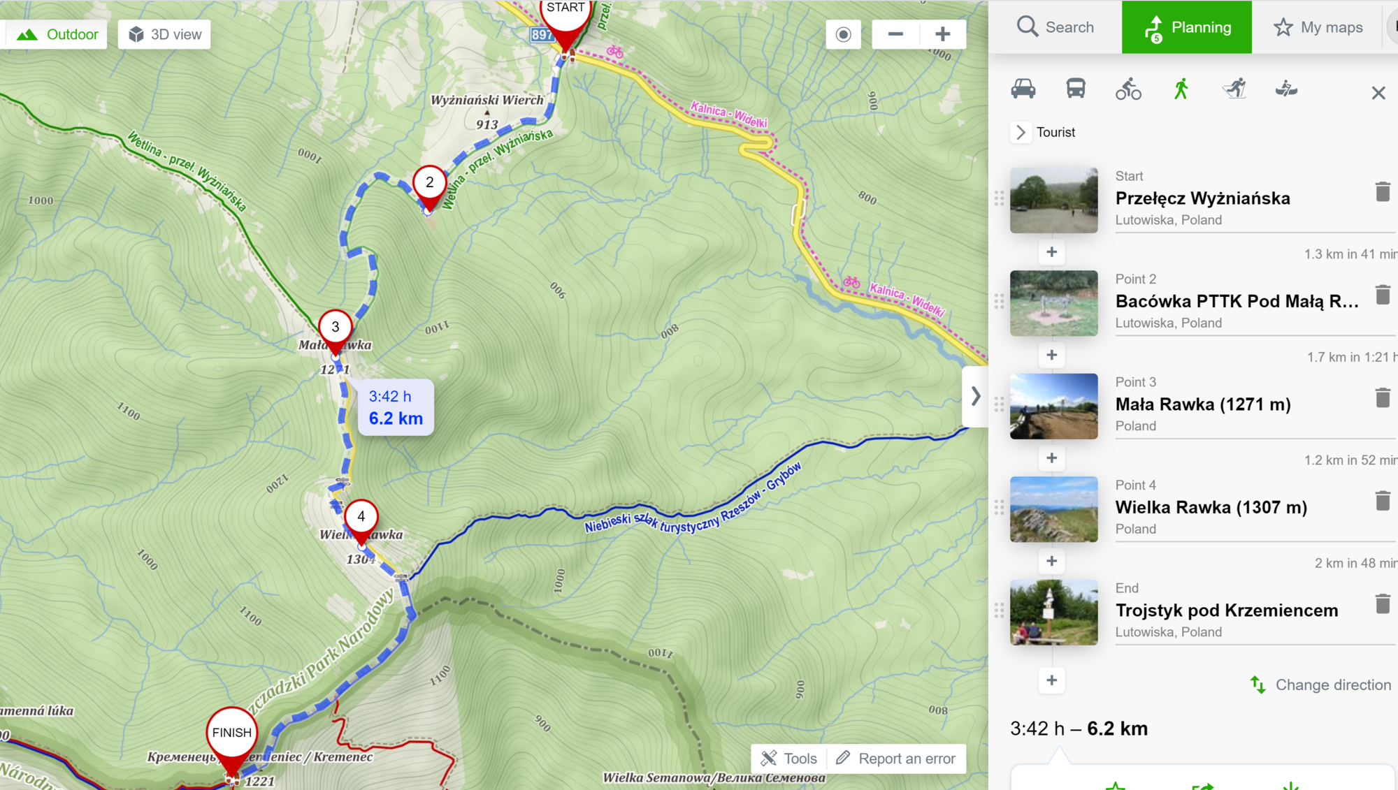

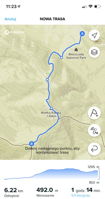

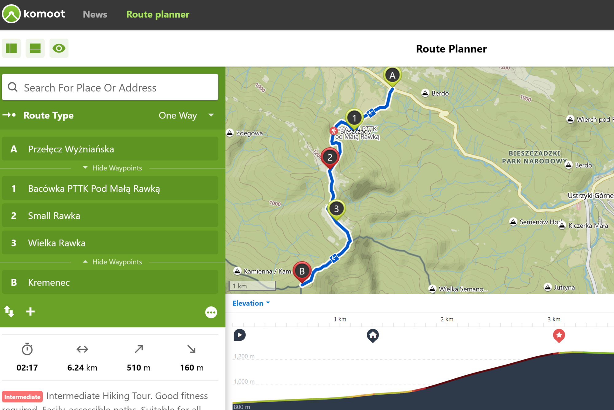

                  Well, since I am a scientist, I decided to check it with three repetitions on different sites that I use 😉
                  First off, here’s the route:
                  created in SA, it has 6.22 km and 492m ascent (the latter value seems wrong to me)
                  text alternatywny
                  Now let’s move on to the services that offer route creation and gpx export:
                  1. mapy.cz
                  2. komoot
                  3. mapa-turystyczna
                  text alternatywny
                  text alternatywny
                  text alternatywny

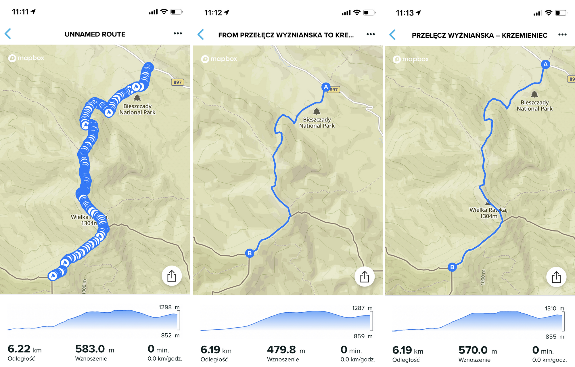

                  Okay, now that we have a mapped route, it’s time to import it into SA.
                  Below is the effect of importing a gpx file (saved in icloud) directly in SA (from the left: mapy.cz, komoot, mapa-tusrystyczna):
                  text alternatywny
                  Now exactly the same files, but sent via QS (same order):
                  text alternatywny

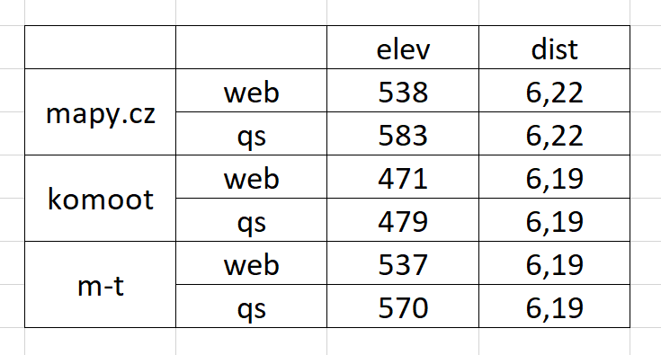

                  And finally a curiosity - summary of the distance/ascent from all three websites depending on the method of import (gpx file downloaded via web and uploaded directly or via QS):
                  text alternatywny
                  Conclusions:
                  1. None of the services allows you to import routes with WP, whether directly or via QS
                  2. Mapy.cz gpx imported by QS adds an infinite number of WP
                  3. The same route has a similar distance but completely different ascent depending on the site
                  4. The same gpx file has a different ascent depending on the import method (this is especially strange to me)

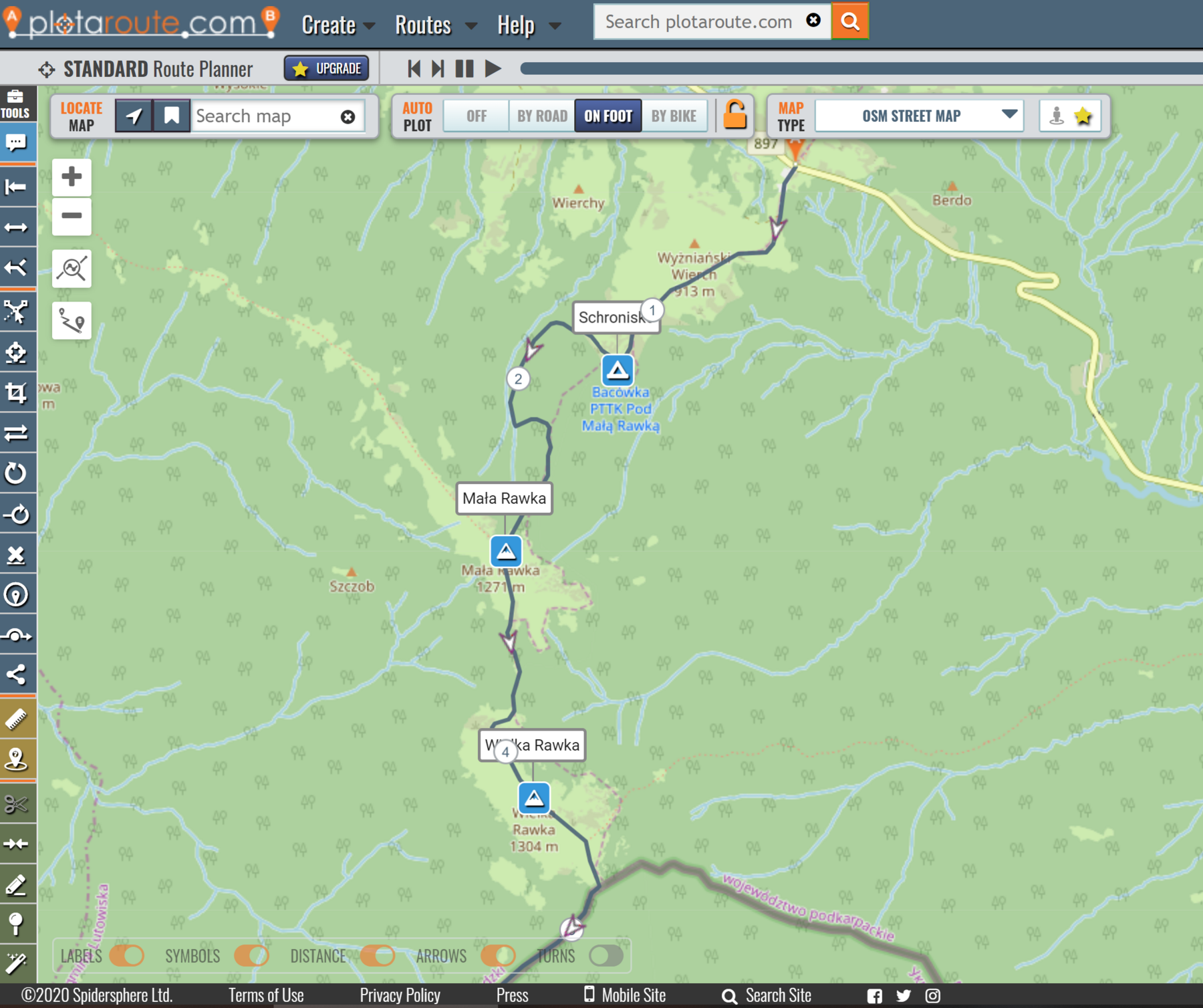

                                      margusl @kabzior
                                      @kabzior , you skipped all the tooltips in Plotaroute, didn’t you? 🙂
                                      1 - look for “Directions”
                                      2 - routes work just fine, as long as you use those with devices that can actually do routing. This is for cycling computers, handhelds and other turn-by-turn capable nav systems. Not for Suuntos.
                                      4 - take a moment to read tooltips of those buttons. POIs are generated only from directions that you have labeled or added a symbol to.
                                      Besides, what I suggested was just loading an existing GPX with existing Waypoints/POIs to Plotaroute and then download it from there as track with POIs, should even work without creating an account. The track you get back is already altered and “fixed” for use with SA.
                                      kabziorK 1 Reply Last reply Reply Quote 0

                                        No… not all of them 😄
                                        But seriously, either I’m technologically disabled or using this site is more difficult than average. This is my route, and after importing into SA I get non-editable A-> B without any WP.
                                        text alternatywny
