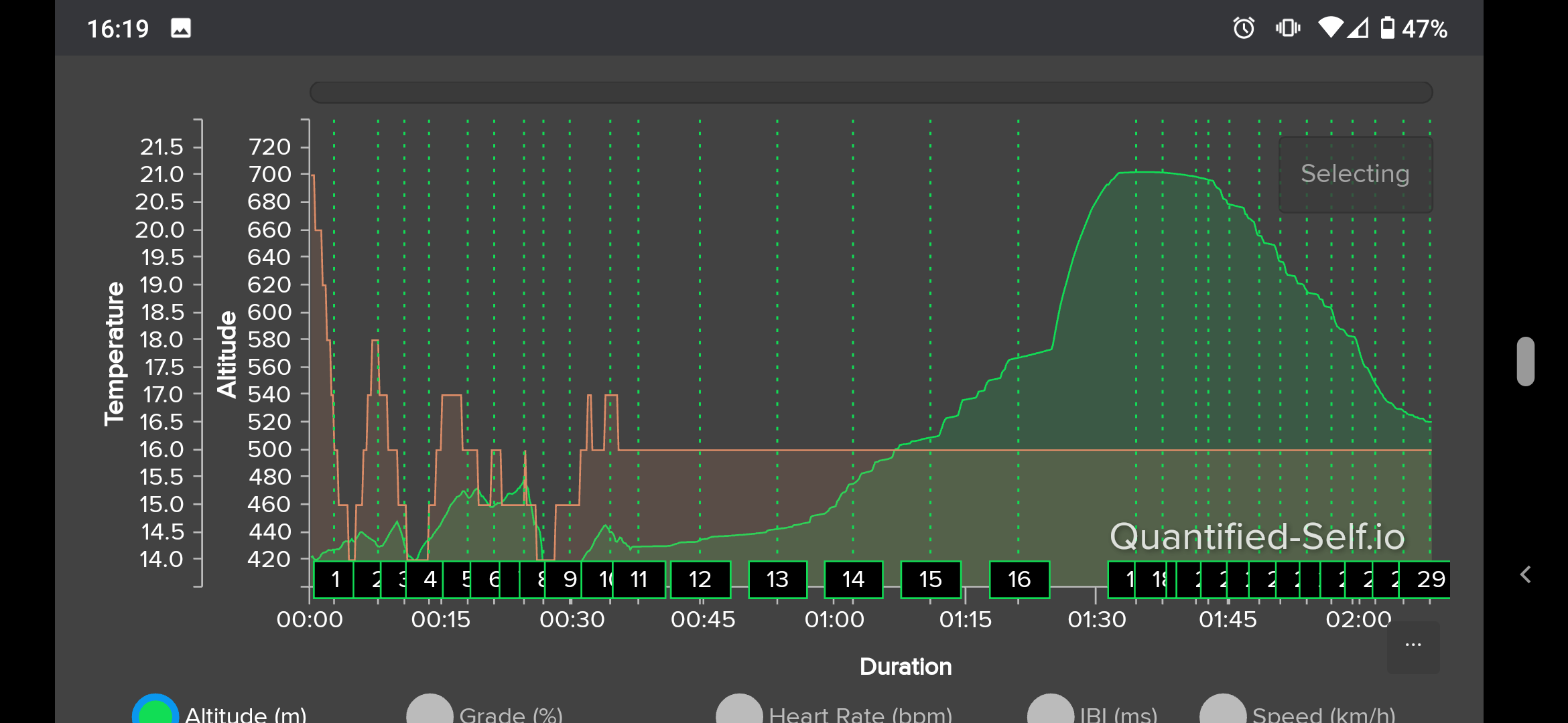

                    freeheeler
                    what do you do when Picasso annexes your baro sensor during an activity?
                    living sideways
                    Fenr1rF Dimitrios KanellopoulosD isaziI 3 Replies Last reply Reply Quote 0

                      @TELE-HO Turn the graph 90 degrees counter-clockwise and play “Guess the Famous Profile”?
                        Dimitrios Kanellopoulos Community Manager @freeheeler
                        @TELE-HO was that a pause ?

                          no, non stop recording…

                          I forgot to mention that after I’ve stopped the activity and the activity was saved the watch did an auto reboot

                            @TELE-HO ok. How is the temperature chart ?

                                that’s alright …hmm not existing?!? 😨
                                …and now that you mention it I notice that the vertical speed profile is missing, too. I thought I saw both, but when I doublechecked they were both missing

                                  resynced and temperature is back… but not correct as you can see.
                                  temperature went bananas well before the baro did.

                                    @TELE-HO I know this issue. Might sound strange but it might be an edge case that happens rarely. Not 100% sure why but it’s known and fixed afaik

                                        means it comes with the next update?

                                            @TELE-HO not related, but I had an issue with altitude too today 🙂
                                            The profile is not wrong, maybe a little hiccup here and there, but the ascent/descent are: I got a 12 up 37 down in the Suunto App. Runalyze recomputes ascent/descent based on the alti data and gave me a more reasonable 48 up 38 down.
