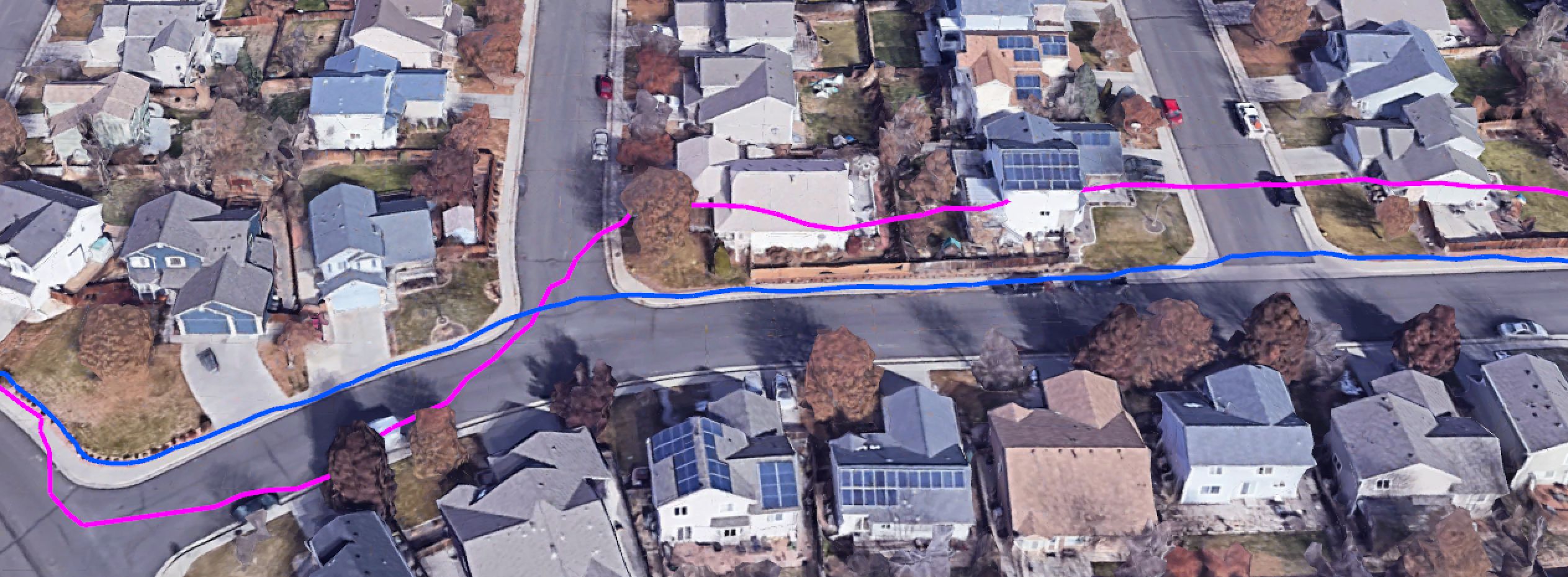

                                            Randy Penn @Brad_Olwin
                                            @brad_olwin I seem to recall that you are in Colorado, so I would think that your experience would be similar to mine. I posted these images in another thread but it didn’t get the traction that this one has, so I’ll repost them here. The blue track is from a Garmin and the purple one is the Suunto 7. Based on these, it’s pretty obvious why the distance traveled according to the S7 is always high. Are GPS tracks like those in the image the norm?Garbage track 1.jpg
