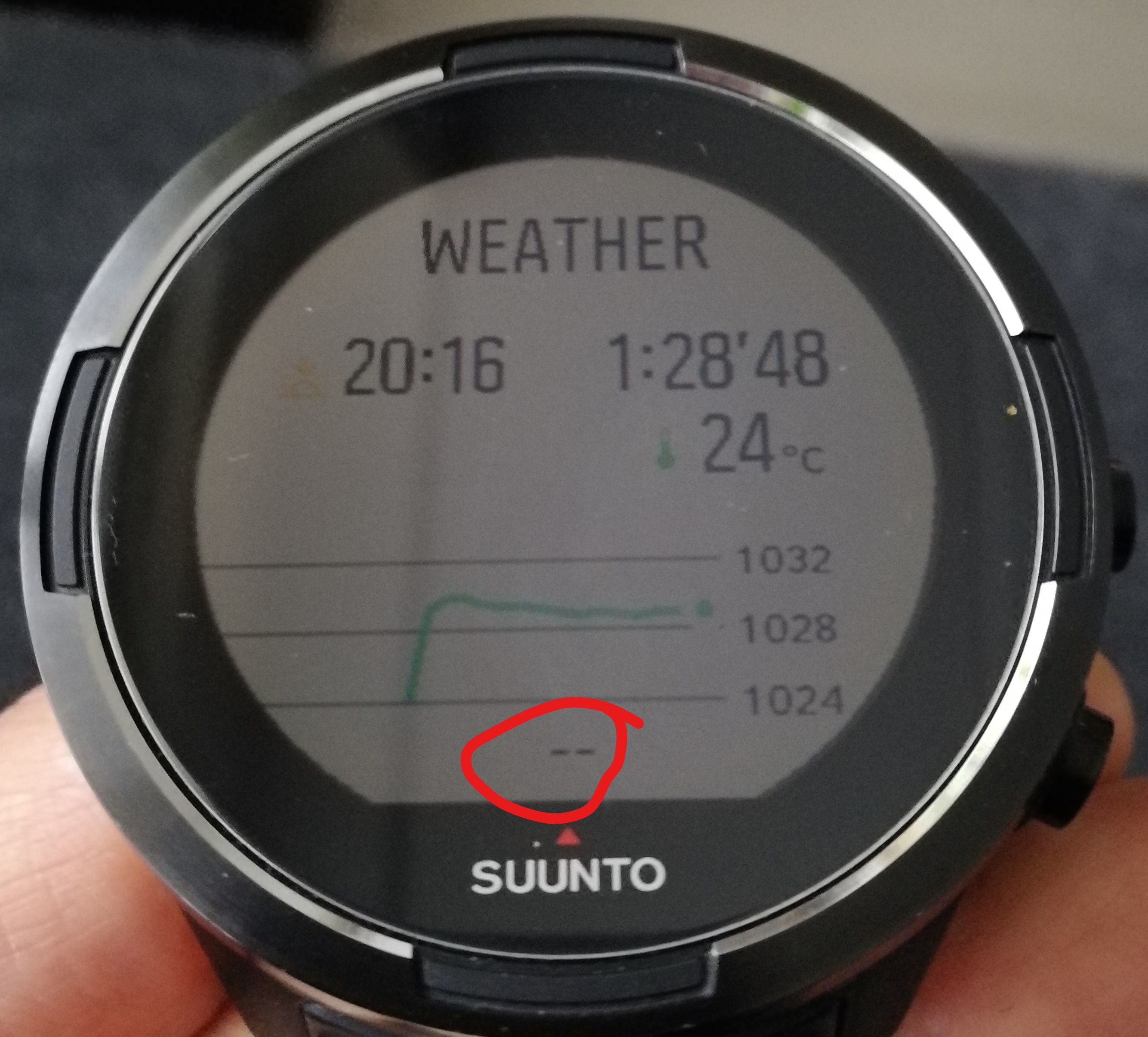

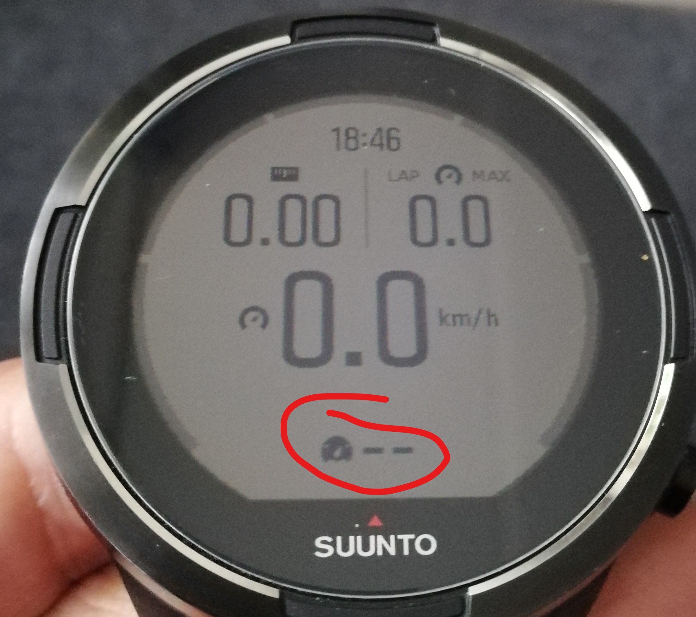

        @surfboomerang said in 2.14.12 is here:
        I am not sure if it was already available in the previous firmware update, but I noticed a new datafield in the custom sport modes: Sea level pressure.
        I suspected to see the hPa value, but instead it showed me a field with two dashes “–”. So my conclusion was that it was a representation of the baro trend arrows seen in the watch display as they were the same at that time. Now I noticed that the trend arrows in the watch face are going up, but the activity datafield still shows two horizontal dashes.
        Does the datafield represent the pressure change during the activity only or is it suppose to show something else?
        The icon also isn’t listed in the manual.(https://www.suunto.com/fy-nl/Support/Product-support/suunto_9/suunto_9/getting-started/icons/)
        Ok, I tested a little more.
        Looks like a problem in the windsurf profile. In other profiles it shows the hPa value.
        I recreated my windsurf profile and even tried the default one but both show two dashes instead of a value. Also the Suunto Plus Weather screen shows two dashes on the bottom.
        If I select the Weather screen in another sport mode the barometric pressure is shown in the bottem.

          @surfboomerang if you can share some screenshots you’ll save me some time and I’ll try to file a bug with Suunto. But I’m away from home this weekend, so I can’t promise it’ll be done before Monday.

            @isazi I added the sea level pressure fields to a hiking and a windsurfing profile. I also tested other profiles like running and sailing, but they also show the values like hiking.
            The spike in the weather graph is because of a soft reset of the watch.
            Hiking:
            Windsurfing:

              isazi Moderator @surfboomerang
              @surfboomerang reported to Suunto, I’ll let you know.
