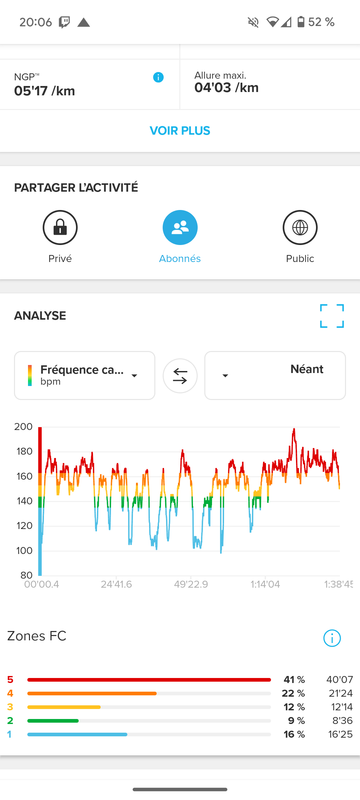

                                @Brad_Olwin for example this is my session of the day, and I still have the message “do 1 outdoor activity” after this one.
                                cardio graph
                                  Brad_Olwin Moderator @Liszto
                                  @Liszto one issue I see are your zones! Zone 5 for 40 min is not possible. I don’t know how you set them but they are too low. This may contribute to your issues with race prediction.
                                  LisztoL 1 Reply Last reply Reply Quote 2

                                    @Brad_Olwin I just update my HR zone just in case.
                                    They were the default ones (not defined by myself) based on simple compute 200-age (if i’m right). Currently 36 years old (soon 37)
                                    I change my max to something like 198 (sometimes the watch reached that value or more but I set this one because the accuracy of the sensor is not the best vs belt HR which is in my case often lower) and I change the percentage of each zone to match with something “more” logical.
                                    Let’s see during my next exercice what will happen. I just hope all my previous training session will not altered the next result 😬

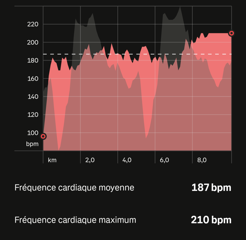

                                        @Brad_Olwin I would use my last 10km race because it was almost a perfect 40’ but I notice my vertical get an issue on it at the end… 😬
                                        I already noticed this bug twice before this one sadly where the sensor seems in default and stuck to something like 210 forever
                                        HR during 40min
                                          @Liszto Personally I do not get accurate HR using the optical sensor and always use a belt. But you could try the 40 min effort. Note that you should not be able to go any longer than 40 min at your LT.
