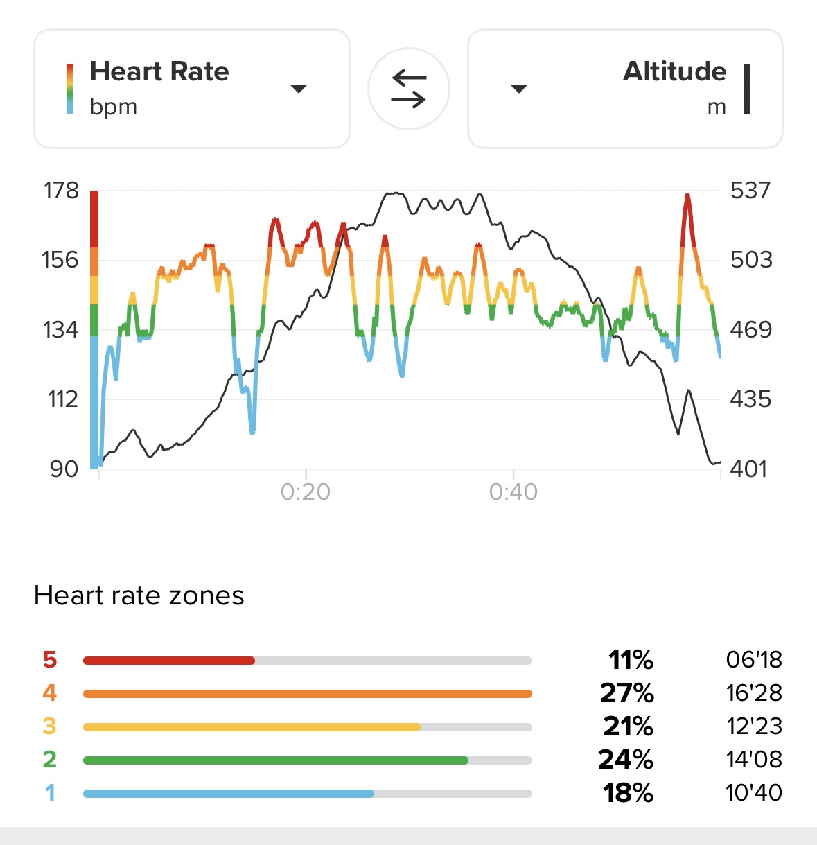

      I’ve been walking and running for about … 1 year? with Suunto Race. This is my last run from today. I’m generally not an intense runner, I go for distances rather than sprints, so my HR doesn’t go up that much, But this time I thought, what the hell, let’s see if this will make it work. Nope.

        @George-Katsanos I think you must run at least 30 minutes in your zone 4 and flat surface. In the case of the SR using the HR from the watch not external sensors.

          @cosme-costa in this forum I read you need 8 minutes of zone 2 running … I think 30 minutes would be exaggerating … any official Suunto representative to give us an answer from support?

            @George-Katsanos Could be that 30 min is too much but it was what I recall. 8 minutes seems too little for what I recall, the same for the HR zone, if you want to know your VO2max doesn’t make much sense to do the workout in zone 2.
            If you want to get the VO2 values try what I tell you: OHR from the watch, flat surface, 30 minutes in Z4 and you should get it. If you were using a SV you could do it with an external sensor but not yet with the SR.

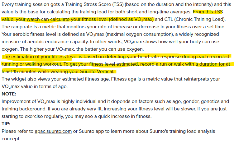

                    @timecode Sorry, but I have to disagree. It took me almost two years to get my first VO2max result on my Vertical. The first successful activity was a 65 minutes walk (average 6 km/h) and my HR stayed mostly in Z1 and briefly touched Z2.
                    Funny thing: the result appeared immediately after the last big SW update and I’ve been getting the results steadily ever since.
                    A long time ago I asked for exact requirements from Suunto support and there were all kinds of stuff: flawless GPS and HR recording, a specific period of time in Z3 or above etc etc. My activity did not fulfill those requirements which makes me think they have lowered the bar in software.

                          @timecode I think running and walking have always been the supported activities for VO2max. I remember it from my days with S9B.

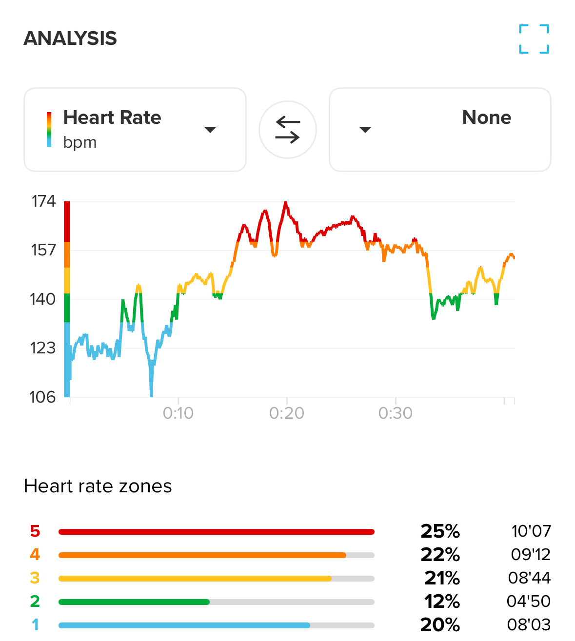

                                  @BrunoH I still don’t understand how can walking produce a Vo2max reading. I went for a run today and tried to push a few times to get a higher HR, still nothing. I am honestly getting a bit frustrated. If this is still not enough to get a Vo2max reading, then I don’t know… Max HR was 176.

                                      @timecode This is a snippet from Suunto Vertical documentation. The watch does not measure how exhausted you get but VO2max comes from TSS score.

                                            @timecode have you tried doing the same kind of run, with a mix of zones, on flat terrain?
