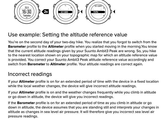

                                          Have you defined the ambit to use barometer or automatic in alti-baro (if you set the altimeter i think the alarm is not triggered) ? ca12fc45-a74d-496e-86c1-ca2f36bdd566-image.png

                                            @thanasis I have it set to automatic. It has been in the drawer for 2 years. Haven’t used it since I got my vertical. I just make sure to keep it charged, I don’t think you can turn it off and I don’t wanna leave it with empty battery…
