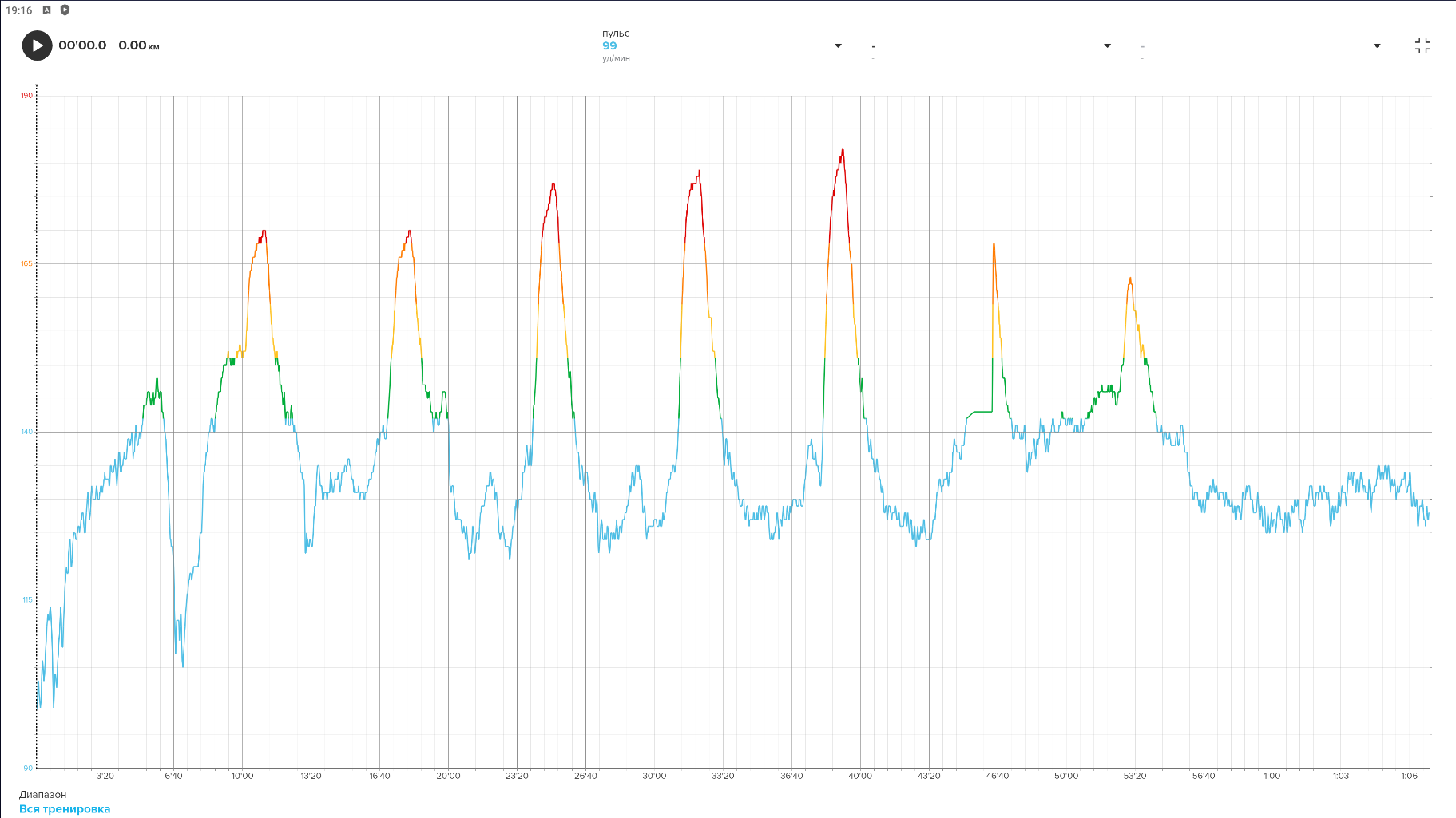

      @Brad_Olwin The battery is new, shows 100%. The contact pad is gray. The data is interrupted not at the beginning, but during the activity. Since this happened with the old H10, and now with the new Suunto, could the problem be in something else? For example, in the connection between the sensor and the watch?
      A recent example is below, 45-46 minutes.
      Today’s activity also had a couple of gaps 2 hours after the start of the activity.

        This could be due to the strap getting dry and/or a tech shirt that may cause static. The first graph is HR, correct? I see where data are missing. I have had the same occur to me when on a SkiMo outing caused by either the belt not completely contacting the skin and dry, cold weather where the belt is not wet and I am not sweating enough. You might try a gel on the belt, it looks to me like the connection between you and the belt is an issue.

          @Brad_Olwin Yes, the first heart rate graph. Yes, I will try using the gel. Thank you!
