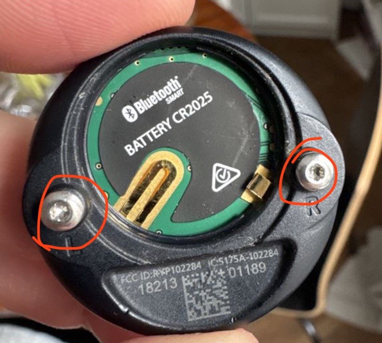

          Artus Diver @Mattg576
          @Mattg576
          Check the area around the pins for cracks.
          If there are any cracks, moisture may have gotten inside, which could cause measurement errors.

            althaea35 Bronze Member @Mattg576
            @Mattg576
            Yes, exactly this happened to me.
            Purchased a replacement belt, as it was a few years old and this had previously been the root cause of the issue, but turned out to be the sensor itself.
            On closer inspection I did find some moisture inside the old sensor.
            I now have two newish belts and one new sensor.

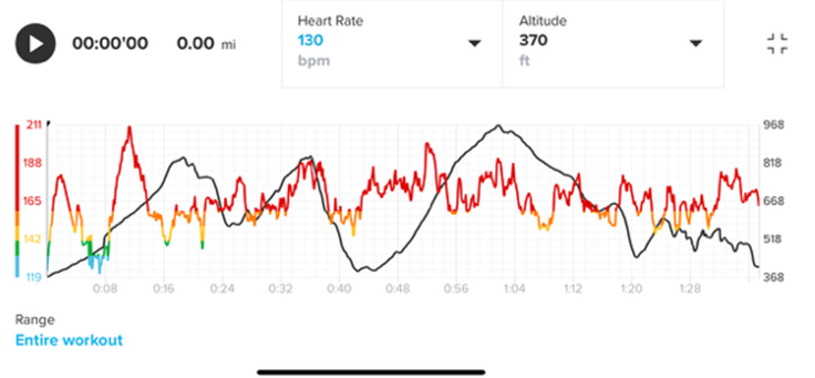

                          I’ll just be happy to have a working belt again as I used the watch OHR yesterday & the end result was laughable😂
