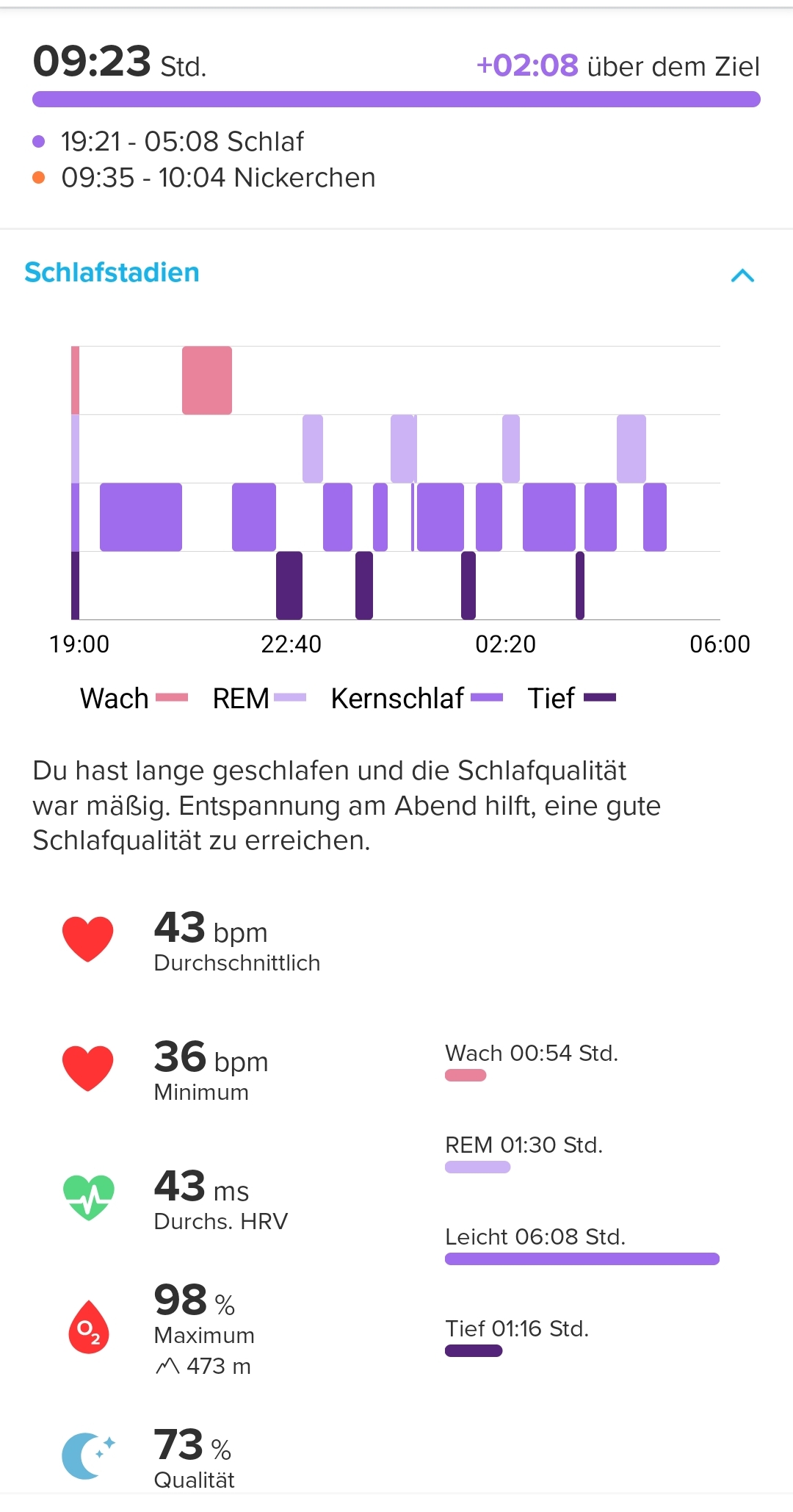

              Improved the accuracy of sleep monitoring
              I have the impression that it didn’t get better with the sleep recording. Before the update, too little was recorded, now too much.
              What about you?
              I still wish that Suunto would allow a correction in the app or the import from another source: https://forum.suunto.com/post/170029
              Here is an example. Yesterday I had done something at the desk in the evening, so relaxed that it was recorded as a nap. I saw that in the watch when I went to bed almost an hour later. In the morning, I see that the nap was then counted on sleep, with almost an hour of waking up😕
              The nap had almost reached the time window at the set bedtime. I have now made it a little closer again.

                @Yves-Jenni Frankly, I don’t look at it (I mean I totally ignore the sleep stages), it’s only enabled to record HRV, but I must say that the recorded sleep intervals are correctly detected more often than in the past, and the same goes for naps. That said, the above recording is rather bizarre, and I suggest you report it via the app.
