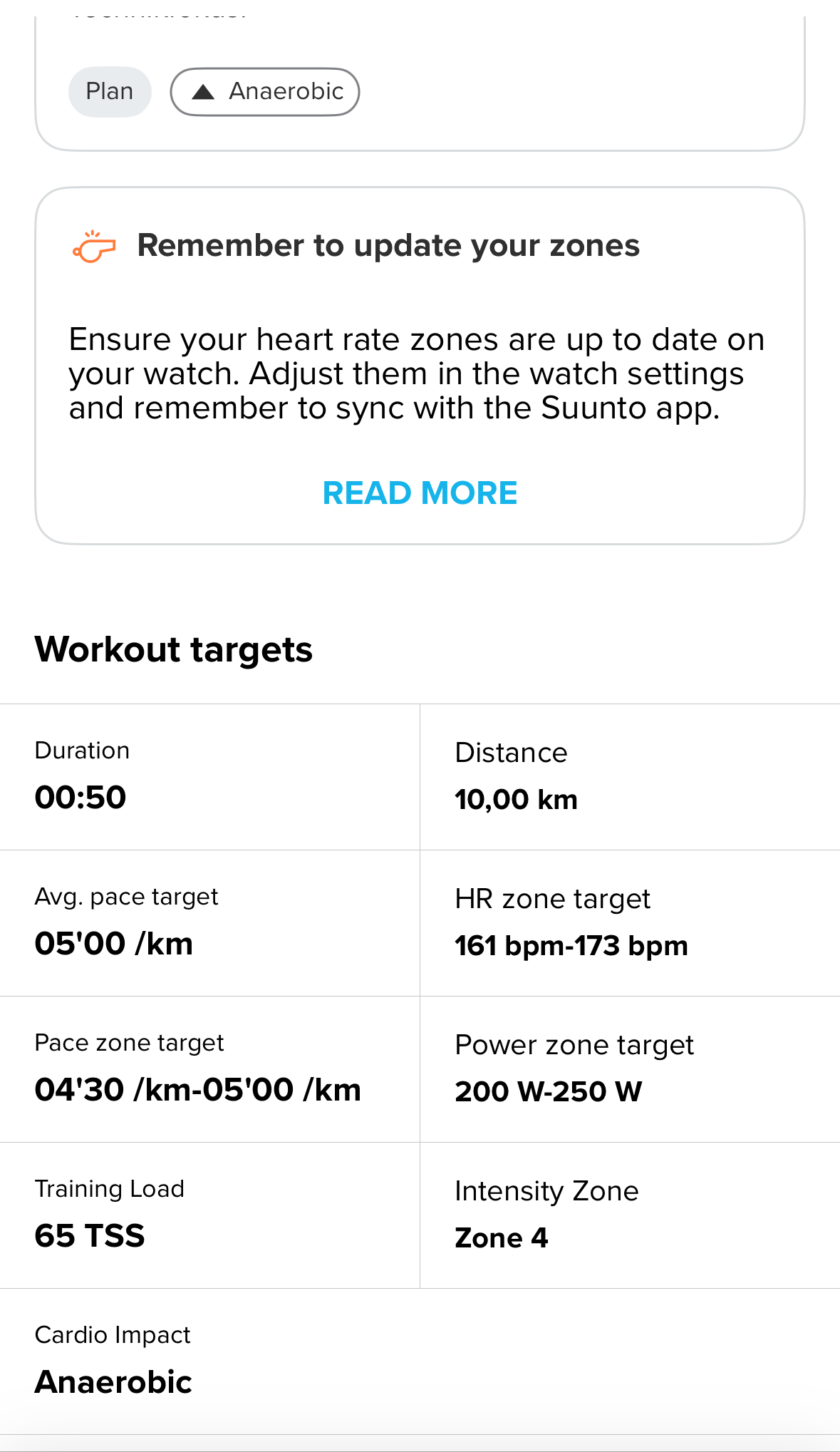

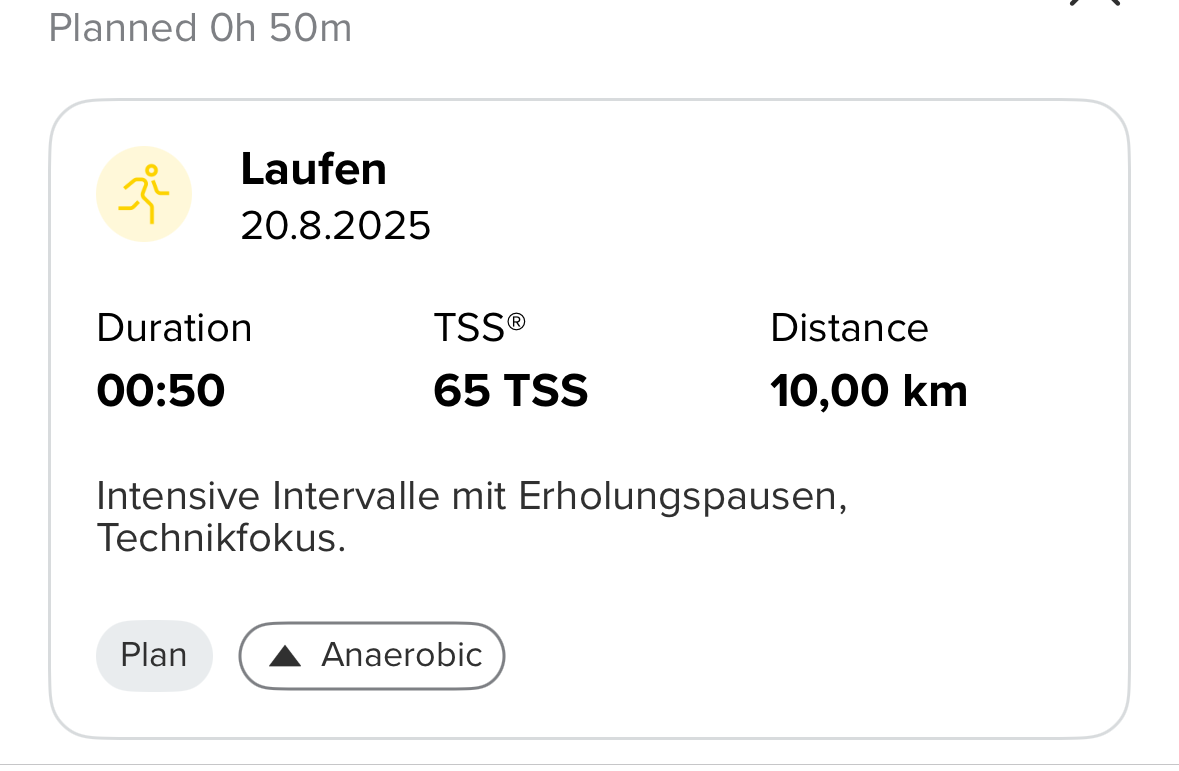

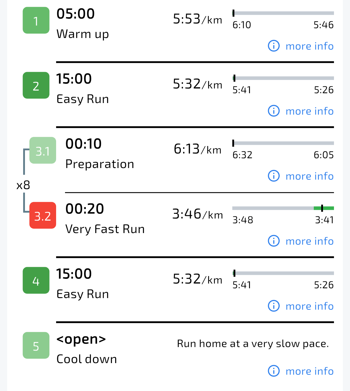

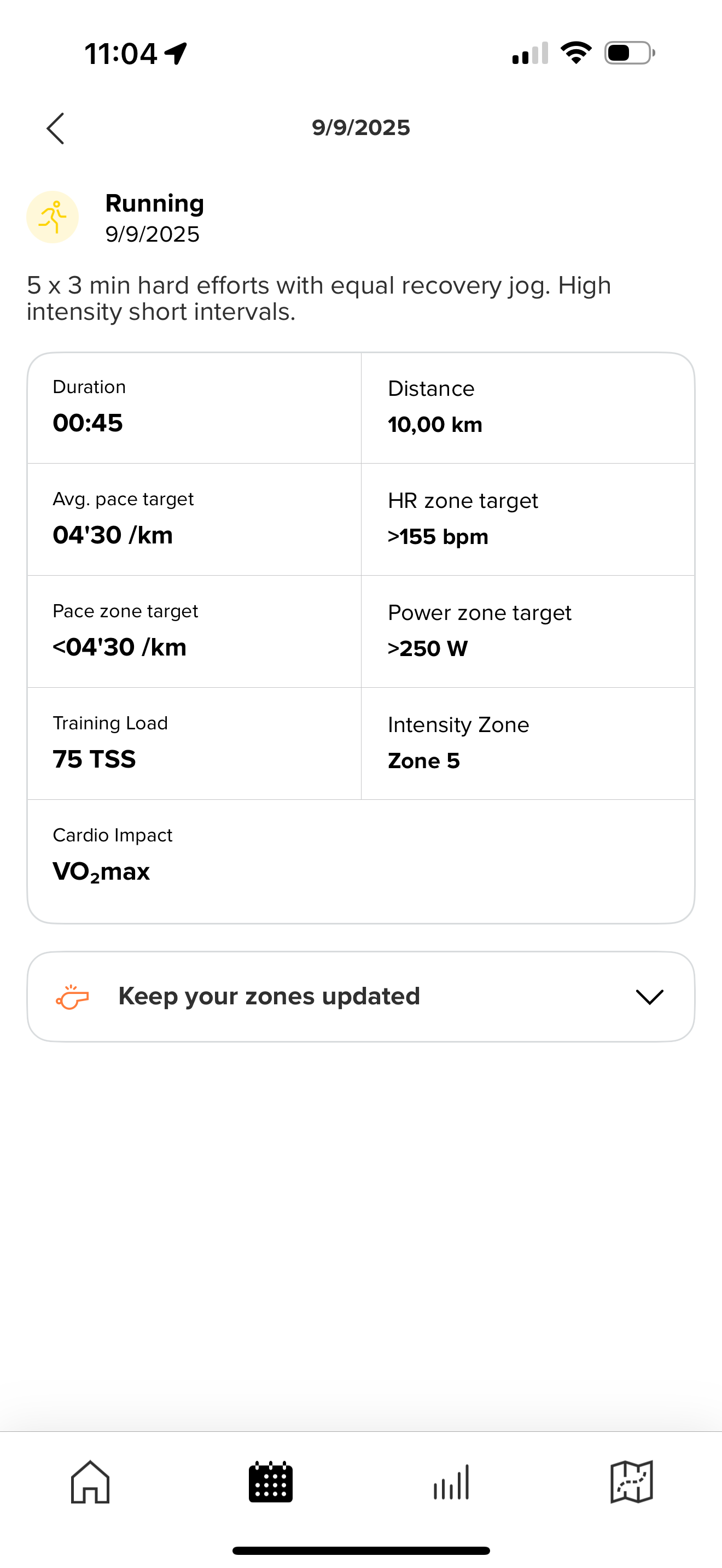

          I just tried with a “Get fast for 10km” and I checked some intervals-based workouts. The plan in SA gives a generic description of what to do, but in these cases I’d need to know more in advance.
          The workout description says “Perform 4x800m intervals at target race pace, with recovery in-between intervals”. But
          • I haven’t set up a target race pace anywhere; the pace zone target tile shows my best 10K effort as max pace
          • the Intensity zone tile shows Zone 4, but certainly I am not expected to stay in that zone for the entire workout?
          • I can’t see how long the recovery intervals should be, and I think I should know it in advance
          This is not for all workouts though, I found one that is more detailed.

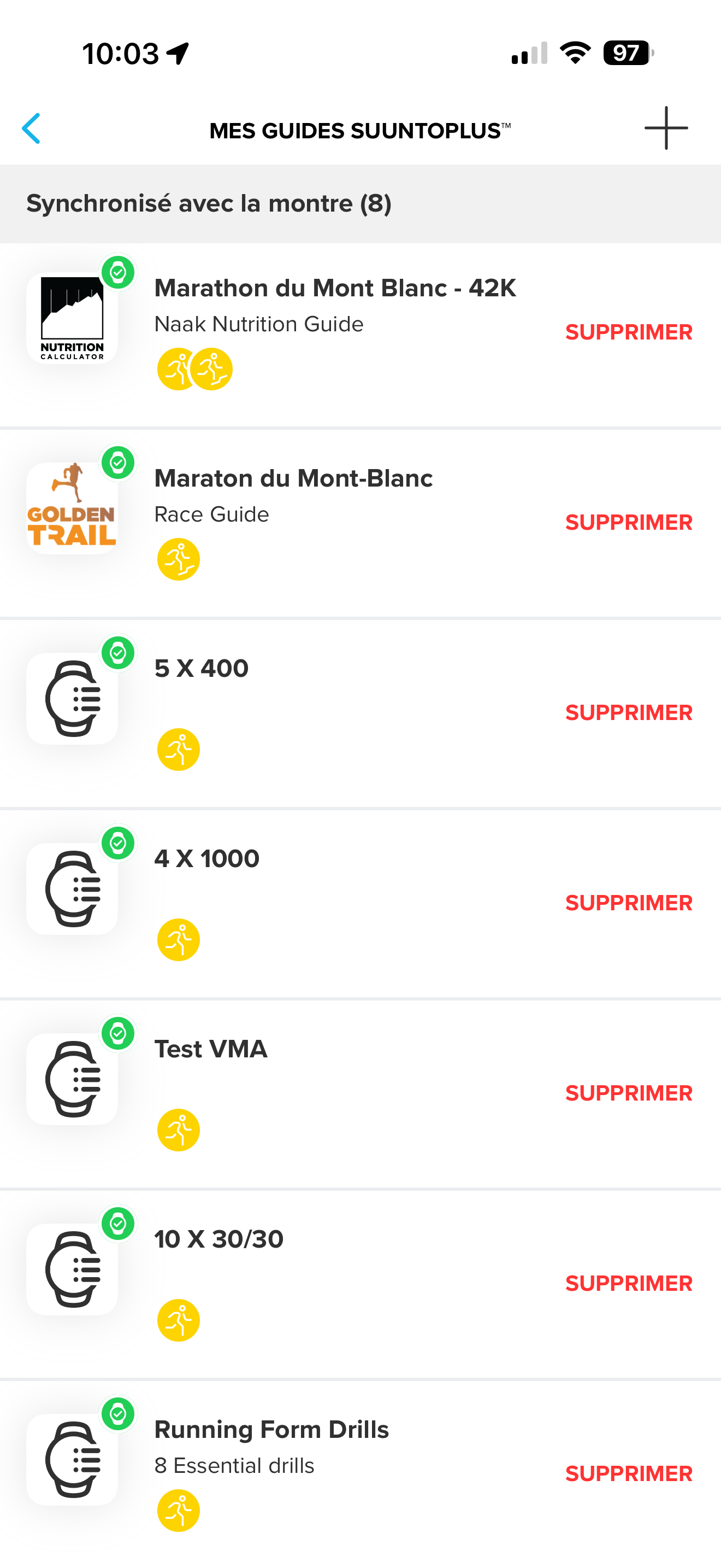

                          • herlasH Offline
                            herlas Silver Members @Francesco Pagano
                            @Francesco-Pagano Suunto Run is not working with these AI plans at this moment, as those are implemented via Suunto Guides, but it’s mentioned plans will come to Suunto Run, not sure how or when 😉

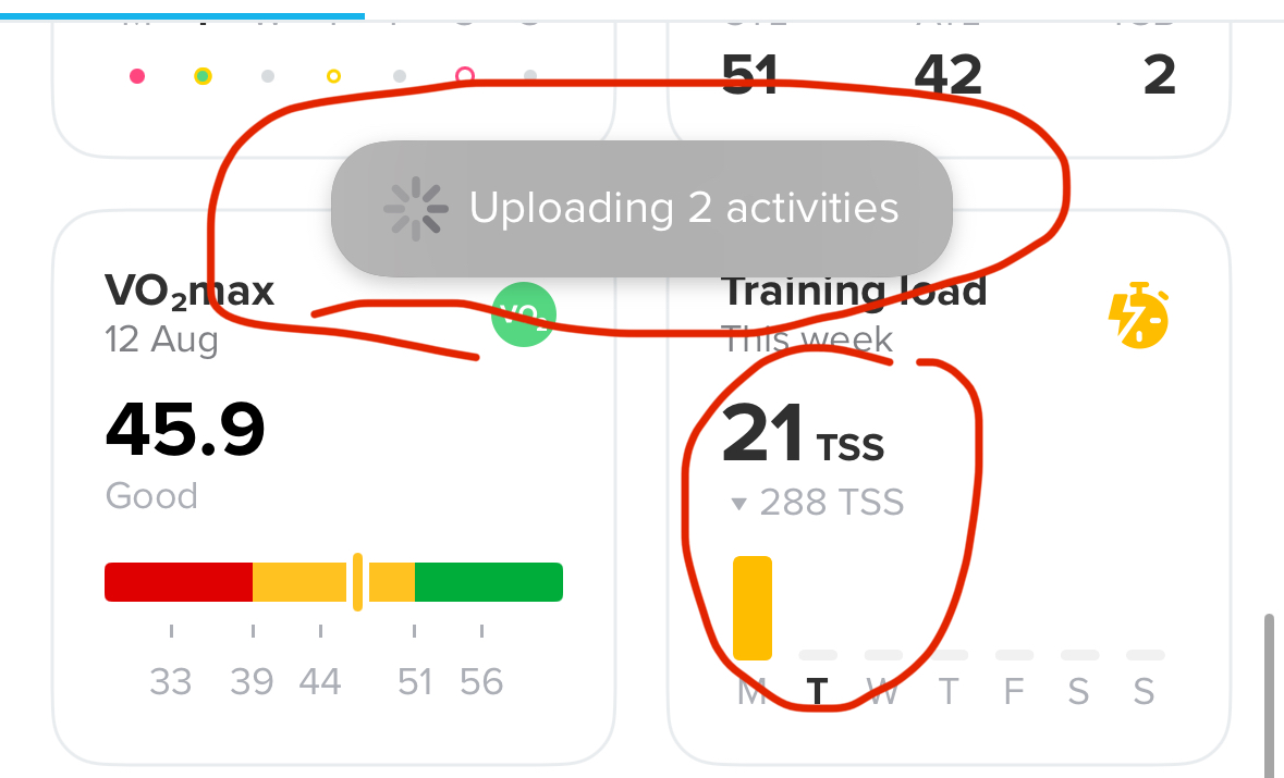

                                            I tried a workout from a plan today, not sure what happened. The workout is stuck on “Uploading activities“ for an hour now. On the watch there is a TSS measurement, the app didn’t register anything. Any idea what to do? Or is there an issue on the server side? There is more data missing, i.e intensity zones is also not updated.
