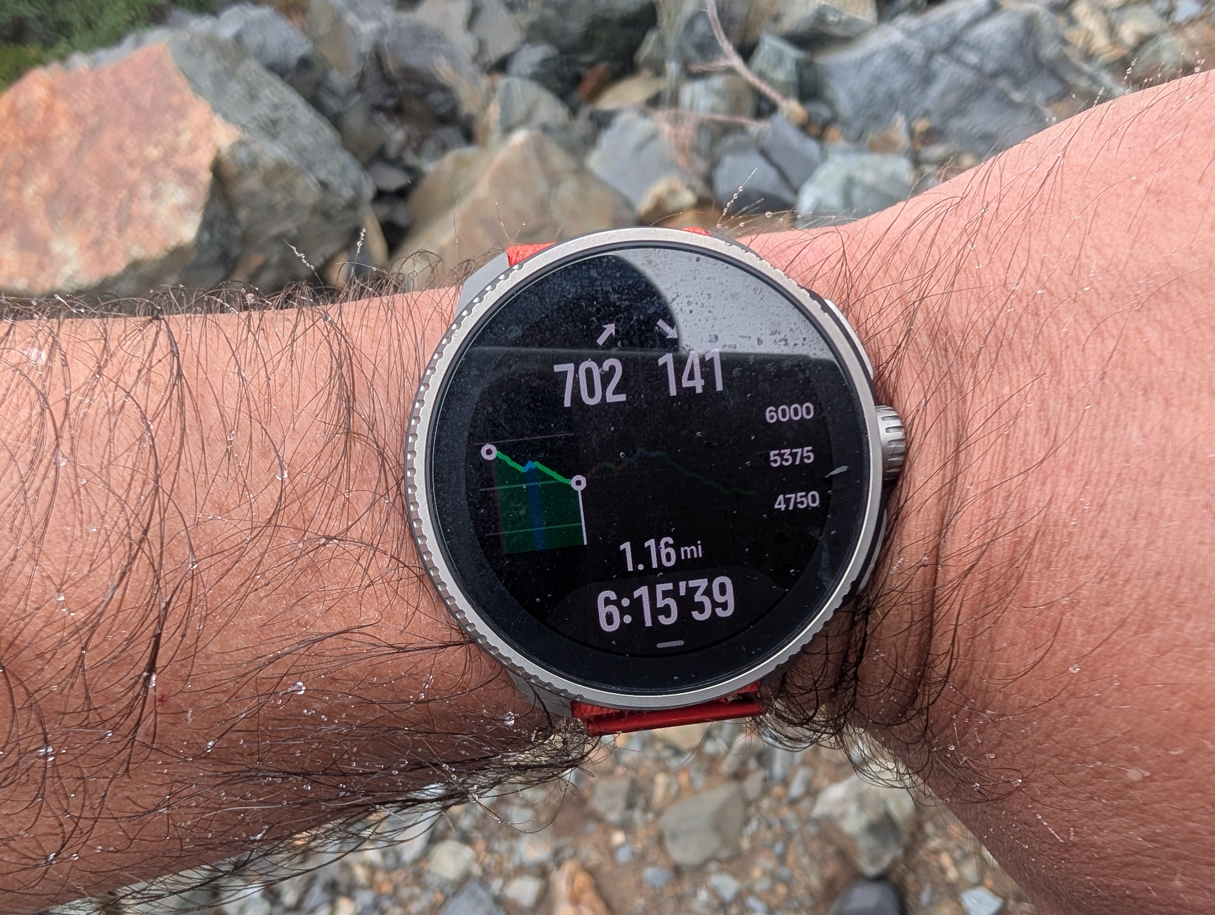

      The example of the zoom level #4 (the full profile) is shown in the photo below:
      At this point, you’d think it should be possible to zoom in twice - to zoom levels #2 and #1. Obviously, we cannot see three segments because there are only two remaining.
      However in reality, the watch allows me to zoom in only once to zoom level #1 - to see the part of the profile from the current point to the last waypoint and where the second from the end climb ends. But there is no way to see the profile from the current point to the end at a zoomed in fashion. Arguably, the entire remaining profile is already shown in the above view, which is zoom level #4. However, as you can see, the profile is really compressed and it is difficult to see any details. It seems the zooming logic is based on the number of remaining waypoints rather than profile “segments”, which I think is flawed because nobody is going to have a waypoint at the very end. Should we?
      Can this please be fixed? The zooming logic should work as if there was an additional waypoint at the very end of the route.

            1. Something is definitely off with the zooming in/out logic. What I’ve observed several times is that when I scroll the crown the elevation graph doesn’t change but asent and descent numbers change slightly. It behaves is if there were two waypoints very close to each other, but that isn’t the case.
            2. Climb guidance 2.0 becomes super confusing when the route is reversed. For example in the photo below I am actually climbing and the graph moves right to left. This isn’t an acceptable user experience by any means:
