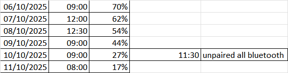

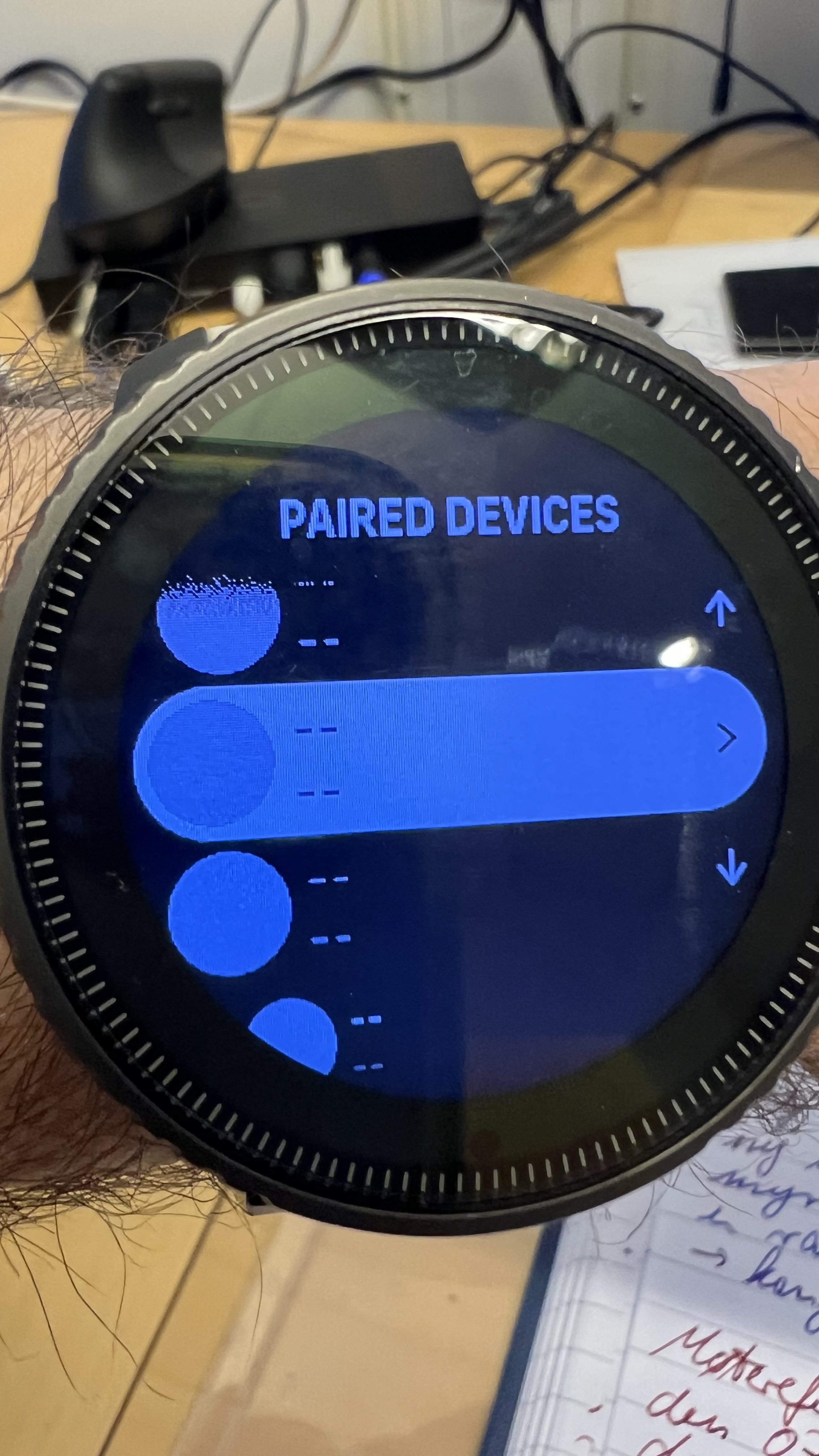

      After unpairing all Bluetooth devices from the watch, including the Suunto app itself (I also forgot the Suunto watch from my iPhone’s Bluetooth list), yesterday at 11:30 a.m. — this morning at 8:00 a.m. I was already down to 17%. So I lost another 10% (a bit more) in 24 hours. There’s clearly another issue that’s not related to Bluetooth.

        @fedequei Have you restarted your watch after unpairing all Bluetooth devices? (To make sure there is no more Bluetooth related process still running in background)
        Suunto Traverse
        • F Offline
          fedequei @sebchastang
          @sebchastang Yes, I did that at 14:00
