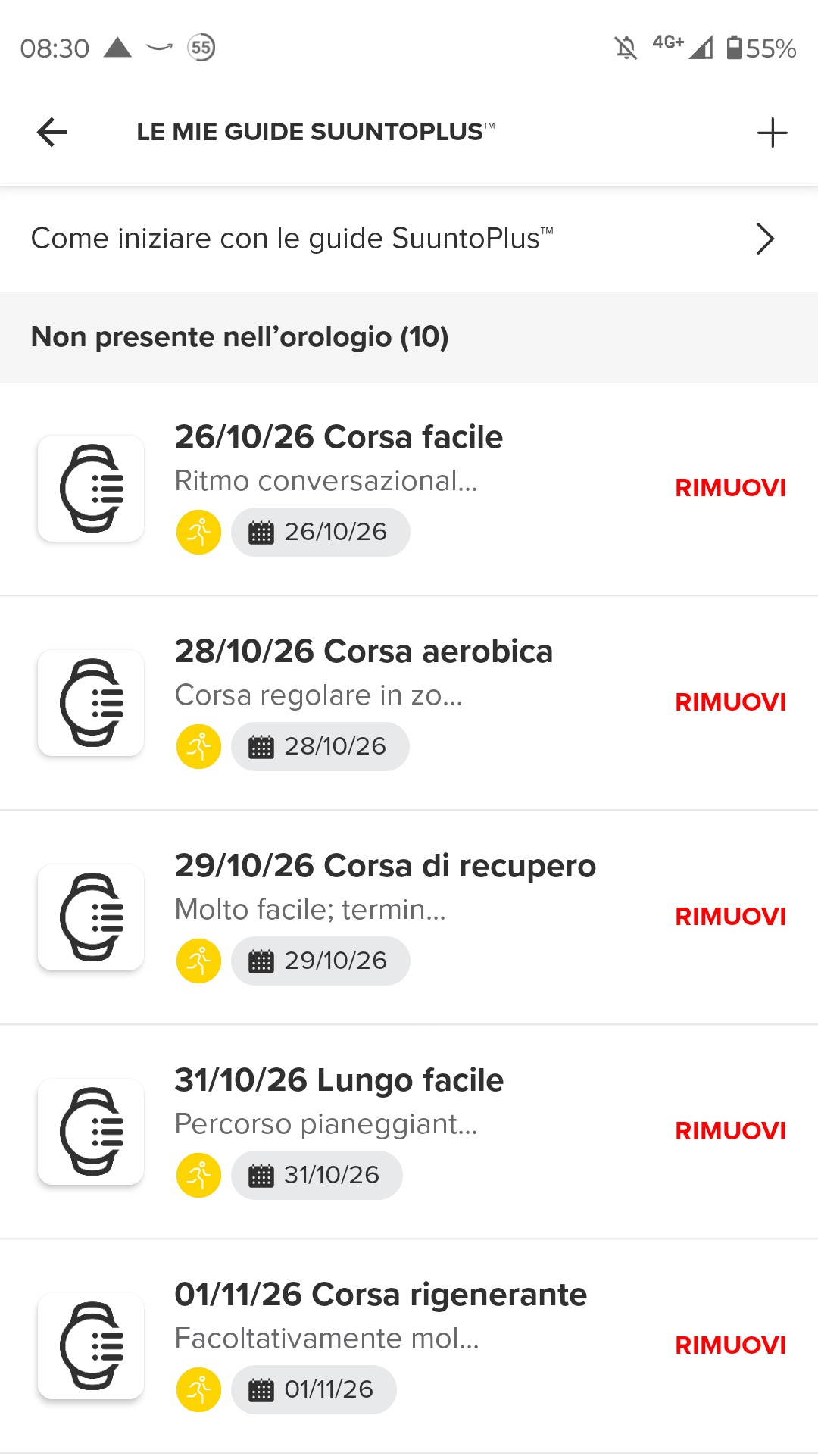

                    SergioB Silver Members @Dimitrios Kanellopoulos
                    @Dimitrios-Kanellopoulos to me it seems Suunto MyPlan Guides have some issues. When I try to create a plan, the App creates always all the guides for the first two weeks, but it is not able to sync them if they are a lot. And since that moment, the Guide syncing with the watch get stuck. Here below a test I’ve just made for a triathlon plan planned to start on Monday. I have 10 guides waiting to be synced (let alone that they are wrongly all running session, which is another topic. But MyPlan is still beta, so I can deal with it).
                    Suunto Race 1 and SuuntoApp (beta) on Android 16.
