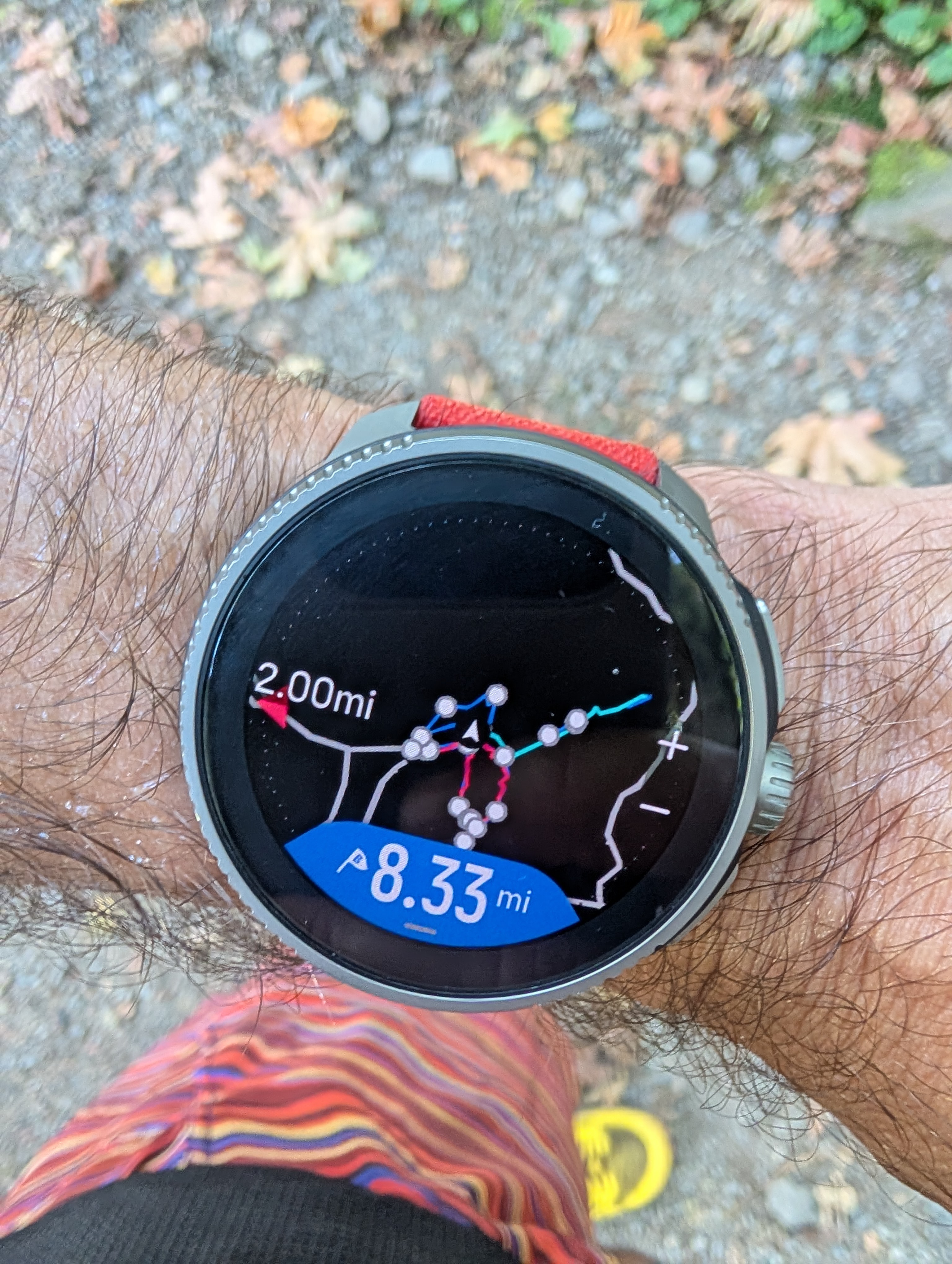

      @Mff73 said in I have zero confidence in Suunto route navigation!:
      What is strange in your case, is that your watch was showing correct remaining distance (8.3mi) but displaying wrong direction.
      I have an intuition of why it behaved that way. I think there are internal “checkpoints” periodically on a route. It would be too expensive to follow every single point in the route GPX file which can be every second if you imported a route, so likely the implementation puts a number of these checkpoints every so often along the route path. Then once you reach each of them it updates the light blue navigation arrow. I have also noticed that these navigation arrows may lag and not be updated often, and sometimes the current position may even be past the navigation arrow.
      What I think might have happened is that on that short segment #6 in my above example I passed a “checkpoint” from the second half of the route before passing a checkpoint from the first half, which is quite possible because that segment #6 is shared between two halves of the route. That made the navigation arrow follow the part of the route after that later “checkpoint”. I’ll try to reproduce that with a simpler short route near my home.

                duffman19
                This is 100% caused by the Auto Reverse “feature.” The watch is continuously trying to figure out whether you’re running the route forward or backwards, and guesses wrong about half the time. Suunto just needs to do away with this and give the user the option to follow a route either forward or backward.
                @sky-runner I run into this situation all the time as I often use routes while tracing trails to update OpenStreetMap. In doing so, I create routes that always double back on each other to get traces going both forward and backward to help counter any offset that may occur due to direction of travel. This leads to some pretty complicated routing. However, when I’m running to map, I’m also wearing a Garmin (usually a 955) with the same GPX route. The Garmin never screws up navigation since it’s always just following the route in one direction (and the turn notifications are much better).
                In this situation where I’m wearing two watches, I end up using the map on the Vertical for zooming in and out of the route as I find this much easier than the 955. And the 955 is used to confirm turns and direction of travel since it’s always correct.

                    duffman19 @sky-runner
                    @sky-runner I see what you mean and take your point from above about having certain “checkpoints” to cross. Even if there are checkpoints added in the background, wouldn’t that just be for the purpose of determining the direction of travel and therefore part of the auto reverse feature? Whatever it is exactly, it’s all just too complicated for its own good.
                    Like @Mff73 above, I’ve also tested following a route with two Suunto watches at the same time (Vertical and 9PP). At one point leading into a loop, the Vertical showed the correct way (left) while the 9PP showed the wrong way (right). Both watches somehow showed the same end-of-route distance, like in your original example above. How is this possible?
                    What I’ve observed is that the the auto reverse (and navigation in general) consists of three separate calculations that seem to occur independently of each other: the light blue direction-of-travel arrow on the map, the distance remaining (and ETAs and ETEs to waypoints, etc.), and an “off route” notification that occurs when a change in direction is detected.
                    It seems that the blue directional arrow is the most sensitive and will change within 50-100 meters after reversing directions. The distance remaining is much slower to adjust, sometimes taking up to 200 meters to correct after a change in direction. The notification (which I haven’t observed lately, so perhaps doesn’t happen anymore) occurs sometime between these two.
                    Now why wouldn’t all of these things happen at the same time when a reverse of direction is detected? I think this is just further evidence that the backend is just too complicated. This might also explain what you experienced, that you were somehow between these calculations where the arrow had “updated” incorrectly to showed the wrong way, but the distance remaining hadn’t recalculated yet and was still correct.

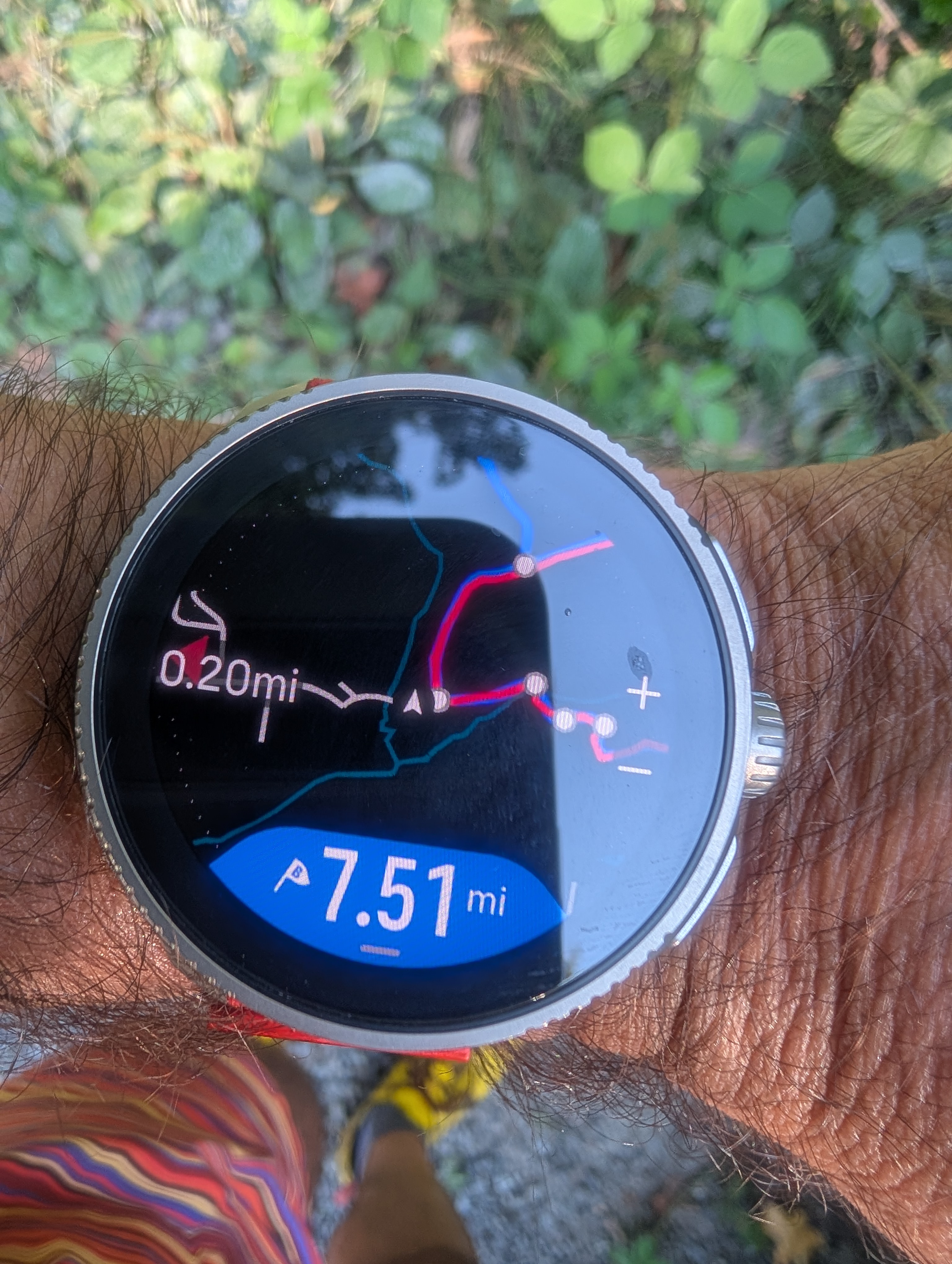

                      sky-runner Platinum Member @duffman19
                      @duffman19 said in I have zero confidence in Suunto route navigation!:
                      From looking at the map screenshot in my original post, I can confidently tell that the direction was not reversed. I can tell that because of a unintentional routing mistake on my part which resulted in the “out” part of the route where the light blue direction arrow is pointing to slightly diverge from the “back” part. According to the original direction, the “out” part is below on the screenshot and it is light blue. The “back” part is above on the screenshot and it is dark blue. Therefore the directional arrow is consistent with the original direction.
                        @sky-runner Ok, I think I see where you mean - that small section between the two dots (waypoints or turns)? So you think it just skipped ahead while you were somewhere on section 6? (Sorry, I’m trying to follow along.)
                        Perhaps in addition to the watch always trying to figure out which direction you’re traveling, it’s also always trying to figure out where you are along the route, rather than just assuming you are strictly moving from one point to the next. So maybe somewhere along section 6, it incorrectly guessed you were farther along in your route (since the paths cross at 6/7) and updated the directional arrow accordingly, but hadn’t yet updated the distance remaining since that lags behind. I’d bet if you had followed the light blue path, away from your car, the remaining distance would have also skipped ahead soon after. But since you followed the route as planned, it didn’t have time to adjust to this mistake.
                        Whatever is going on, you are correct that it’s screwy and inconsistent.

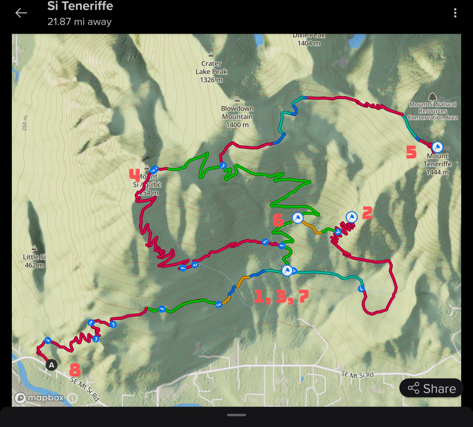

                          Yet another example of the watch, now Vertical 2, not following the route as planned. I plan complex routes not because I want to get from point A to point B but because I have a specific training goal in mind with specific distance and ascent, and with specific terrain for ascents and descents. That’s why it is not OK to randomly change what I have deliberately planned.
                          Here’s an example of the watch just skipping a part and jumping to a later part of the route - not OK at all. And if something like this happened in a race, that would make me disqualified.
                          The plan was to continue from point #1 to point #2, them circle back counterclockwise to point back to point #1 (marked as #3). The reason circling back there because that was the only reliable source of water. Then continue on the high route via #4 to number 5, them return via #6 to #7 (the same as #1 and #3) and refill water again.
                          During the run, at the junction after #1, the watch pointed me to the left, towards #4 and therefore skipping #2 and the entire small loop.
                          R Mff73M stromdiddilyS 3 Replies Last reply Reply Quote 2
                          • R Offline
                            runyx17 @sky-runner
                            @sky-runner This is exactly the type of route where navigation fails. When I have a route like this, I have to stop and restart the navigation several times during the workout to make it usable.
                            And one more thing. I don’t know why they can’t use simple logic here: for example, if I don’t pass point 2, don’t navigate me to point 4. Only do that if I continue towards point 4 for a longer distance—like 200 meters—or after a warning like “You missed points X and Y. Do you really want to skip ahead?”
                            Reading about these problems here makes me worry if it will ever be fixed at all.

                                    • stromdiddilyS Offline
                                      stromdiddily Gold Members @sky-runner
                                      @sky-runner that’s a heck of a route!
                                      Curious what zoom level you use while you’re navigating during the run and if you happened to look at the navigation while you were approach 1, 3, 7.
                                      I would certainly hope that while you were still moving towards the first way point, the blue arrowed line ahead of your exact current position correctly showed you the path to way point 2.
                                      Absolutely a problem if even while moving, prior to waypoint 1s first arrival, it was navigating you to 4 immediately
                                        sky-runner Platinum Member @runyx17
                                        I think the main problem is that Suunto navigation doesn’t simply guide you though a planned route. It continuously guesses where you want to go based on your current position. I think, internally there are invisible “checkpoints” along the route that you must pass for the watch to determine that you are on-route. Based on what the checkpoint that you passed last it draws the light blue arrows pointing you toward the next checkpoint. The reason I think it works this way is because these light blue arrows sometimes lag behind and then jump forward. In my example the route goes over itself twice for a short distance so there would be two checkpoints from different distances. When the watch sees the one from the later distance, it probably decides at that point that I have already skipped a part of the route, so it simply shows the light blue arrows based on where it thinks I am and not where I should be according to the planned route. This is a subtle but important difference. And because of that sometimes it randomly reverses the direction. There may be a momentary GPS glitch, and it readily accepts that, assuming that I started moving in the opposite direction.
                                        Also, Garmin handles routes where Suunto fails much better.
                                        I know exactly how Garmin navigation works because I helped them to fix a bug a few years ago where Garmin navigation would repeatedly go off route at sharp nearly 180 degree turns. The way I helped is that I kept hammering them with bug reports on their forum and produced simple and detailed repro steps. I was in communication with one of their reps and and eventually they had fixed it.
                                        Garmin has similar invisible “checkpoints” on route that I described above - perhaps every 30-50 meters or so. While you are on route you are expected to move towards the next checkpoint. Once you passed that - move to the next one, and so on. Garmin navigation makes sure you stick to the route as a sequence of these checkpoints in the exact order as planned. If course, if you intentionally skipped a part of the route it would tell you that you went off route. Then it would recapture you later on the route. But it doesn’t do that proactively and without letting the user know as Suunto does it.
                                        And this is exactly how Suunto should do that. Even if there is still an auto-reversal logic, you should do the best effort to stick to the original route, and only when that fails, show the notification, and only then after some distance of going off the original route, try to recapture it. That would give user a chance to correct themselves if they mistakenly went off route or cut a part of it, or reversed direction.
