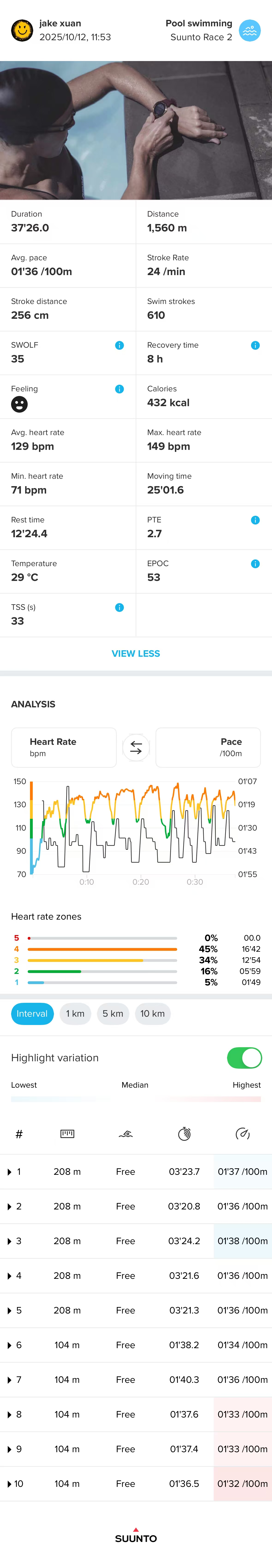

            And here’s what the data look like from suunto app after my pool swim yesterday.
            Sorry about the strange interval length coz the pool is 26m~
            I did 5x200m in 4’20"/set, and another 5x100m in 2’10"/set.
            To start AND complete the session by pressing the top right button, on top of that, i don’t have press any button during the whole session, but focus on the timing to push out on time. Normally i’ll keep the watch face at “interval list” so i will see how many intervals i’ve done and how long it took, simple it is~!c1bf1b3ee63e99929b35f06fb9c6977.jpg

              Yeah, your activity is exactly what I expected to see too. But, it is not… somehow the Run does not detect the pauses at the wall, nor breaks it down into intervals, or multiple segments like you have here. I see these sort of activities coming from the Race 2, Race S, etc, and since the Swimming specs of the Run match perfectly those of the Race S, I expected to see the same. I’m used to get metrics like these from the Garmins I have owned in the past - it’s always been easy to have pool swims broken down into intervals with those watches.
