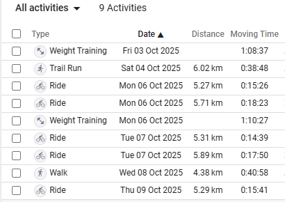

              6 days and 67% left. With these activities:
              I use airplane mode most of the time,two alarms per day, GPS activities are with best setting. 2h42m of GPS activities.
              B Marijus SiegelM 2 Replies Last reply Reply Quote 0

                  @brekke89 Default one and not fully start with gesture mode. Now the ride back from work, some running, tomorrow strength training and it will be exactly 1 week. I´ll post the battery tomorrow.
