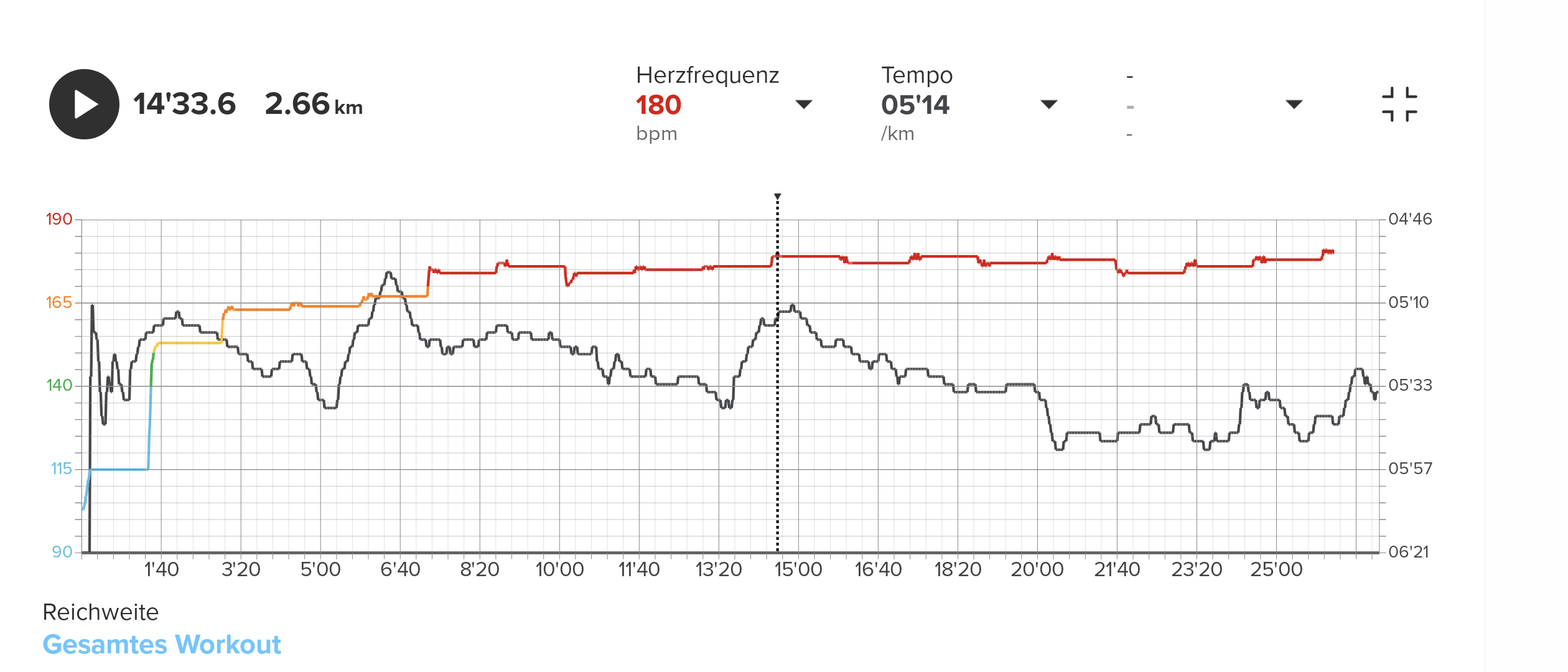

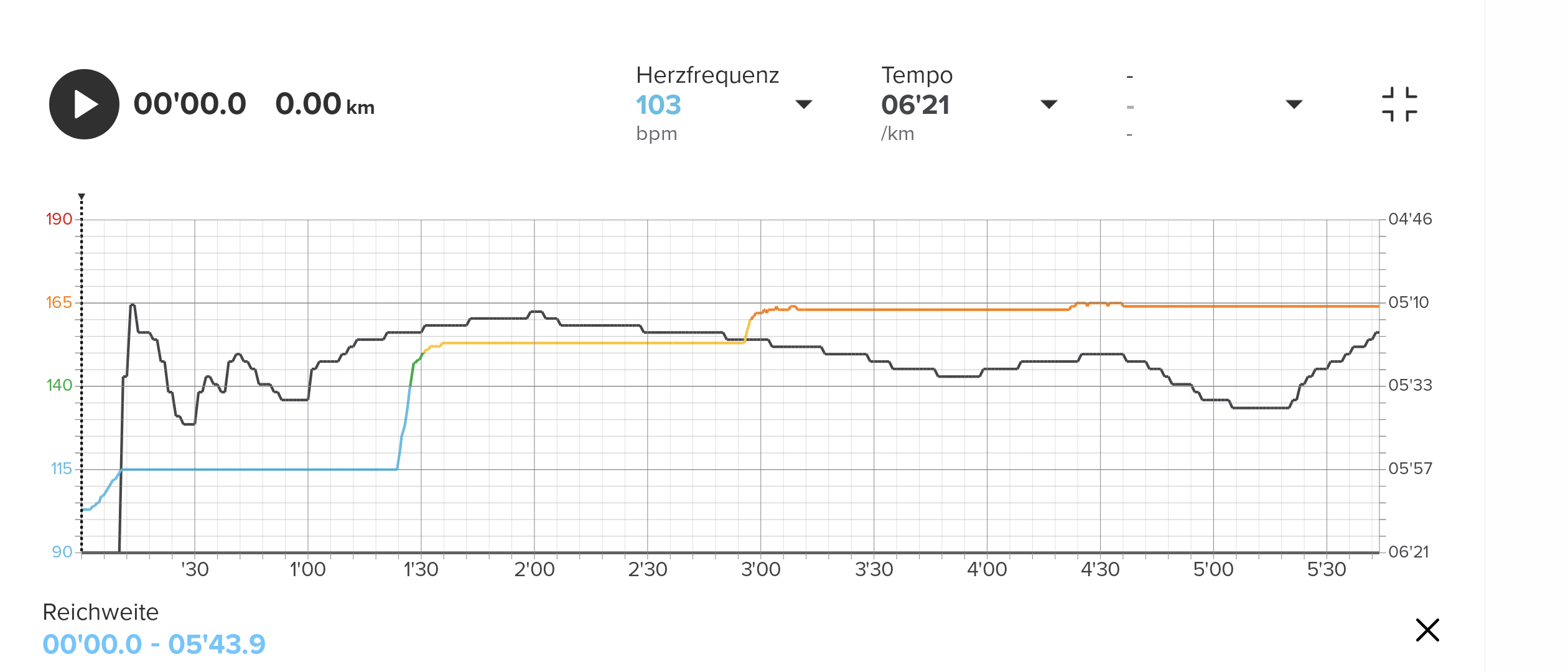

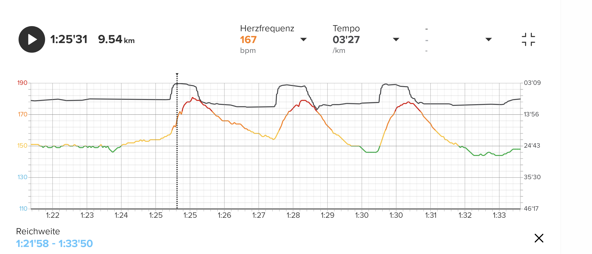

          @2b2bff but it seems it does. At least on the Suunto Run. I saved today’s run to report tomorrow.
          2 issues happened. Max heart rate much higher than registered on the HR chart and in the end I did a pause and the connection to the Suunto Chest Straps was lost when I restarted a few seconds later.
          The maximum HR registered by the chest strap was 154bpm but somehow on the Max HR in the intervals summary many values of 170bpm (these are wrong) appears. Also it can be seen that the HR chart doesn’t end. It was the pause. Unfortunately Suunto seems unable to solve this issue that affects all watches and makes all data contaminated by wrong measures or lack of them.

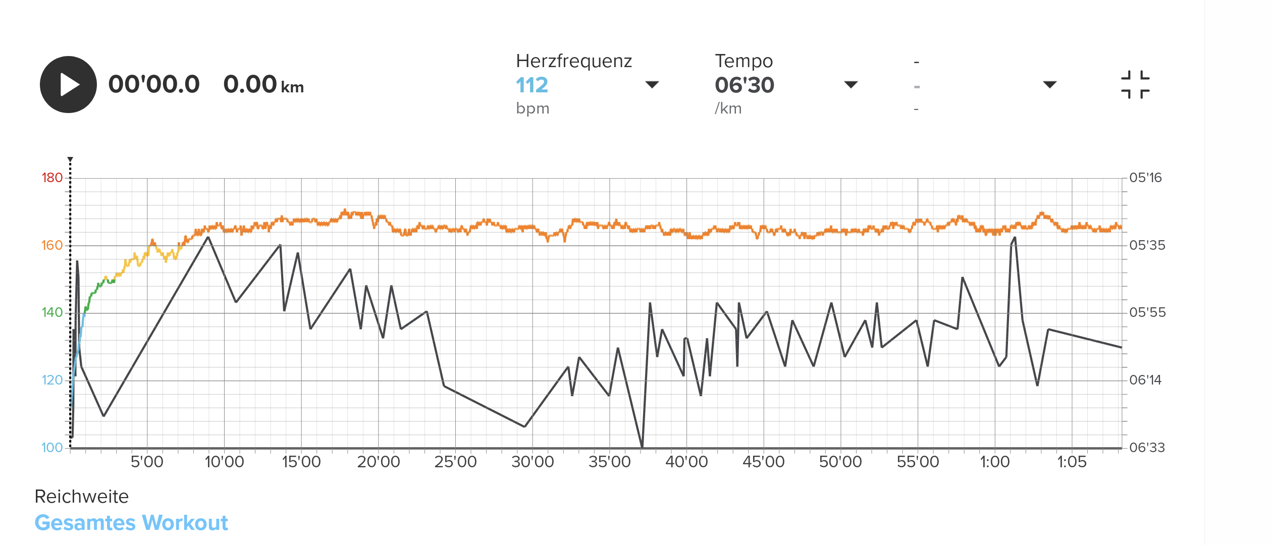

                        Same problem here, Suunto Smart Sensor connected to a Race 2. Worked flawlessly for seven months until last Sunday when suddenly the sensor connection dropped after starting the run. First idea was of course the battery, inserted a new one, problem remained. Chest strap is always washed after training, bought a new one anyway, problem remained.
                        I measured the resistance of the brand new strap and the older one; new one has approx. 1.38 kOhms (2x700 ohms), older one has 2.85 kOhms (2x1.43 kOhms), but up to now I heard that the straps should be good if they are below 8-10 kOhms.
                        Warm reset of the watch did not help, re-pairing the sensor did not help as well. I have no idea why that happens; the last firmware update of the Race 2 was beginning of April, and the watch performed without any hiccup afterwards.
                        I did a factory reset last night, will try again this evening whether that helped. Also bought a Polar H10 as backup solution… so that sensor problem cost me more than 100 EUR up to now (btw, 39 EUR for a replacement strap is much more expensive than Polar, they sell replacement straps for 25 EUR).
                        Suunto wants to sell the Race 2 as a training device for runners - training without a reliable HR detection is no option, though. I do not want to use OHR as well, it’s usually quite a few beats off if I am not just sitting at a desk.
                        Any other ideas except for “the suunto smart sensor is not exactly a piece of reliable engineering, actually is quite crap”?

                          Update - factory reset did not help as well, same behavior than before. Pairing the sensor was possible after three tries, starting the training also needed two tries until the sensor was detected. Then the heart rate was measured for some time until the connection dropped. Came back after some minutes, dropped again and so on. In the end, my 5k @ 5.34/km was rated a recovery run. Definitely had nothing to do with strap contacts being too dry (28°C… definitely enough sweat).
                          Interestingly, also the speed reading is quite “staggered”, this was not the case before the sensor problem occurred (the graph was much smoother).
                          I saw that speed sampling problem before, though:
                          And it used to be good for the first few months since I used the Suunto:
                          Since the strap is brand new, it’s either the sensor itself which does not transmit, or the watch is not able to handle the BT connection. Hard to find out, though, without having an alternative sensor.
                          Well, I’ll give the watch one more chance using another Sensor (Polar H10), if that also does not help, the watch will be presumably sold (with regret).
