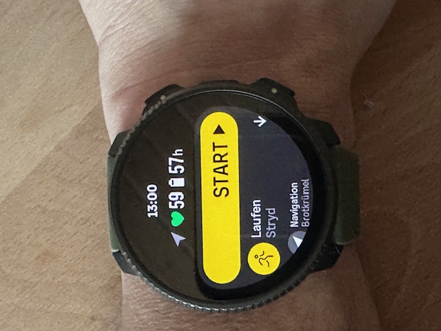

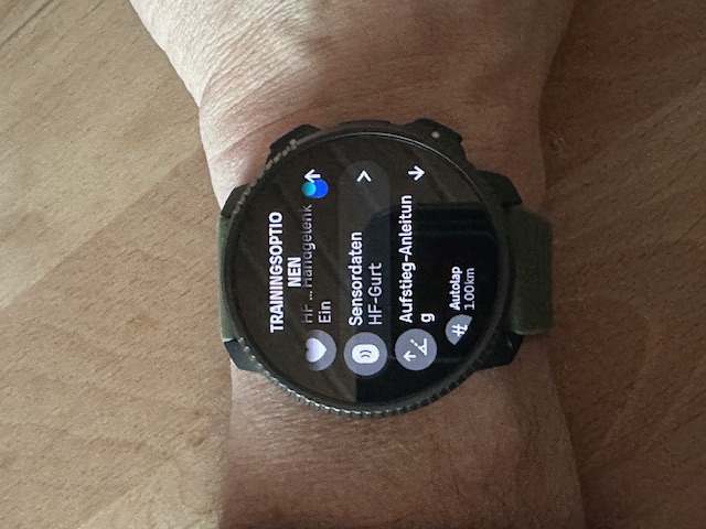

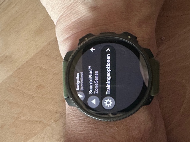

                SirMcKey Bronze Member @Tami999
                @Tami999
                Hello Tami999,
                had the same problem some days ago. Solved it in the following description (Sorry for the german screens). After choosing the chest-strab in the menu of the watch, it worked.
                • Tami999T Offline
                  Tami999 Silver Members @SirMcKey
                  @SirMcKey said in Suunto HR Chest Strap stopped work.:
                  @Tami999
                  Hello Tami999,
                  I got Chest Strap selected here already. 😞
