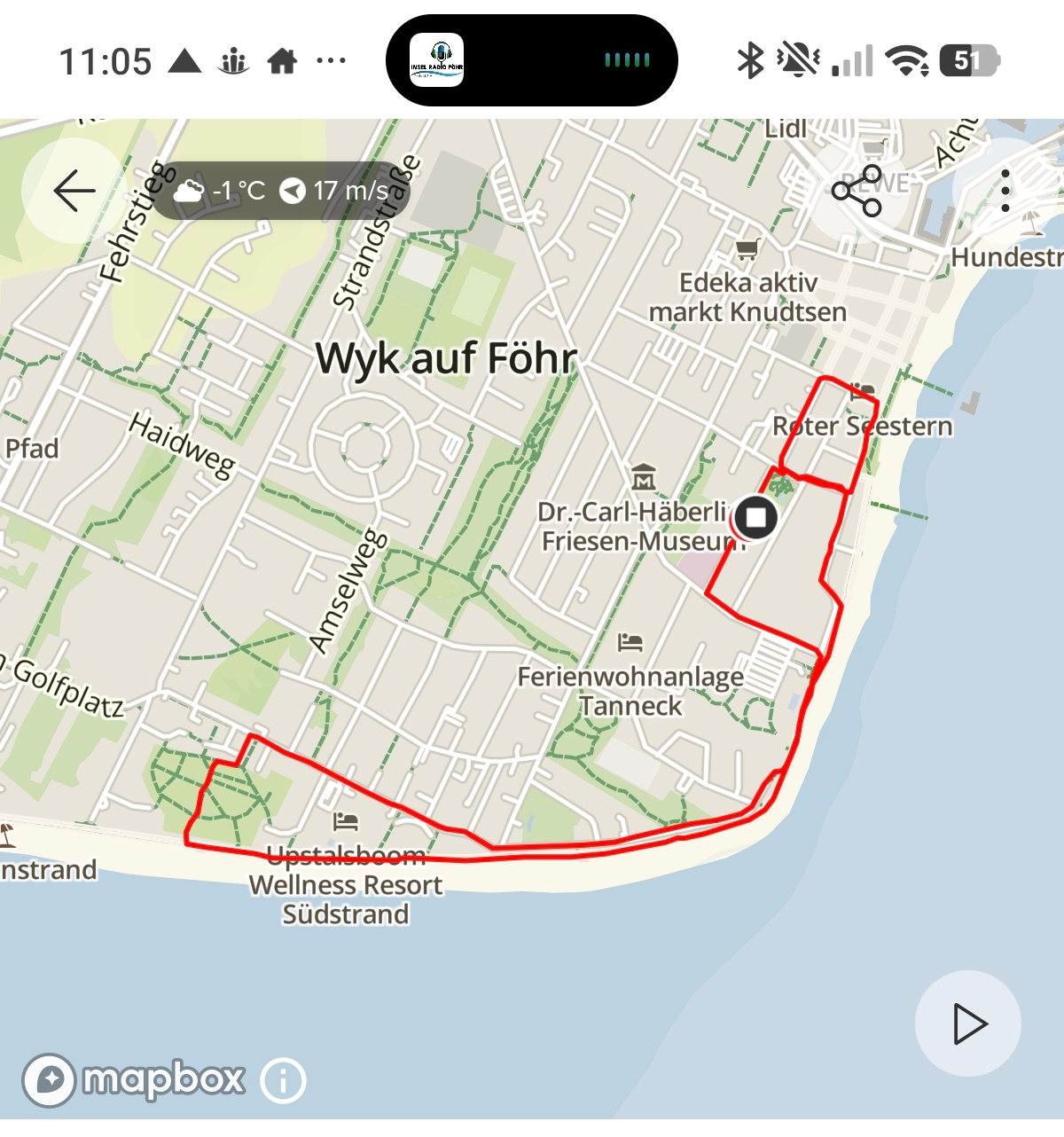

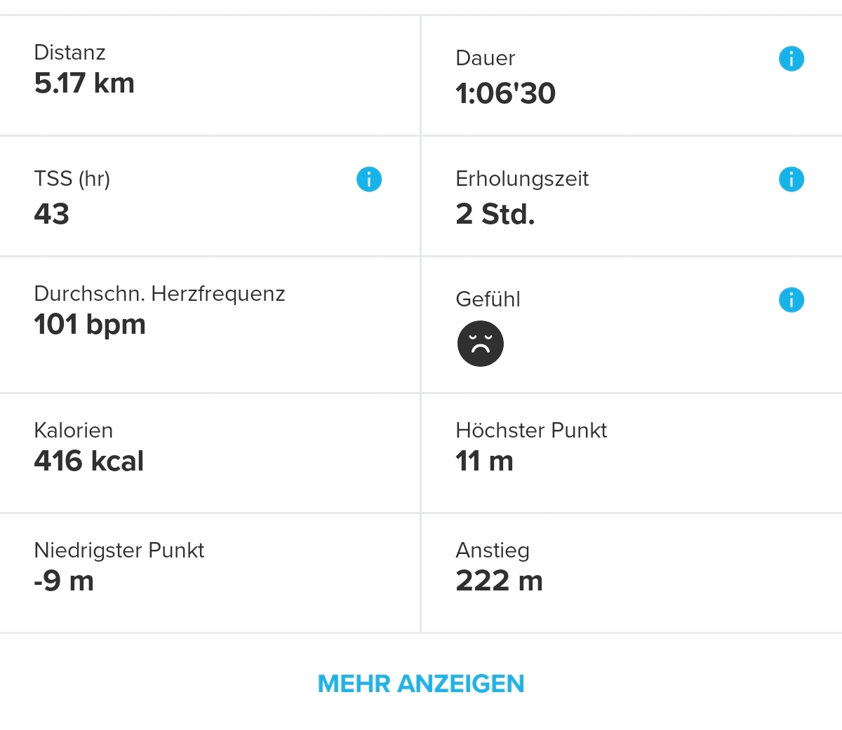

      Here is the Activity at sealevel. My watch counts 222m of positive Elevation…
      ![Bild Text](Bild Link1000134872.jpg 1000134871.jpg 1000134869.jpg )

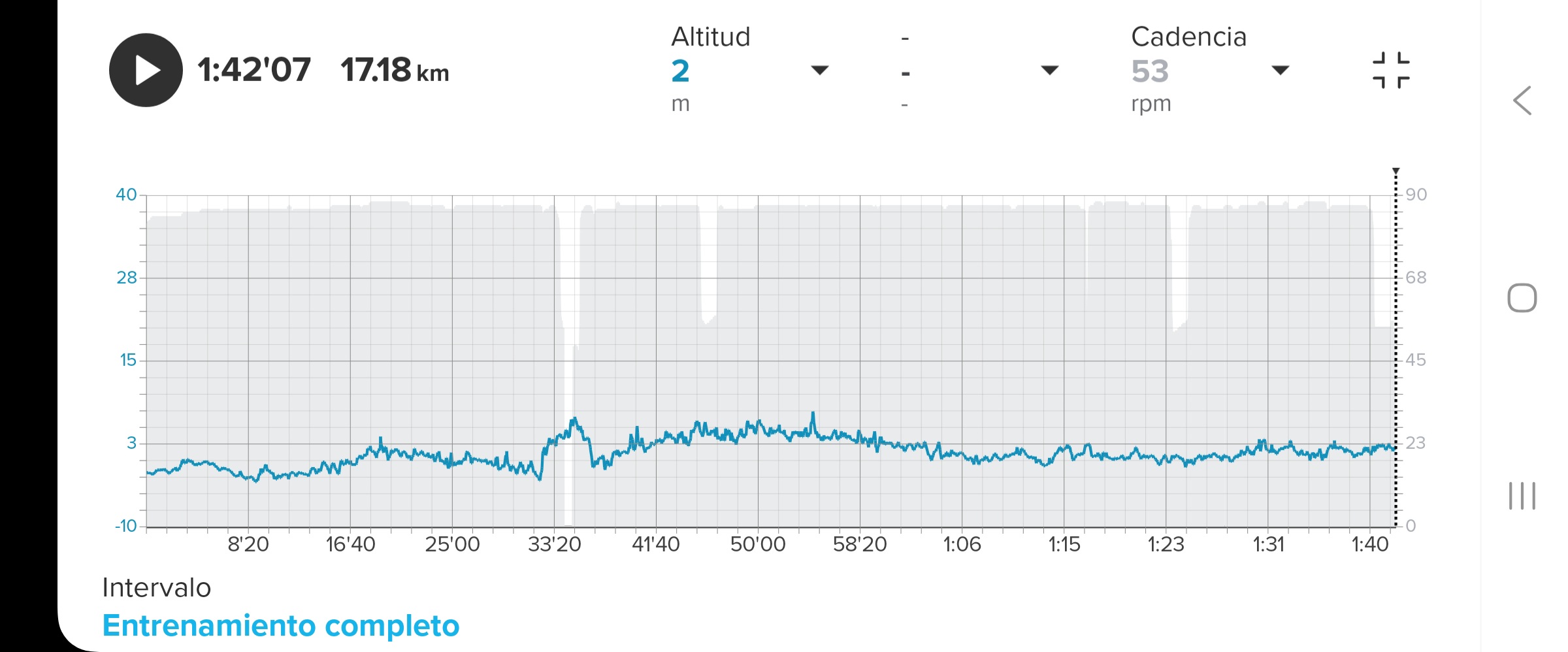

        I did an almost similar round of running before and after the firmware update of my SV1.
        The route is totally flat except for one tunnel. This explains the small dips in the altitude graph.
        Before the firmware update: ascent 0m, descent 0m
        After the firmware update: ascent: 4m, descent 19m
        I live 1m below sea level which was nicely recorded before the firmware update. After the firmware I ended the run with -18m

          BastMaSVSRS9PP Bronze Member @GiPFELKiND
          @GiPFELKiND is this maybe the cumulative ascent? Looks reasonable if you add all the „ups“ ? Don’t know just wondering
          SR, SVti (Mammut Edition), SR2, Suunto Wing
          GiPFELKiNDG 2 Replies Last reply Reply Quote 0
            GiPFELKiND Silver Members @BastMaSVSRS9PP
            @BastMaSVSRS9PP 222m of positive Elevation while Walking at sealevel?! No never ever. Never had this before. There arent Hills…
              @BastMaSVSRS9PP there was No Up… 🫣

                  • surfboomerangS Offline
                    surfboomerang @sky-runner
                    @sky-runner the watch is cleaned after every activity and the baro sensor looks clean.
                    Wind could be a factor, but I checked a bit further back in history and the last 10 runs before the firmware all show a relative flat line like in the first graph.

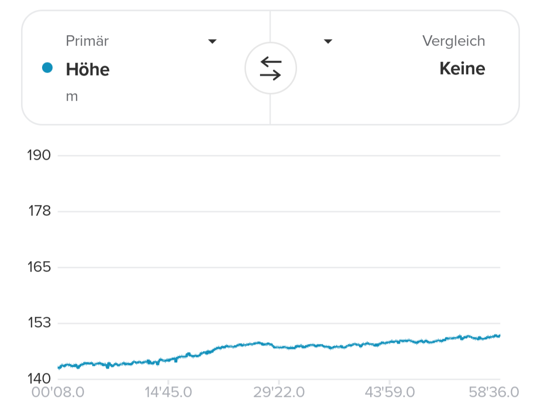

                      As @Dimitrios-Kanellopoulos suggested in https://forum.suunto.com/post/183086 i wanted to with additional data (however i am using a race 2 not a vertical 2):
                      I ran a flat route (track training) - to give you an impression:
                      With the latest firmware the watch tracked 16m ascent / 0m descent, see picture and .fit file:
                      Running_2026-01-08T17_37_59.fit

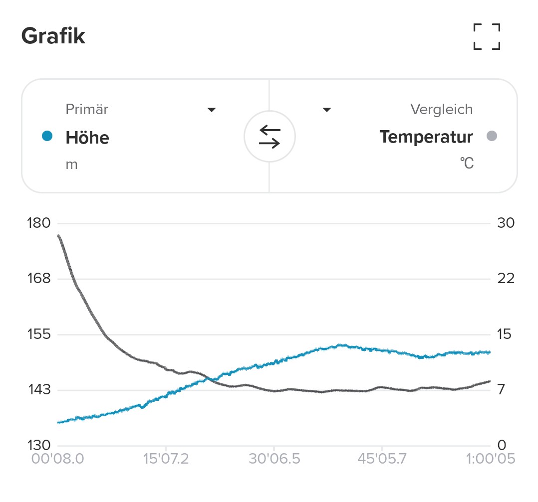

                      This corresponds with the latest firmware 2.50.26 (altitude and temperature):
                      For your reference the former firmware was working fine:
                      Running_2025-12-18T17_41_36.fit
                      This corresponds with the former firmware 2.48.16 (altitude and temperature):
                      I couldn’t upload the json files for some reason, please note that i will return to the track on thursday (and most likely every other thursday) so just let me know if there is a setting that i should try and if you need additional infos/data.

                        Dimitrios Kanellopoulos Community Manager @MatthiasKlug
                        @GiPFELKiND you barometer had noise and ups and downs. So this is not due to the update fyi. WE analyzed the data.
                        About the other one activity I see fused alti kicking in and that created the ascent. Lets see how this goes need more info
                        MatthiasKlugM GiPFELKiNDG 3 Replies Last reply Reply Quote 4

                            GiPFELKiND Silver Members @Dimitrios Kanellopoulos
                            @Dimitrios-Kanellopoulos thank you for your information.
                              @Dimitrios-Kanellopoulos said in getting too much ascent / descent on flat routes:
                              What can i do now? Where the noise is come from? My Sensor is Clean. Thank you for your informations about this 🙏🏼
                              Dimitrios KanellopoulosD runomaticR SportsfreundS 3 Replies Last reply Reply Quote -1
                                Dimitrios Kanellopoulos Community Manager @GiPFELKiND
                                @GiPFELKiND nothing. It could be one off or just some water before. If it persists then pm me.

                                  • runomaticR Offline
                                    runomatic Silver Members @GiPFELKiND
                                    @GiPFELKiND I’ve always had this happen (with both SUUNTO and Garmin watches) when I run along the beach on a North Sea island. It varies depending on the wind and weather. The stronger the wind, the greater the altitude. The barometer seems to get a bit confused.

                                      (edit: my first thought was that this behaviour is somehow temperature related (the bigger the temperature drop the higher the ascent) i just wanted to mention this, we will see if the outer temps get warmer and closer to the changing room, so there is less temperature drop)

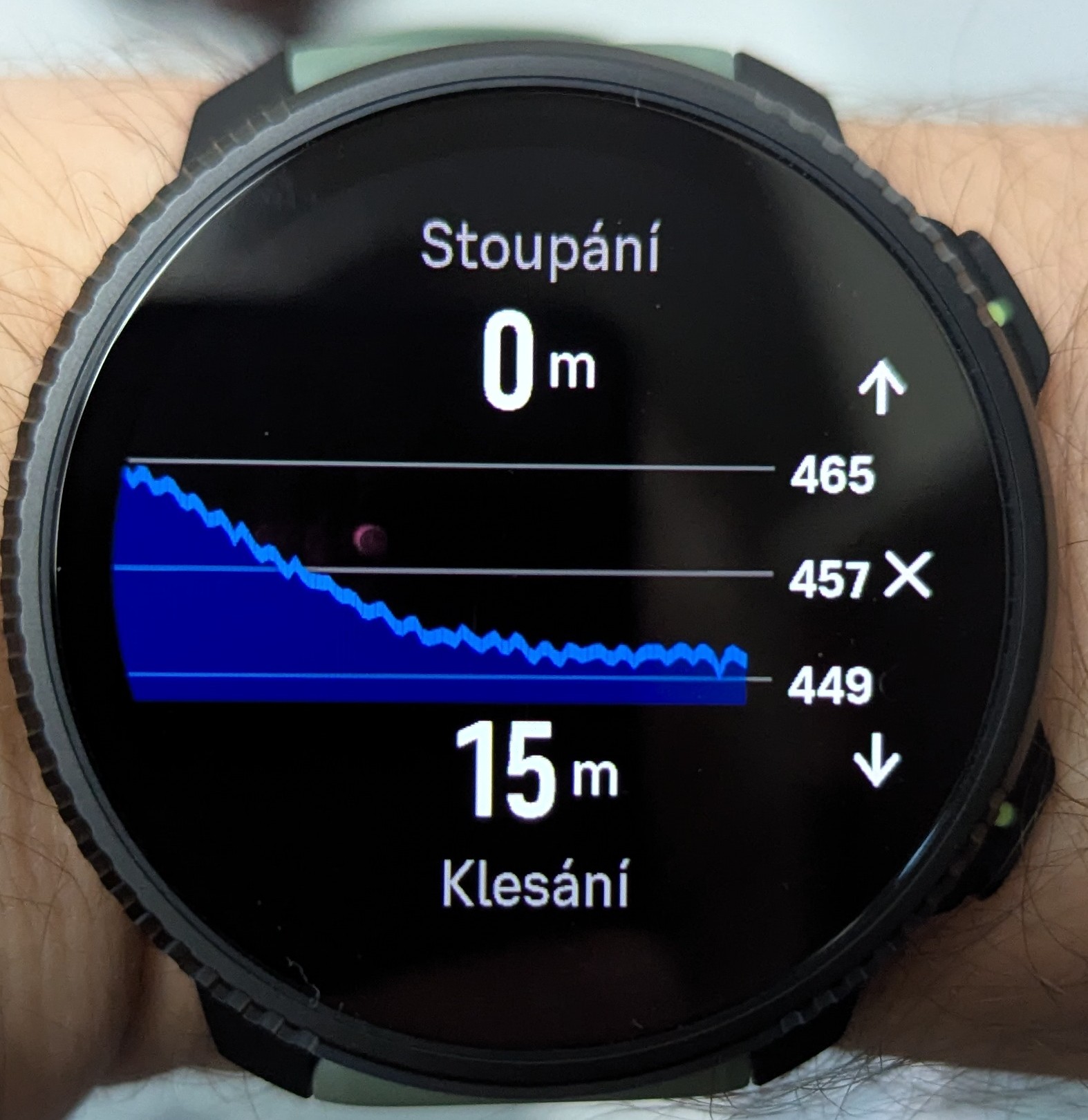

                                      • HonzaSH Offline
                                        HonzaS
                                        Just returned from first run after few months. I tried 5km track run activity on 200m oval 2nd lane, so 208m but that that’s not important. I got 15m descent even on flat track. Don’t know, if it was better before 2.50.26 FW, but according to charts, it seems temperature correlated. At home, I put the watch on jacket sleeve, so the watch temperature was gradually decreasing outside, but not to ambient temperature, which was about 1°C. And the elevation chart curve seems to copy the temperature chart.
