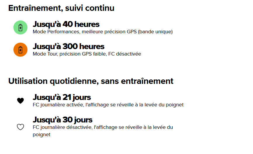

                                And even if it wasn’t a copy/paste situation, the 9 peak pro is an actively sold smartwatch, bug fix should be expected, people are literally buying this watch right now from Suunto and being said that “your 2 days old watch has an identified bug, corrected in other watches, that won’t be fixed on your watch, sorry”, that’s BS.
                                I’m a vocal advocate to “no more updates”, I said it many times in this forum, i never expected new features on a watch, what I buy, what I’m being advertised is what I expect to get, but bugfix, especially as trivial as this one, is what I expect.
                                And while we’re at it, people a buying right now a watch advertised as a 21 days battery life :
                                Who ever gets 40h of GPS or 21 days of smartwatch battery on a 9PP? that banner is a lie since 2024
                                  The 40h of GPS activity in Performance mode is still pretty accurate. My experience puts it maybe closer to 36-38h. But, yes, 21 days of day-to-day battery life was only possible upon release, before the firmware switched to full 24/7 HR monitoring.
                                  I agree that the responsible thing to do would be to update specs when software updates create significant changes. And the time to do that would have been 3+ years ago now. At this point, Suunto is clearly just selling out inventory of the 9PP. I’d be surprised if it’s even still available in a month or two. So there’s no way they’re putting any effort or money into this thing now, right or wrong as that may be.
                                  Not giving Suunto a pass here, but I can’t think of another scenario where a tech company actually did update the spec sheet for a product after its initial release to reflect software updates. Maybe there’s protocol for these things, or perhaps there’s some sort of consumer rights argument to be made.
                                    40 hours of GPS? I do. As of smartwatch use - I don’t know as I use it for workouts too but I don’t have any problems with battery drainage.
                                    Would I like the Suunto to fix the bug? Sure. But I also understand why they won’t. That’s why I believe a good solution for older devices would be to open source the firmware. But this may not happen because of proprietary technologies inside the firmware that Suunto may not want to go public.

                                      @Łukasz-Szmigiel I tried to maximize the battery life during a multi day bike trip, and switched to “endurance” mode while disabling all smartwatches features, roughly 30hours of battery life.
                                      And smartwatch use, considering that, without any notifications or sport activity, I loose about 10% per day…so that’s 10 days max

                                        Oh yes there is a protocol, its called “lets run our automated battery benchmark tool tool one more time, and edit a web page”
                                        I don’t mind honestly, the 24/7 monitoring is great, but leaving it as “21 days”, since 2 years+, is just bad, and its not like we can revert to the old “every 5 minute monitoring”
                                          Sounds like you may have a defective unit.
