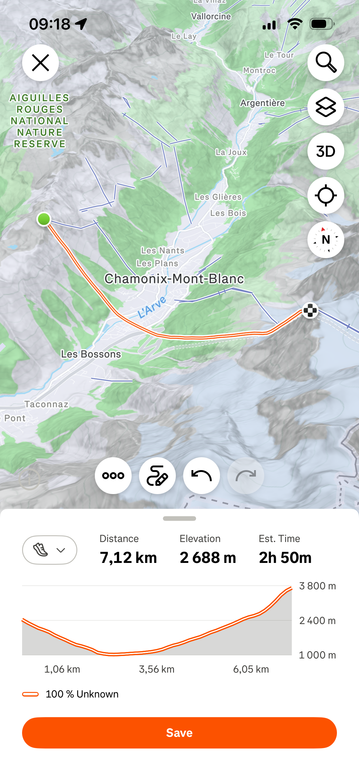

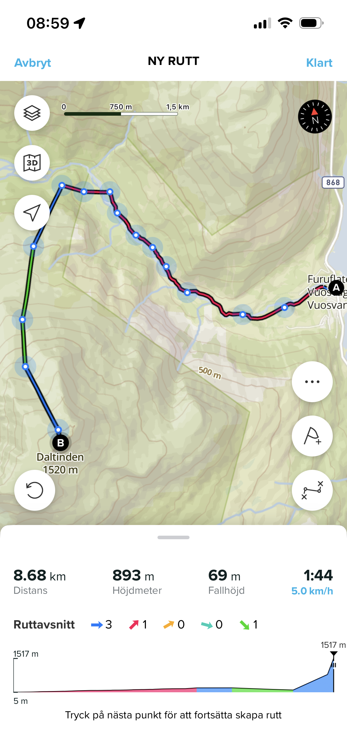

      Hi,
      I have issue with the quality of the elevation profile in routes created in Suunto App (and Route planner). When using Suunto App, I use iOS.
      The most obvious situation to observe the issue is when creating a manual route without following any roads or trails. The elevation profile is completely off and unusable.

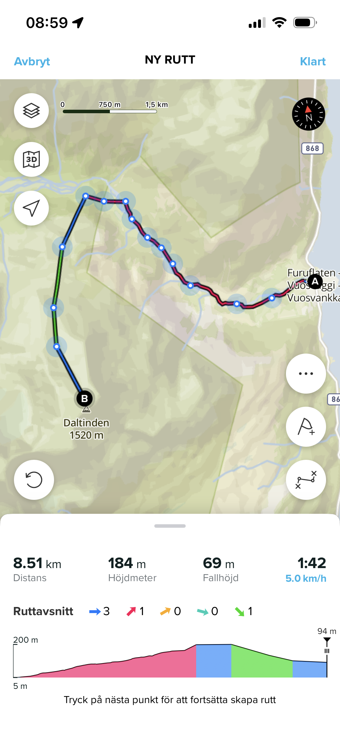

      Attached is a few examples where I created snippets of a route in Suunto App and in Strava. First I thought it might be due to regional bad quality of the underlying map data. But the error is consistent both in northen Norway, mid of Sweden and in the region of Chamonix (France).
      The strange thing is that if I exit the route creator mode of SA and long press anywhere on the map, so that I get info regarding the coordinates of the point I pressed, it gives me correct elevation. So there seem to be a difference between the map data and the elevation for each point in a created route.
      Also, when creating a manual route (without following a trail), SA only looks at the delta between point to point. When creating same thing in Strava, it seems to iterate the elevation all along the line between point to point. This becomes painfully obvious if you create a manual route from one peak to another peak. Elevation profile in Suunto App is just a straight line between the elevation of peak 1 to peak 2, and Strava gives you a much more correct profile, showing the valley between the peaks.
      I love creating routes in SA an actually hate Strava interface, but when it come to elevation profile, SA is unusable for me. I’m surprised that nobody else seems to have this isAt least from what I see in this forum?

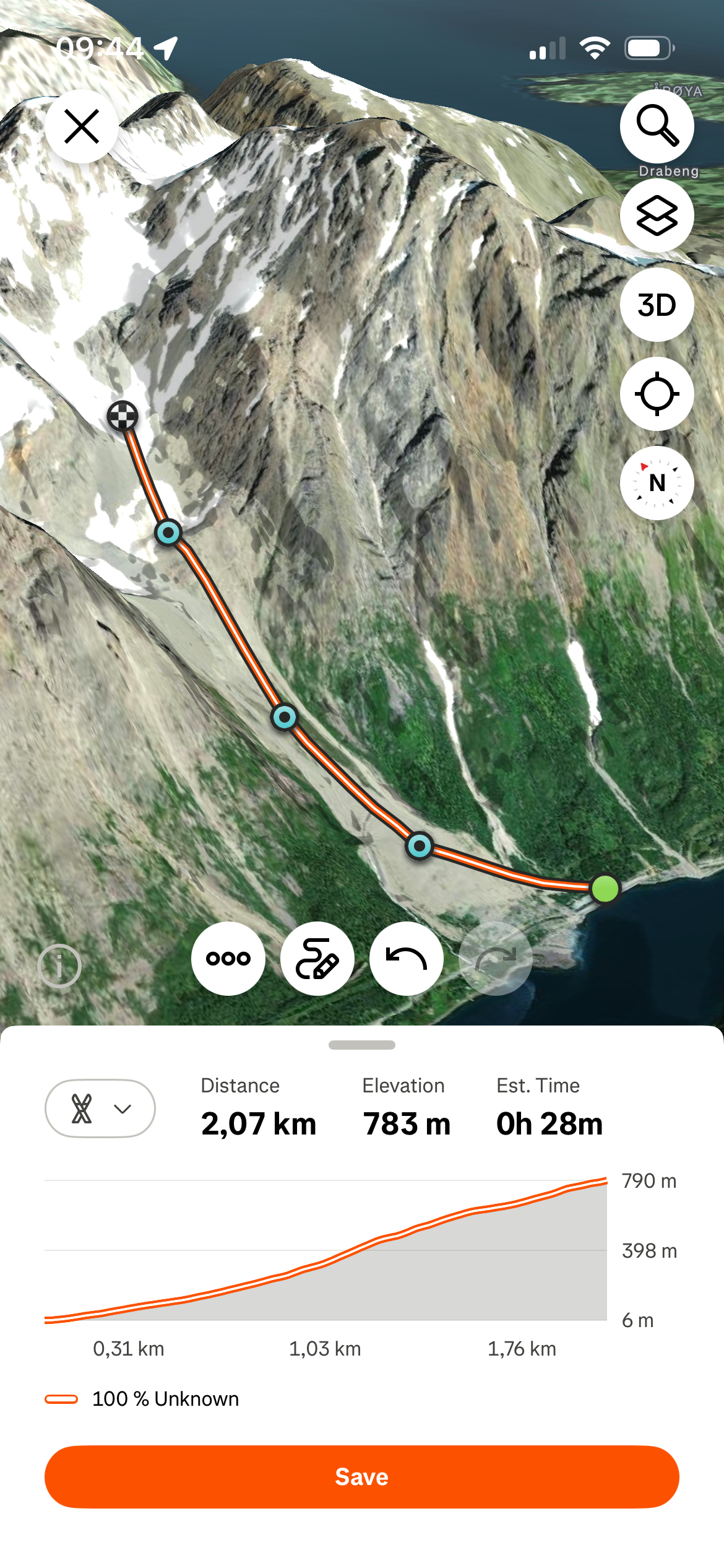

        Hi again,
        Here’s another example. Two first screenshots are from creating the same route. The only difference is that in The second picture I added the last route point at the peak, and in the first picture the last route point is slightly before the peak.

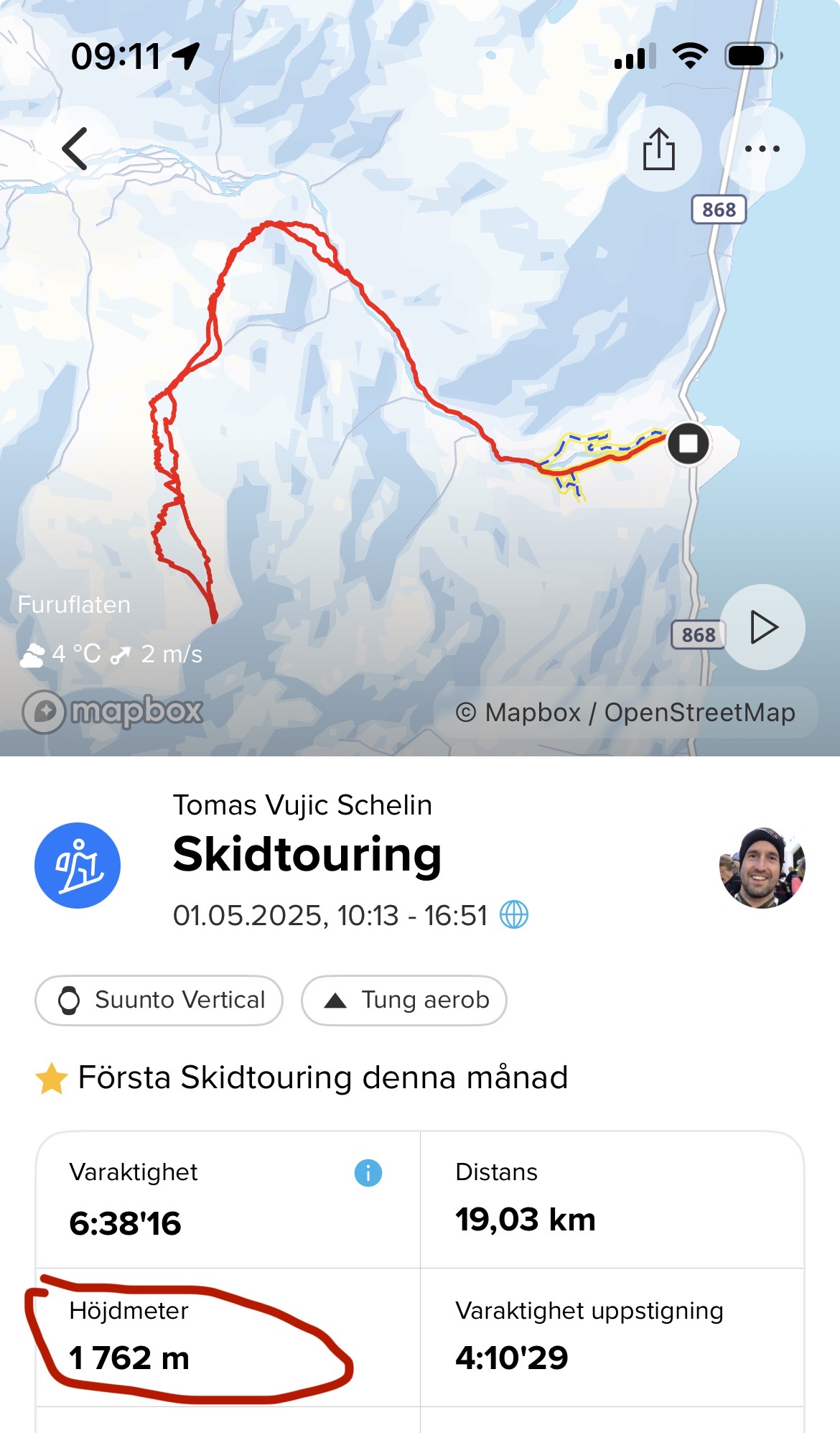

        And here’s a screenshot from doing that ski tour last year.

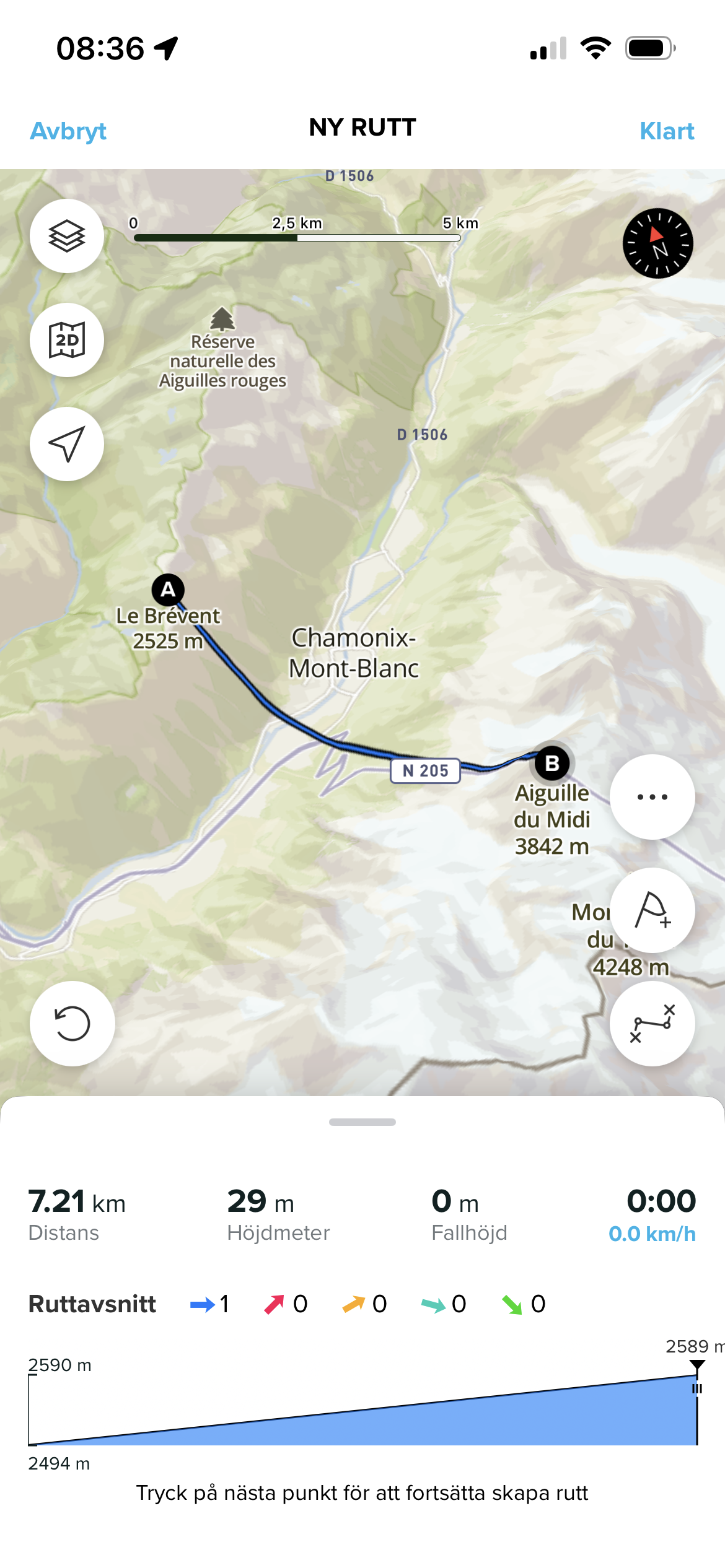

          And here’s and example of creating a route only consisting of point A to point B in Suunto App and in Strava. Point A is Brevant and Point B is Aguille du midi in Chamonix (France).
                  When building a route in “free draw” mode the elevation is off. This is a known problem. Hopefully will be addressed one day.

                                @2b2bff if you’re asking why SA doesn’t provide a correct elevation profile between two arbitrary points on the map then it’s because it has never been developed. This is a separate task, not the same as provide an elevation profile for a route along path network
