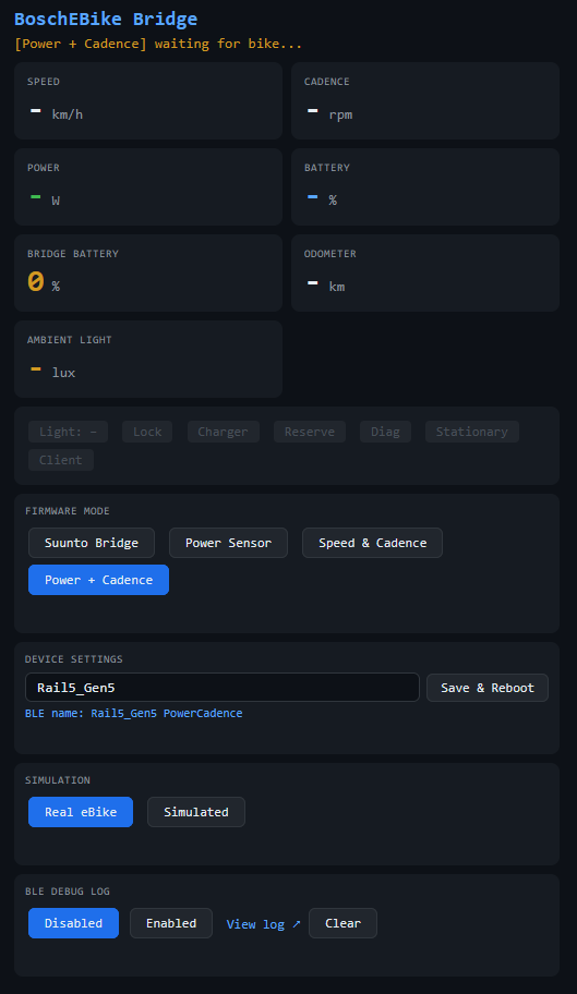

        I also updated the integrated WiFi access point UI, where all bridge settings can now be configured directly from the browser:
        There is now also a simulation mode that allows testing the connection with Suunto watches and bike computers without needing to connect to the actual eBike. Useful for validating the setup or experimenting with different configurations without having the bike nearby.
