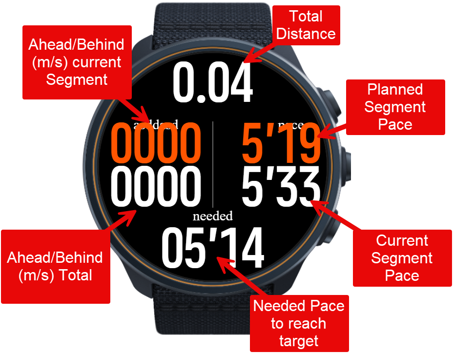

      Pretty new (and old…) on this, but cannot figure out how get negative values to display on the S+ Simulator? I am developing a Race Pacer app that takes user input based on pace zones and segments (running) and want to display ahead/behind per segment w. respect to predefined race plan (either time or distance). App in short:
      Sements are planned beforehand - and entered through user settings in mobile app:
      Watch display current configuration, where the problem is with the Ahead/Behind on the left fields:
      I have tested most outputFormats in HTML - but no success. I also tested Math.abs in the main java - and then it works as expected (without (-))…
      So - the logic is there and most things seem to work - and the race is on saturday… Any ideas/inputs?
