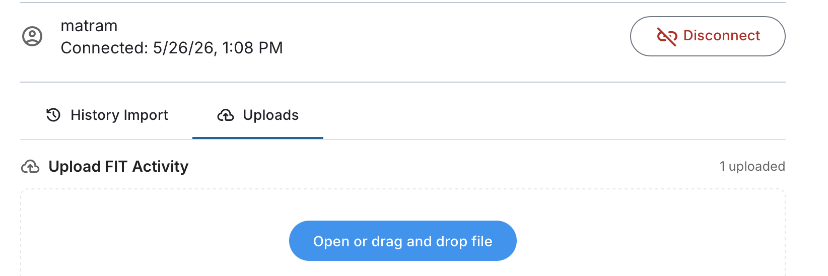

        You can use Quantified Self for uploading Fit files
        Creator of quantified-self.io a portal that allows you to analyze your data from various providers, upload fit activity files to Suunto app, gpx routes and more…
          matram @Dimitrios Kanellopoulos
          @Dimitrios-Kanellopoulos
          Thank you for the tip. I signed up for a Pro subscription and will try that out. Currently uploading years of training history. 😊
            Dimitrios Kanellopoulos Community Manager @matram
            @matram Feel free to ping me if you need help. or you want another service connected for autosync, but try the official channels of the app. I made this for me convenience as well and managed to upload history from Strava Garmin and all the stuff I had in the past
              Dimitrios, maybe we are mis-communicating? To clarify, I want to upload a FIT workout file (not activity) and secondly I do not have API access.
              I am not sure what you mean by “official channel of the app”. Are you referring to apizone - how-to-workout-upload (not allowed to include a link)? This seems to be what I need, but I am not allowed to use that. 😞
              quantified-self which you suggested, only seems to upload activities not workouts.
              intervals.icu uploads workouts but only packaged as a Guide in the format they have selected. Hence my idea about reverse engineering the guide file.
                @matram ok right. I was confused. Workouts != activities. I can try to implement a workout upload but I see that ideally you need api access to suunto. for that I suppose you should mail them unfortunately.
