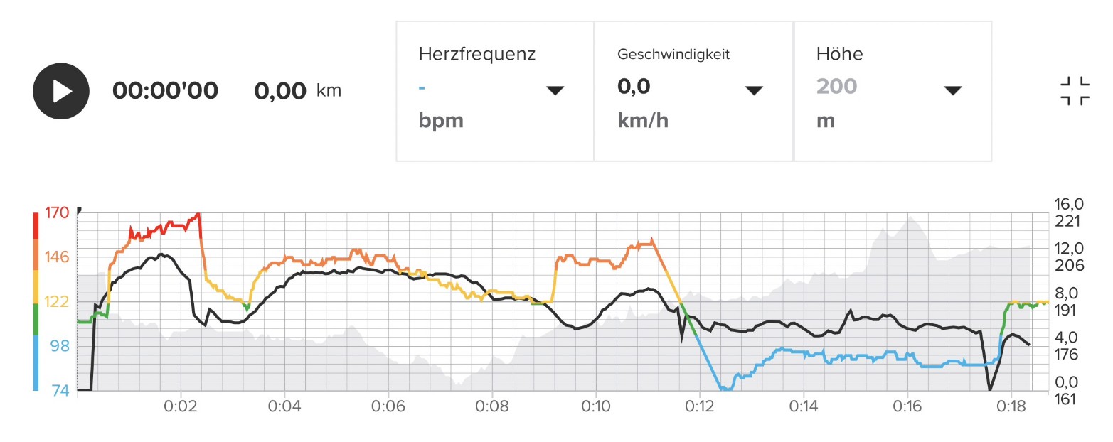

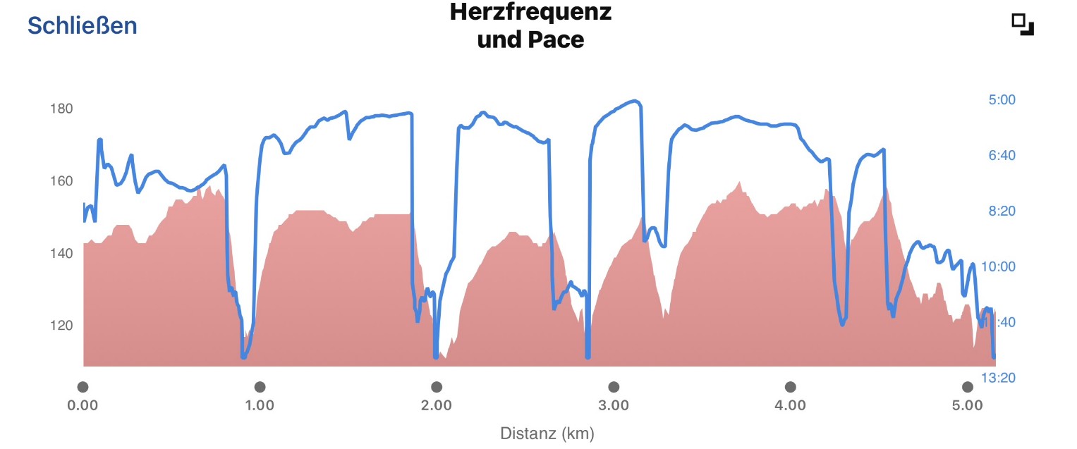

      I stopped using my Suunto HR Belt after the last firmware update because I experienced several rides with strange readings and repeated connection problems.
      Recently, I tried it again during a run. With the belt connected to my Suunto 9 Peak Pro, the watch either showed no heart-rate data at all, implausible values, or a value that appeared to be stuck even while I was walking.
      The belt battery is shown as 100% both on the watch and in an iOS Bluetooth debugging app.
      Because the readings looked so strange, I started recording with my Garmin Forerunner using its optical wrist sensor about 30 minutes into the run. I then stopped the activity on the 9 Peak Pro and connected the HR Belt to the Suunto App for the final part of the run, while the Garmin continued recording.
      With the belt connected to the Suunto App, the readings looked much more plausible. The heart rate clearly decreased when I started walking. There still appeared to be one brief disconnection, but overall the values and their behaviour were much more realistic than with the 9 Peak Pro.

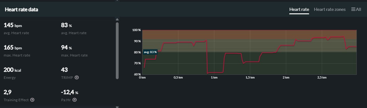

      Today I gave it another try. I thoroughly applied electrode gel and waited until everything appeared to be connected correctly before starting. During the run, the heart-rate reading suddenly disappeared again. I ran up a steep slope, thinking that perhaps the signal was simply too weak at the lower intensity, but no heart rate appeared.
      I stopped the activity, checked everything and started again. This time the heart rate became stuck at 97 bpm and did not increase, so I disconnected the belt and switched to the watch’s optical wrist sensor.

      9PP with HR Belt. Started at 11:33:
      Garmin. Started at 11:58 - Same and as Suunto app:
      Suunto App with HR Belt. Startet at 12:21:

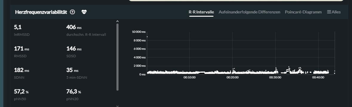

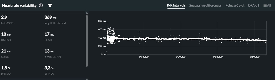

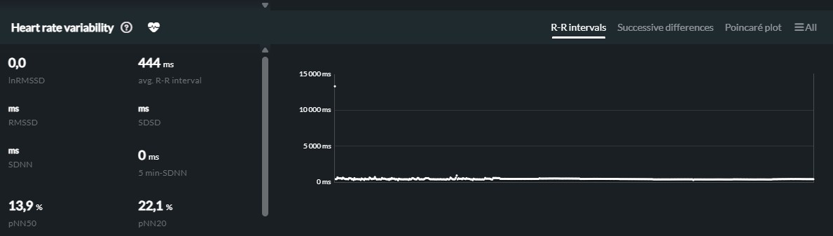

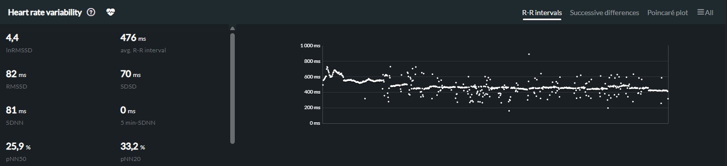

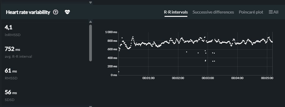

            I checked runs from Spring in this year.
            In April, with apparently the same setup, the R-R data recorded by the 9 Peak Pro looked normal. The recent recording contains repeated missing or corrupted R-R intervals and implausible HRV values.
            So it doesn’t look like a Firmware thing cause the major BT updates happend in Sept 25 and in January 26
            April
            Juli
            PyranyaP 1 Reply Last reply Reply Quote 0

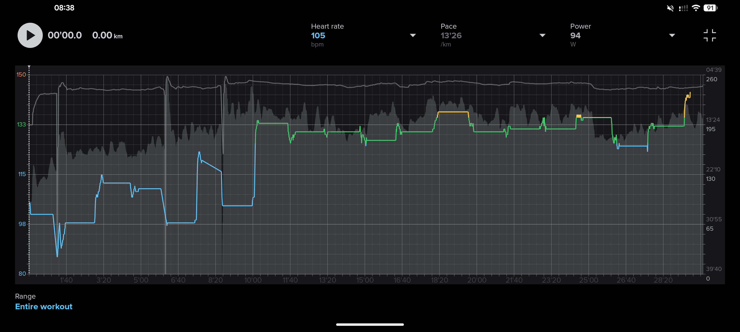

                        Brad_Olwin Moderator @Pyranya

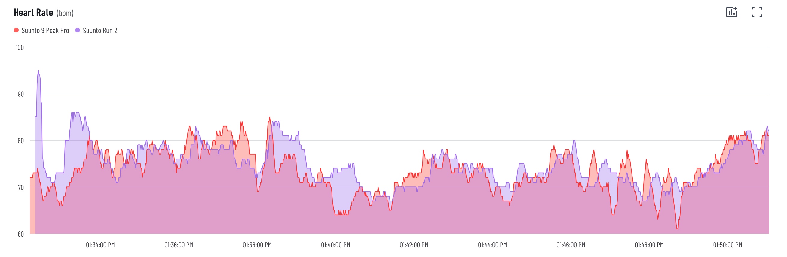

                        @Pyranya Here is the example from my run, a 20 min walk today was fine as well. V2 and S9PP paired to SHRM2
                        Walk with Run 2 OHR and S9PP with SmartSensor, these don’t match as well as I would have expected.
                        Vector/T6c/Vertical 2 Ti
                        PyranyaP S 2 Replies Last reply Reply Quote 0

                          I’m not sure, but you can see from the graph that there’s a regular drop in heart rate at that point. It seems to me that this happens every time the connection is lost.
                          During this run, I made sure to maintain a consistent pace throughout. The first 5 minutes and the last 5 minutes were slower than the 20 minutes in between.

                                @Pyranya it is not in Suunto App. Export your file to an external service, such as Runalyze or quantified-self.io and check it there. If it is very noisy, then there is some issue with your strap.
                                • PyranyaP Offline

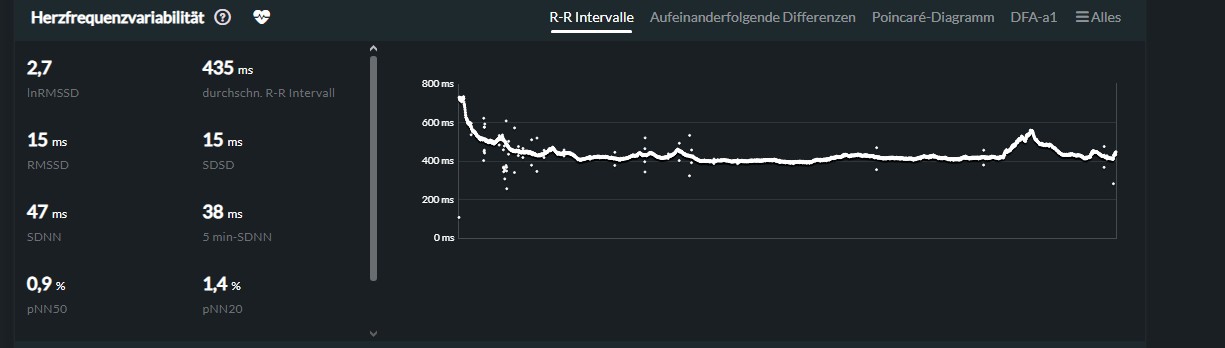

                                  Pyranya @isazi
                                  @isazi
                                  Used Runalyze:
                                  It seems to look very noisy.
                                  greez
                                    sartoric Moderator @Pyranya
                                    @Pyranya
                                    indeed
                                    it looks ok at the beginning, then it goes bananas 🙂
                                    What’s that sample duration ?
                                    SVTS - 2.50.28

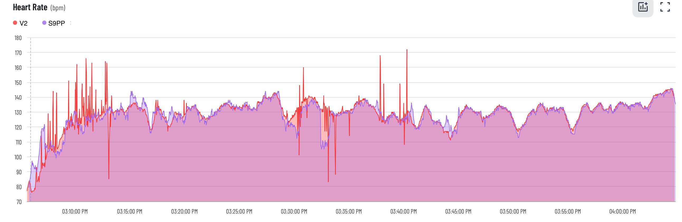

                                          Swaddy61 Silver Members @Brad_Olwin
                                          @Brad_Olwin It seems to me there are some pretty big (like huge) HR spikes on the V2. I am not sure I am understanding what you have written. Are both the V2 and the S9PP paired to the HRM2 at the same time? If so, why are there big spikes on one, and why don’t the traces match exactly?
                                          SV Ti All Black, Coros Apex Pro, Ambit 3 Peak, Ambit 3 Sport (sold), Ambit 2 (Sold), X10 Mi (Retired), Quest (Sold), T3 (Sold), T6C (Retired as unfixable - Suunto gave me a big discount on Ambit 2!), Polar H10 belt, Suunto Smart Belt
                                            Brad_Olwin Moderator @Swaddy61
                                            Yes, both connected to the same SHRM2, it could be that the V2 was not receiving the signal as well. The V2 is on field test firmware and that could be an issue. I would not pay much attention to it.
