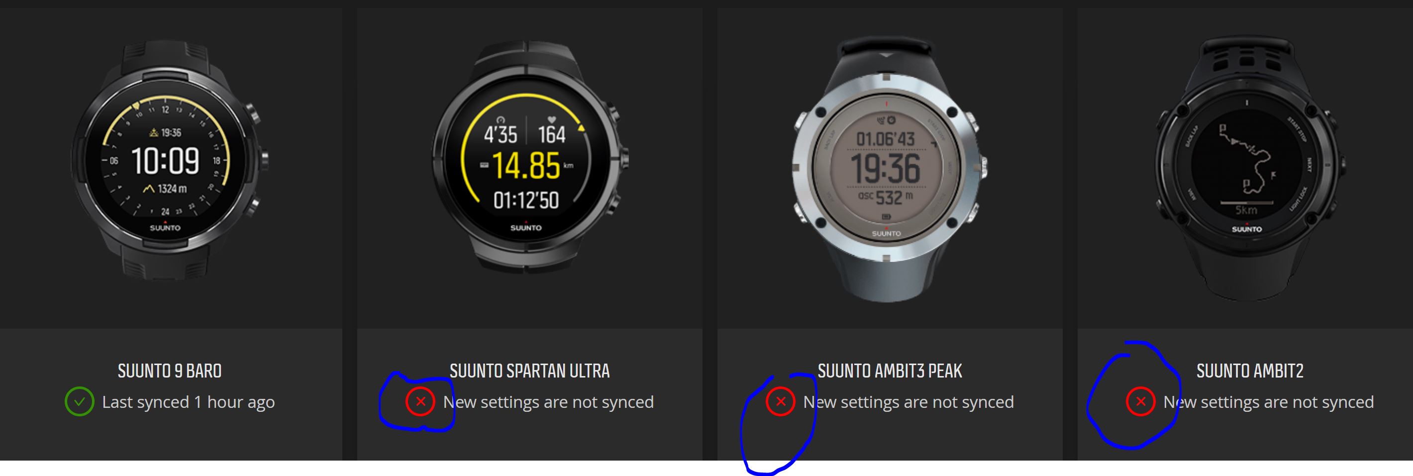

          There is a problem with toggle setting for using track in watch Suunto 9. Program can not save this setting. This have been worked fine, because I use this 3-5 times per month. Works fine for Spartan, not for Sunto 9. I can not transfer track to watch (sh*t I 'll have to use Locus on Android again :(:( ). Tried with Chrome and Edge, same story. Anyone else. I do not use SA

            No S9 for me, but are you sure you can add it to mutliple watch ? Just a question, can’t help here more.

              In theory, YES, but in practice, NO. I can not add tracks to not synched watches. I Have sold them years ago. Like I mentioned before I can not move ‘check box’ to the right (like on spartan ultra on picture) on S9)

                @zvonejan I can transfer the route to S9B… just tried… Can transfer to two devices also…

                  What browser, do you use? I have tried on two pc (nuc-pc and hp laptop).
                    Dimitrios Kanellopoulos Community Manager @zvonejan
                    @zvonejan remove those

                      ☺ ☺ I forgot about the limit of uploaded track in watch. 15 is the limit. However I am 100 % sure that in the past a msg has appeared in such situations on the Web, maybe not in S9, but on ambit 3 for sure. Ok, new tracks are in the watch now. Thanks to all
                        Ambit route limit is 50, scrolling through half of that in a watch would be pita so it’s quite rare to hit that limit 😉
                        Though reaching total point limit for routes is not that hard. And iirc watch > navigation is only place in MC that has provided hints about available route resources. Many others have been puzzled by disabled "Use with my … " toggle in map view, including past and current Ambit users. Like myself.
