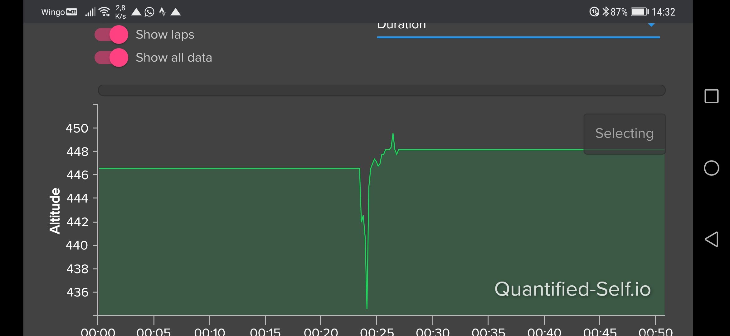

                      the alti graph in your first link looks quite jumpy compared to the others.
                      I have experienced weird total ascent when the skin covers the sensor venting holes. If it happens once or twice it could be easily already around 20-30m or more.
                      I saw a much more detailed graph in quantified-self.io. If you upload your wrong recording to QS, you will see unusual spikes and and how much they spike up and down.
                      would be interesting to see a screenshot of this graph 👍
                      here’s a graph of one of my recent home TRX workouts.
                      living sideways

                          the first link shows a smooth alti graph and after a short time it starts becoming spiky, also your bike ride has a downspike that might not be there on the real topography.
                          I don’t think it is related to the HR belt. If there is a relation then it is the way you wear the watch when you measure with OHR on your wrist.
                          Next time you do an activity, try to observe if you cover the baro sensor.
                          And just in case to exclude another potential failure cause: soak your watch over night in water and carefully rinse the baro sensor then.
                          This helped some athletes already to get their weird measurements fixed ✊
