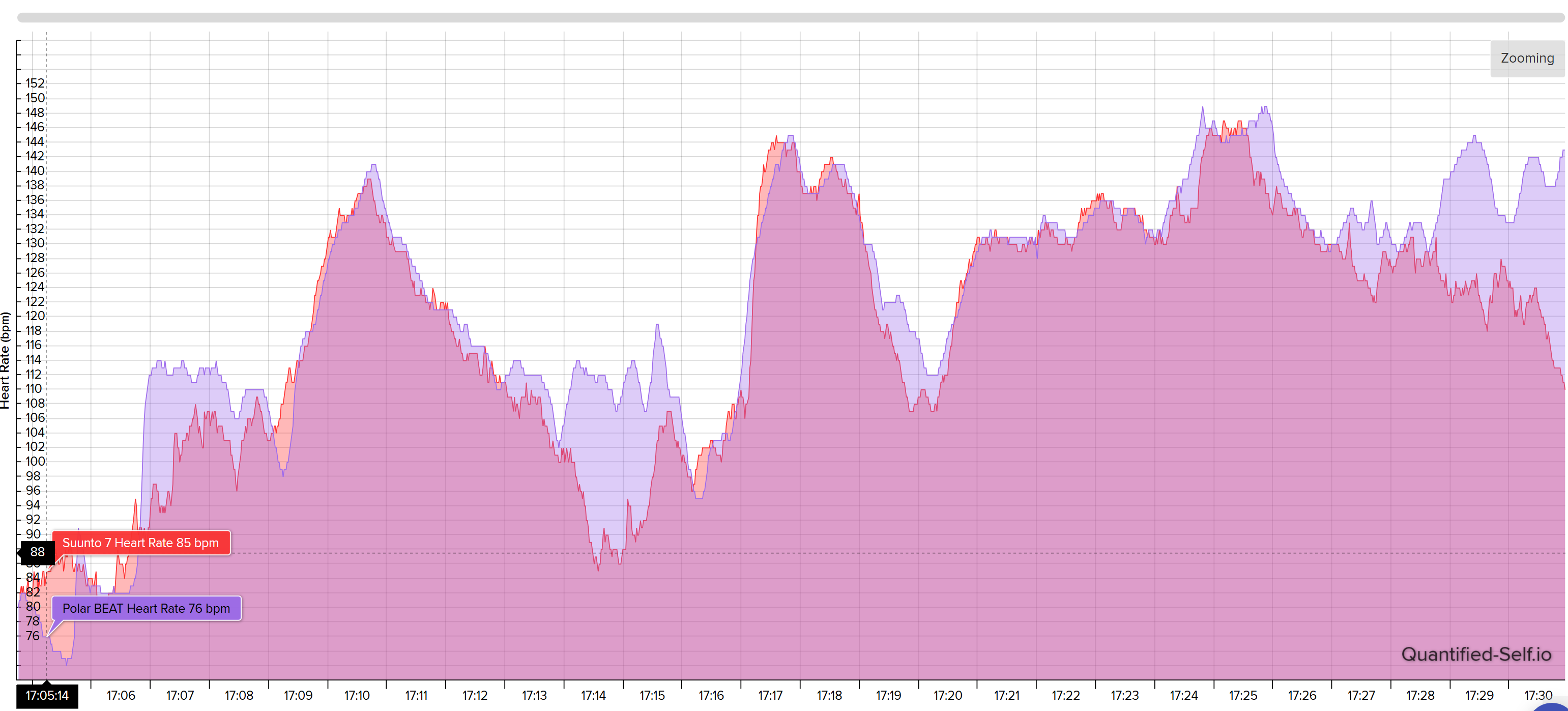

              Quick OHR comparison from this morning’s commute to work.
              Polar OH1 (left upper arm)
              Suunto 7 (left wrist)
              Distance: 8,87 km
              Duration: 24:45
              Temperature: -6 C
              Polar: avg 128bpm, max 150bpm
              Suunto: avg 122bpm, max 151bpm
              S7 = red
              If I look at the course profile the S7 should be more right in the beginning but it’s hard to say, what was the reality.
              I’ll try it again on my way home and also with running.

                @JANTIKAINEN I’d say it’s not a very fair comparison 🙄
                -6 is cold enough to skew something on your wrists when compared to the upper arm blood flow wise. Even mid-course due to wind and stuff.
                Also, were you on the bike? That would skew things even further. Generally, wrist location is OK for the bike, but only OK… Upper arm would again have a much better blood flow at all times.
                I’d recommend comparing apples to apples: wrist vs wrist. Or better still a strap vs S7. Preferably in activity like running that doesn’t involve wrist flexion.

                  JANTIKAINEN Bronze Member @Guest
                  @NickK Yes I was on a bike and yes I think also that it’s not a fair comparison overall, not even if I would be in ideal conditions. Cycling and WHR has never worked for me and looking at the merged chart I find S7 very good.
                  So my point here was that S7 performs very good. When looking at the course profile it’s actually makes more sense.

                      A Former User @JANTIKAINEN
                      @JANTIKAINEN said in DC Rainmaker Review:
                      I know 👍 But since you are taking the time and effort to do the comparison, we may as well do it strict 🤓 So, certain watch fashion bloggers wouldn’t discount that as flawed. Likewise, if Suunto 7 does fail in one regard or another, I’m sure Suunto would like to know about exact circumstances and benchmarks.
                      J 1 Reply Last reply 28 Feb 2020, 14:46 Reply Quote 0
                        @NickK I’ll be heading home with my bike in a moment and will try the OH1 in my right wrist vs. S7 on the left.
                        Temperature at the moment is +1 celcius.
                            Cycling 8.89 km
                            Temperature: +1 C
                            Left wrist: S7
                            Right wrist: OH1
                            Suunto: avg 118 bpm, max 147 bpm
                            Polar: avg 122 bpm, max 149 bpm
                              @JANTIKAINEN I’m really interested in those two spots (middle and end) where sensors disagreed. Do you feel OH1 was right? What was happening on the route?
                              J 1 Reply Last reply 28 Feb 2020, 16:49 Reply Quote 0
                                @NickK
                                The middle part is a section where’s lot of pedestrians crossing the bike lane so this is probably the slowest part of the route. I think the reality could be somewhere between the 2 readings.
                                The end part is strange. The highest OH1 peak is the peak of not so steep uphill. Looks like S7 comes a bit behind but doesn’t reach as high. At the very end where S7 goes down is actually correct, since I’ve already stopped but OH1 still makes a bump up.
