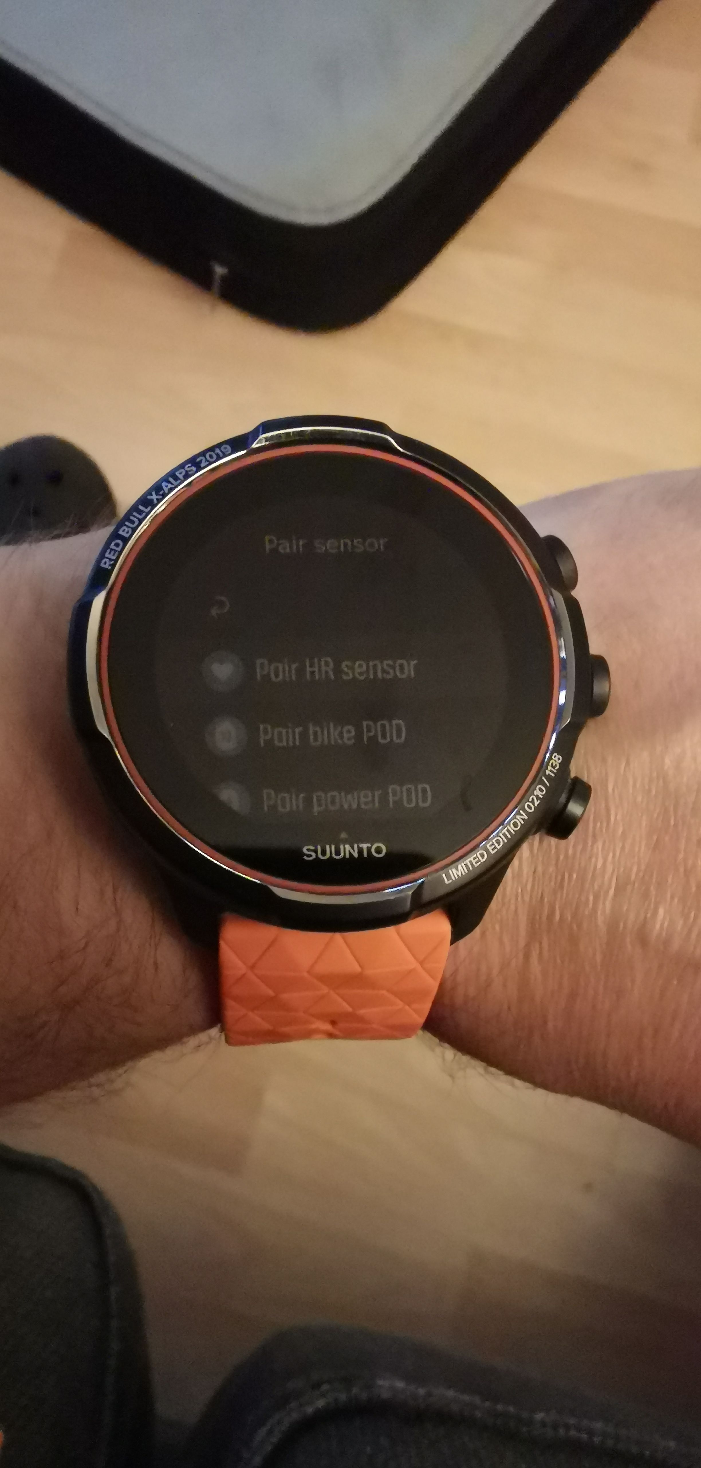

              Martin Tuharský @isazi
              @isazi I’ll try again with the pictures.
              Number one.
              I will select the sports mode.
              Number two.
              She is not looking for a chest strap.
              Number three.
              The wrist pulse is turned off. That’s how I want to leave. This is fine.
              Number four.
              For sensors, the chest strap search is switched off.
              Number five.
              I’ll turn it on.
              Number six.
              She is looking for a chest strap.
              After the end of the activity during the next training, the search for the chest strap is switched off again.suunto 9.jpg

              • freeheelerF Offline
                freeheeler @Martin Tuharský
                @Martin-Tuharský
                go to the menu, settings, connectivity, pair sensor and your watch should remember your chest belt 👍
