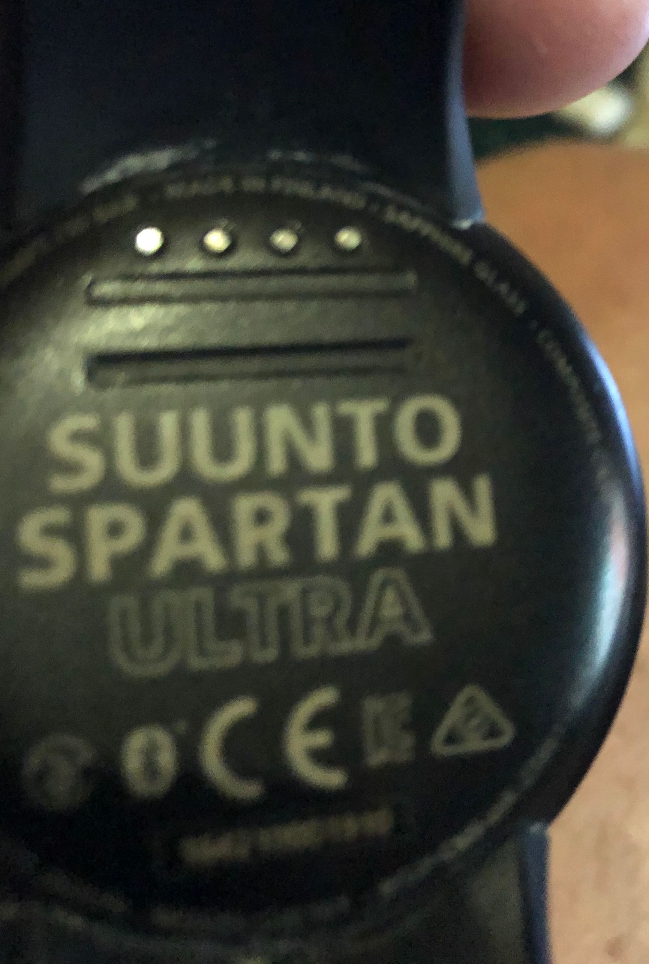

        awehbe
        Hi @sartoric yes, and everytime i rest it i have same error

          sartoric Moderator @awehbe
          @awehbe
          Can’t see the pictures.
          Anyway I would contact Suunto support.
          Maybe you need to send it to the repair guys
