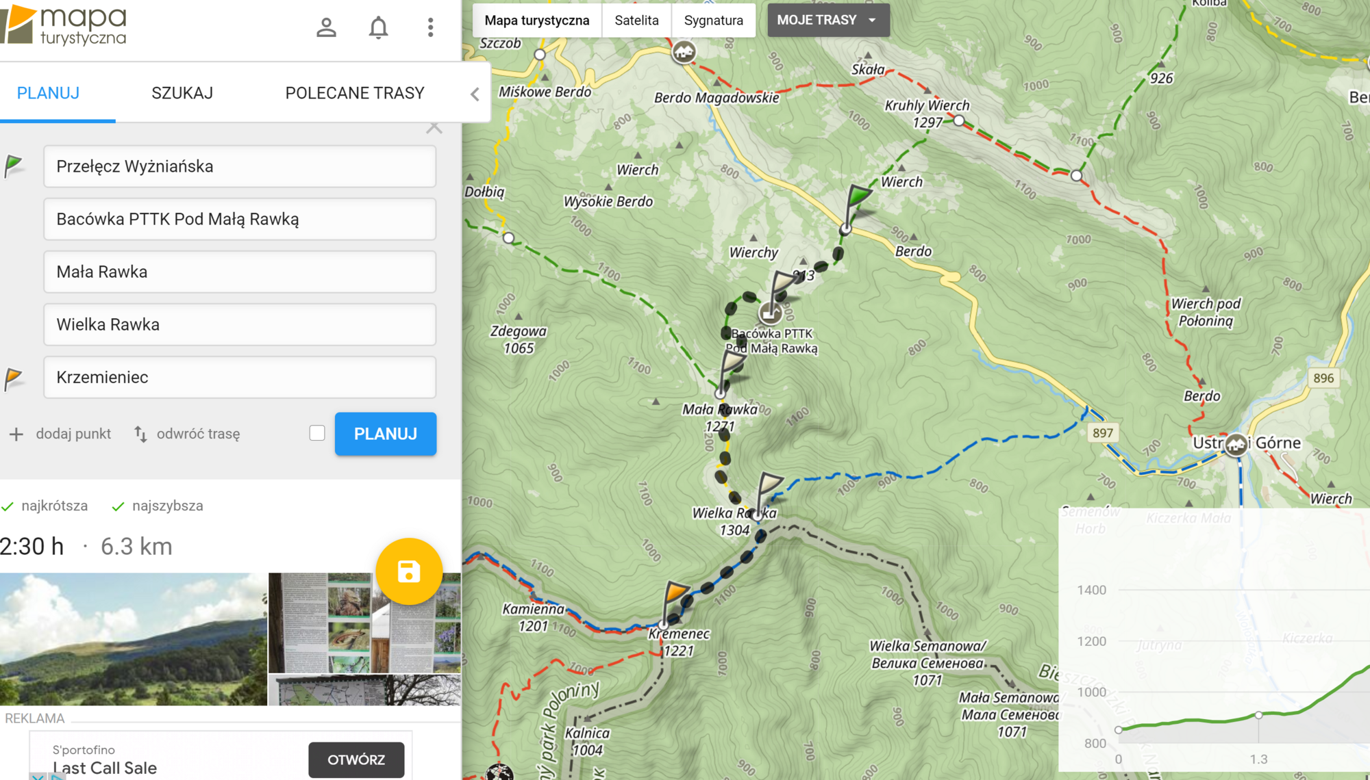

                                  Well, since I am a scientist, I decided to check it with three repetitions on different sites that I use 😉
                                  First off, here’s the route:
                                  created in SA, it has 6.22 km and 492m ascent (the latter value seems wrong to me)
                                  text alternatywny
                                  Now let’s move on to the services that offer route creation and gpx export:
                                  1. mapy.cz
                                  2. komoot
                                  3. mapa-turystyczna
                                  text alternatywny
                                  text alternatywny
                                  text alternatywny

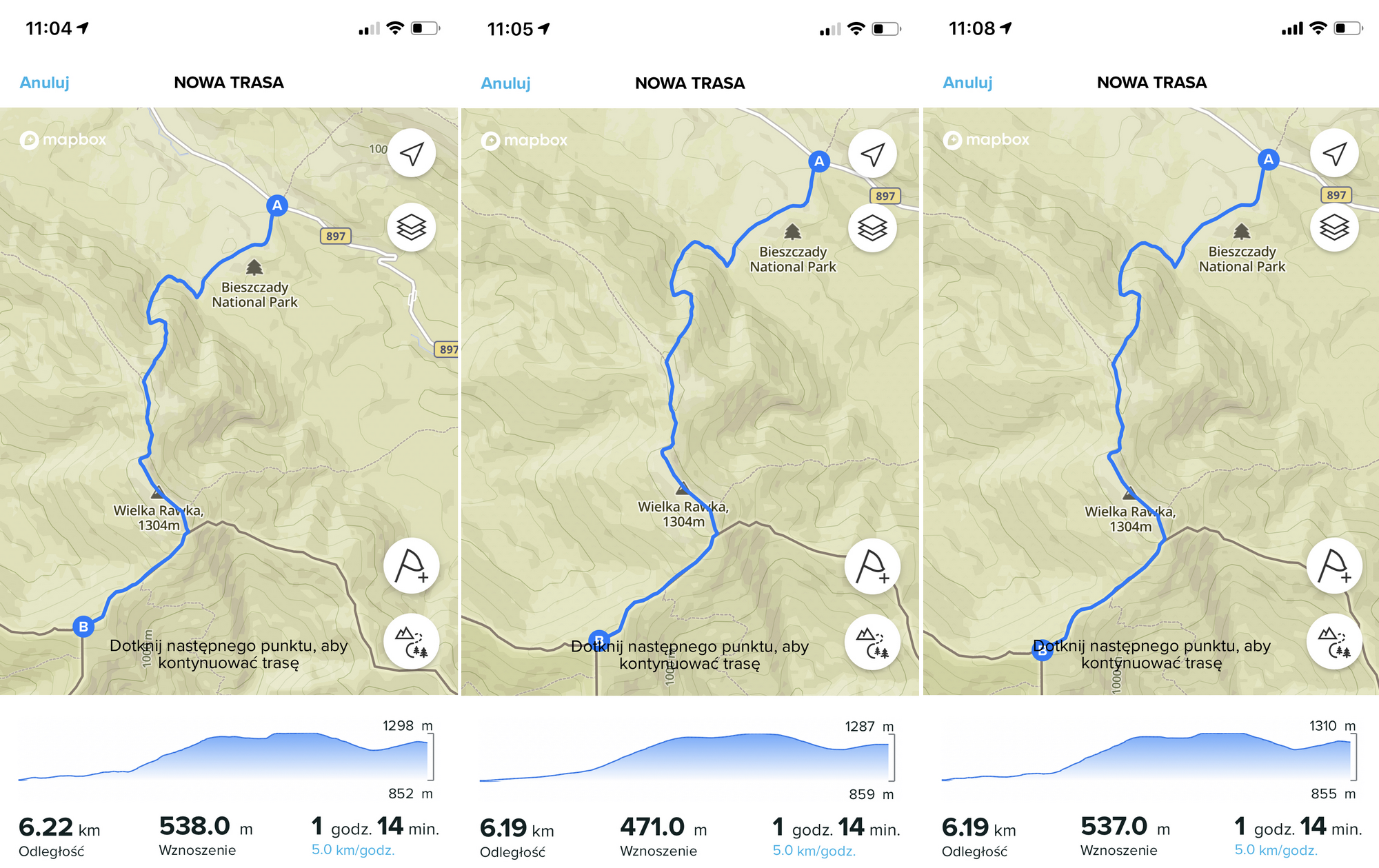

                                  Okay, now that we have a mapped route, it’s time to import it into SA.
                                  Below is the effect of importing a gpx file (saved in icloud) directly in SA (from the left: mapy.cz, komoot, mapa-tusrystyczna):
                                  text alternatywny
                                  Now exactly the same files, but sent via QS (same order):
                                  text alternatywny
                                  And finally a curiosity - summary of the distance/ascent from all three websites depending on the method of import (gpx file downloaded via web and uploaded directly or via QS):
                                  text alternatywny
                                  Conclusions:
                                  1. None of the services allows you to import routes with WP, whether directly or via QS
                                  2. Mapy.cz gpx imported by QS adds an infinite number of WP
                                  3. The same route has a similar distance but completely different ascent depending on the site
                                  4. The same gpx file has a different ascent depending on the import method (this is especially strange to me)
