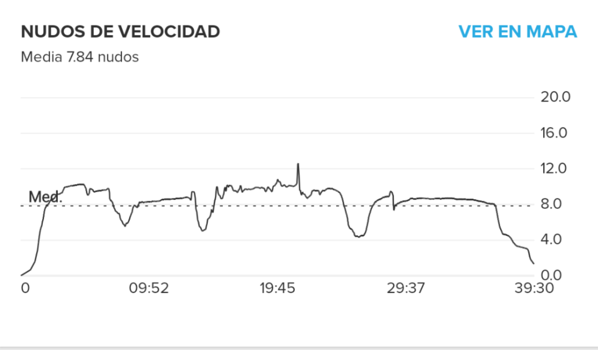

                                suzzlo Moderator
                                I have done sailing once with my Spartan and this is the final information shown in SA
                                https://www.suunto.com/move/suzzlo/5d3ee4ab17683a5de7e37869
                                I hope this helps
                                BR
