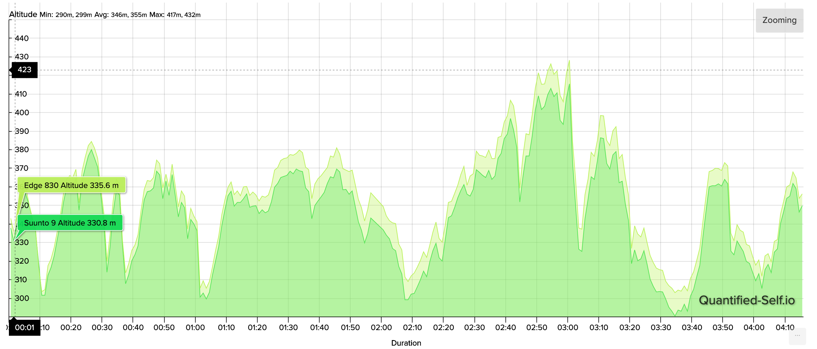

                          Hadn’t thought about loading them into DC Rainmaker’s Analyzer tool. This is what I see (blue is Suunto). They track well, Suunto is just consistently low.

                            @fazel said in S9 barometer problems:
                            2993 ft
                            nothing is wrong here.
                            Edge counts ascent even with ±1m bumps and affected by wind if it has a baro.
                            Suunto 9 counts every ±3m
                            Here are the charts
                            Stats if I use 1m resolution for counting ascent
                            Stats if I use 2-3m resoltuion / filter for counting ascent
                            Using Runanalyze to check the elevation data
                            I see as I said above that the 3m filtering is working the best. Take a good look below.
                            Now lets see what other Digital Elevation Databases say
                            Corrected to RaceEvelation service much much less ascent!
                            Using STRM and other services for correcting the data:
                            Take a good look please at the report. I did spend time todo this.
                            My conclusion:
                            Your Garmin records ascent every little bump that you take, more over it’s less realistic and out of coordination from most Digital Elevation services I used.
                            Most of those services are aligned with your S9 baro as you can see.
                            So your garmin overregisters ascent. Take this with a grain of salt but I live in NL. If I apply the same philosophy at some flats I ll be ascenting like 100+ meters that is not realistic. -+1m changes should not be reported as they do not really contribute to any effort the user should take into account for his performance lever nor data wise. That is counting noise basically.
                            fazelF isaziI 2 Replies Last reply Reply Quote 9
