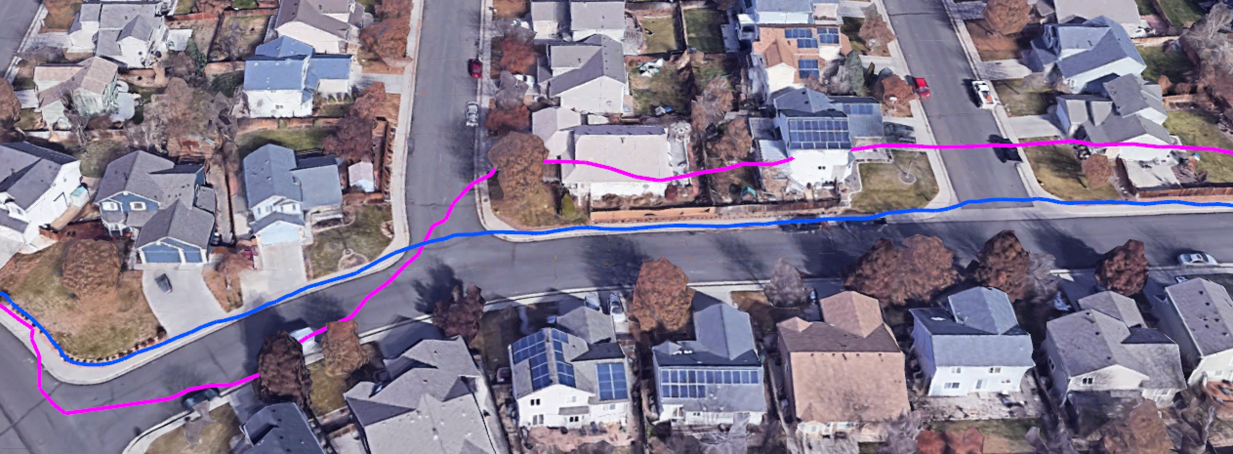

                          @randy-penn Still hoping to get some resolution to this issue. Here are a couple of more examples of the shoddy Suunto 7 track (magenta) vs a Fenix 6x track (blue)Garbage track 2.jpg .Garbage track 1.jpg
                          Randy PennR 1 Reply Last reply Reply Quote 0
                          • Randy PennR Offline
                            Randy Penn @Randy Penn
                            @randy-penn And in that bottom image, no, I didn’t wander through anyone’s house as shown in the image.
