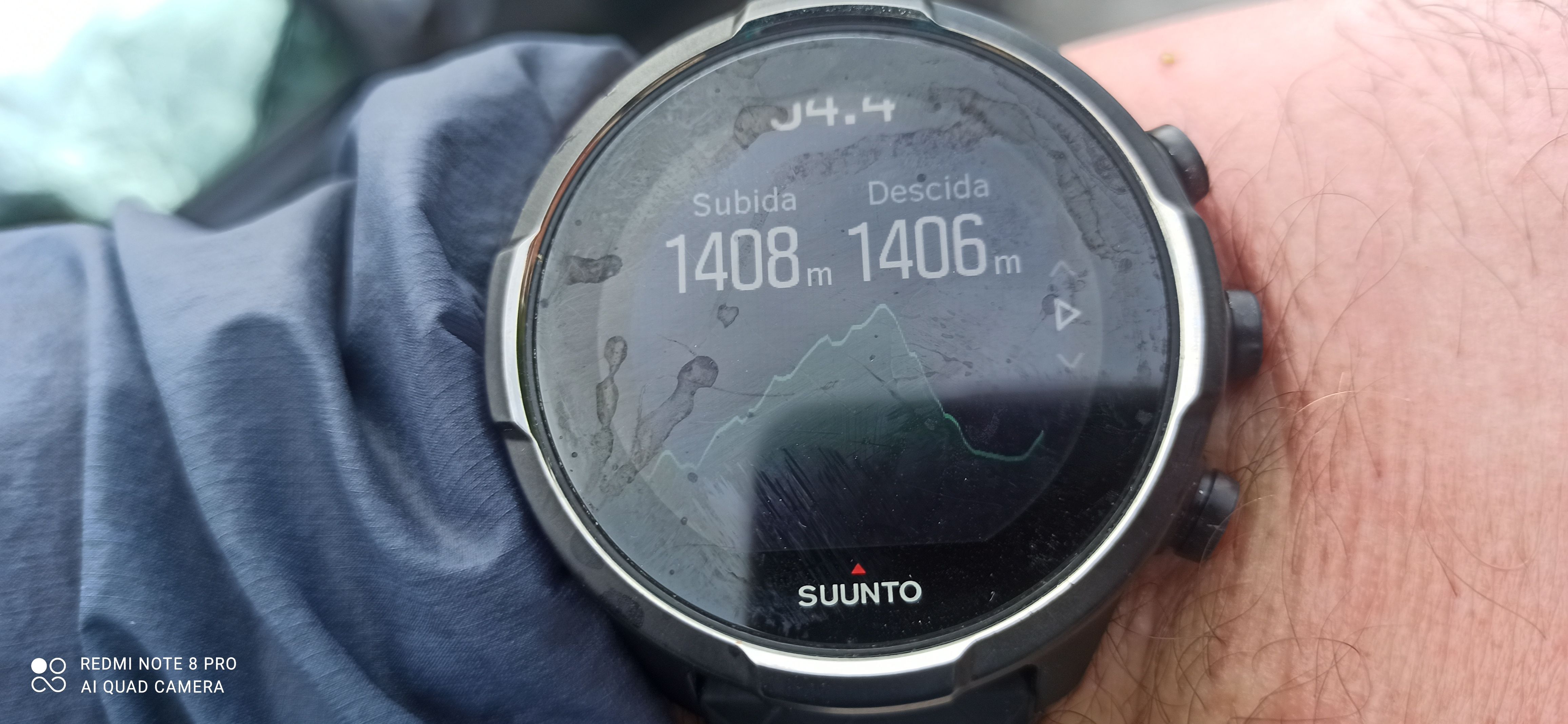

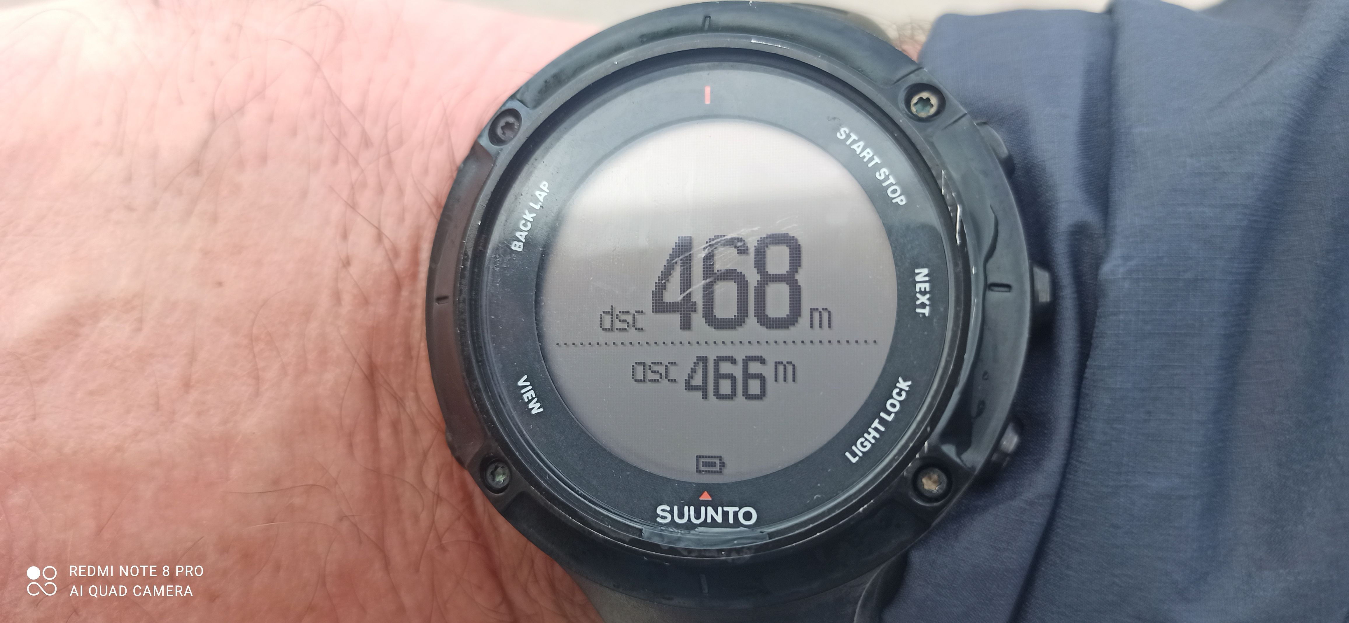

            the problem is the accumulated positive and negative.
            always gives more in long workouts.
            today for example I ran with my 2 watches.
            S9B and ambit 3
            and gave the difference the s9B 1400 with positive accumulation and the ambit 3 450 with positive accumulation.

              @Luis-Duarte There are two issues that could be causing this. First, if the holes on the S9B are being covered by skin or something else that blocks the baro sensor. I can have this problem if I wear on my right hand, when I flex my wrist it covers the holes and I get wrong readings ±D. Second is wind, if it is very windy and directly hits the baro sensor the ±D can be wrong.

                      @Luis-Duarte can you try to have your watch under your sleeve and see if anything happen? Or switch position of S9 and A3 next time (so that the baro opening will be blocked for the A3 and not for the S9)?

                                As I see. You use a rain jacket for you’re workout.
                                Sadly the hole of barometer sensor of S9 is not at the same place of A3 Peak.
                                I think you’re jacket came to touch the S9 hole during you’re run.
                                Try to use S9 over the jacket. Or on the left wrist but try to don’t touch it with your hand.

                                  The problem is here
                                  The sensor, comes into contact with the jacket and pushes the sensor.
                                  ? Luis DuarteL 2 Replies Last reply Reply Quote 2

                                    I believe that @Luis-Duarte has the watch since christmas maybe he has runs without jacket and that this issue may be recurrent.
                                    If S9B is so sensitive to jackets how runners do?
