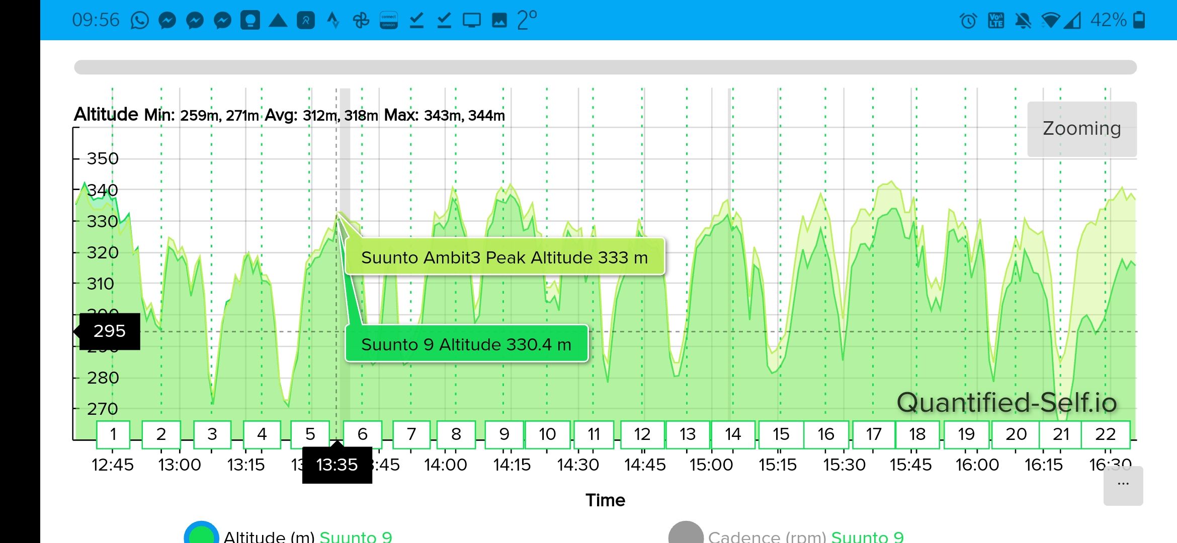

      @fazel I spent some time again with your files and passed them through various services and still the ascent is reported lower from all dbs except Strava.
      Try loading your ambit file to runalyze
      So you can see above corrected and uncorrected.
      Now I loaded both files to qs.
      The altitudes are not so similar. One of the 2 had a fault probably due to some hand movement.
      Take a look
      You can clearly see that the ascent was missed by the s9 not due to some software but rather to different readings especially at the end that the diff is quite close to the ascent diff.
      Again the algo is the same for all watches , what you experience is more of pressure sensor changes.

                                • stromdiddilyS Offline
                                  stromdiddily Gold Members
                                  Interesting one for me today…S9 more than doubled the ascent/descent on my route. Green graph is a lot more jagged than the typical results.
                                  Pouring down rain today but it was constant the whole time.
                                  fazelF freeheelerF 2 Replies Last reply Reply Quote 0
                                  • fazelF Offline
                                    fazel Bronze Member @stromdiddily
                                    @stromdiddily so light green is today, dark green is a track from the same route ran in the past? I see this sort of delay with FusedAlti, @Brad_Olwin has as well.
                                    stromdiddilyS 1 Reply Last reply Reply Quote 0
                                      stromdiddily Gold Members @fazel
                                      @fazel green is today, yellow-ish is from three months ago on the same 7 mile route. The start looks ok tbh but the green is reporting over 1k feet of climbing and the yellow is correctly showing 500ish feet.
                                      Edit - QS feature request, ability to assign colors to merged tracks 😄
                                      • freeheelerF Offline
                                        freeheeler @stromdiddily
                                        @stromdiddily
                                        the spike-ish graph looks like hydraulics did magic on the sensor… it’s a wild guess, but possible
                                        living sideways
                                        fazelF 1 Reply Last reply Reply Quote 0
                                        • fazelF Offline
                                          fazel Bronze Member @freeheeler
                                          @TELE-HO hydraulics = water?
                                          freeheelerF 1 Reply Last reply Reply Quote 2
                                            freeheeler @fazel
                                            @fazel
                                            my assumption… pouring rain and the baro holes right next to the wrist… it seals great and the movement could create pressure that causes a down spike. once relieved it shows an up spike.
                                            for our luck the recording is not set to every second as it was possible with Ambits, hence it’s somehow equalling out a bit… or let’s say it would be worse
                                            living sideways
                                            Fenr1rF 1 Reply Last reply Reply Quote 1
