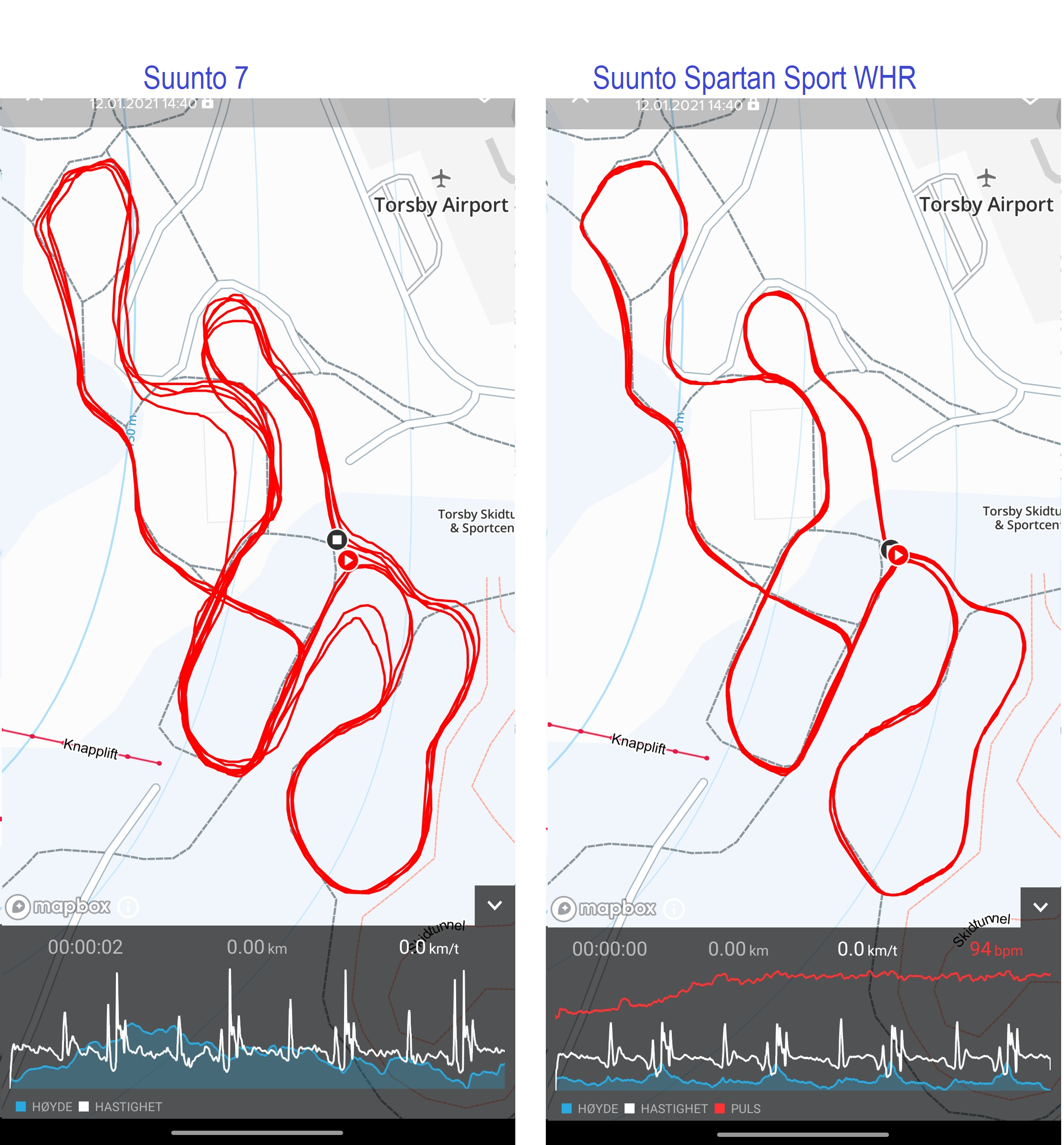

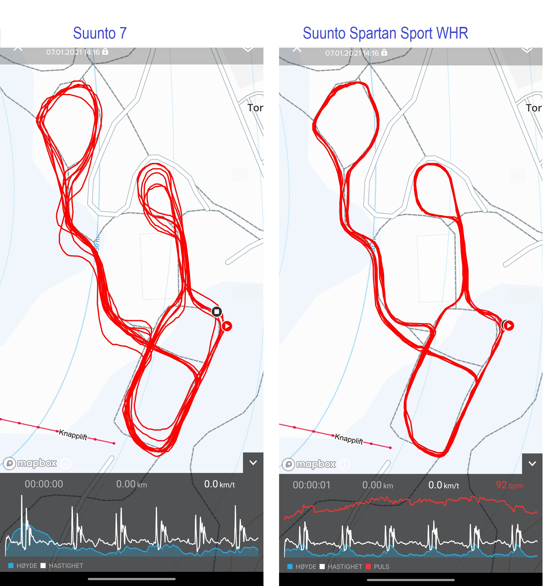

      Over to GPS precision: When I first got the Suunto 7 I ran a few times using both the S7 and my old Suunto Spartan Sport WHR. The GPS precision seemed to be just as good on the S7 as on the SSSWHR. I put the SSSWHR in a drawer and just used the Suunto 7. When the cold came and I started to do nordic skiing I took out the SSSWHR again in order to get to use a HR belt. One watch on each arm and I have also switched arm between activities. I was surprised when I compared the tracks recorded by the two watches. I went skiing on a short round track where I did several rounds and it’s quite obvious that the consistency of the track recorded by the SSSWHR is much higher than the track recorded by the S7:
      Also here you can notice the problem with the barometric altitude recorded on the S7.
      Another example recorded after this week’s update and a reset of the watch:
      Is this questionable GPS precision to be expected from the Suunto 7?
