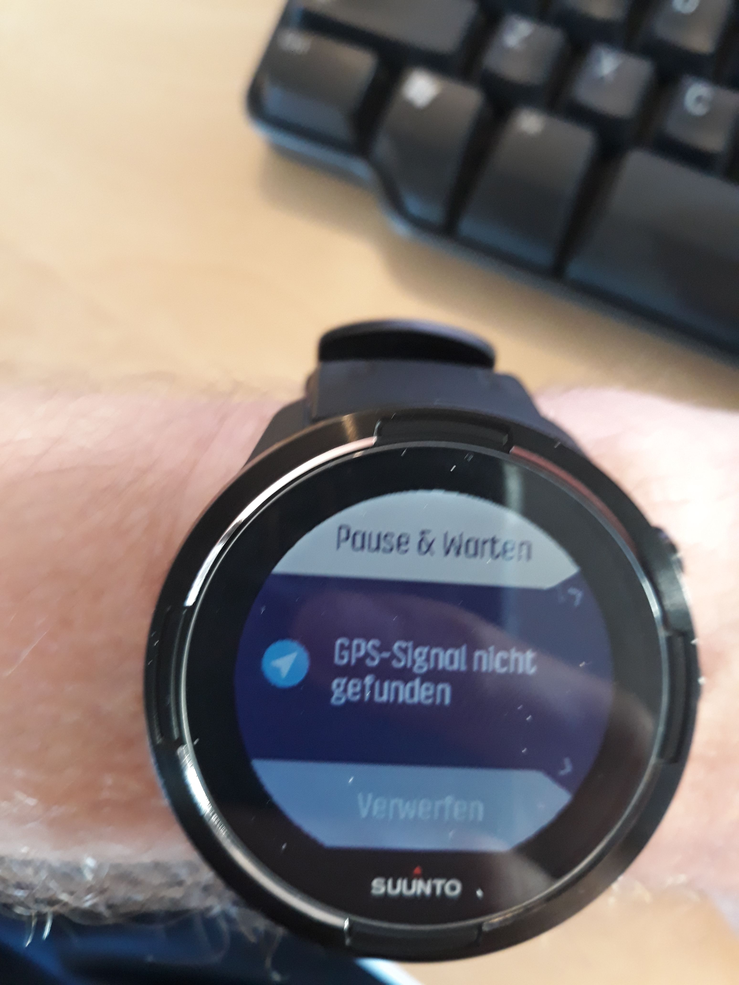

            MatthiasKlug
            @brad_olwin
            no the watch did not restart.
            The screen that usually appears
            (e.g. when starting an GPS related activity immediately and GPS icon is not blinking) did not appear, or i did not notice -i can not confirm that the pause&wait/discard-screen appeard-.

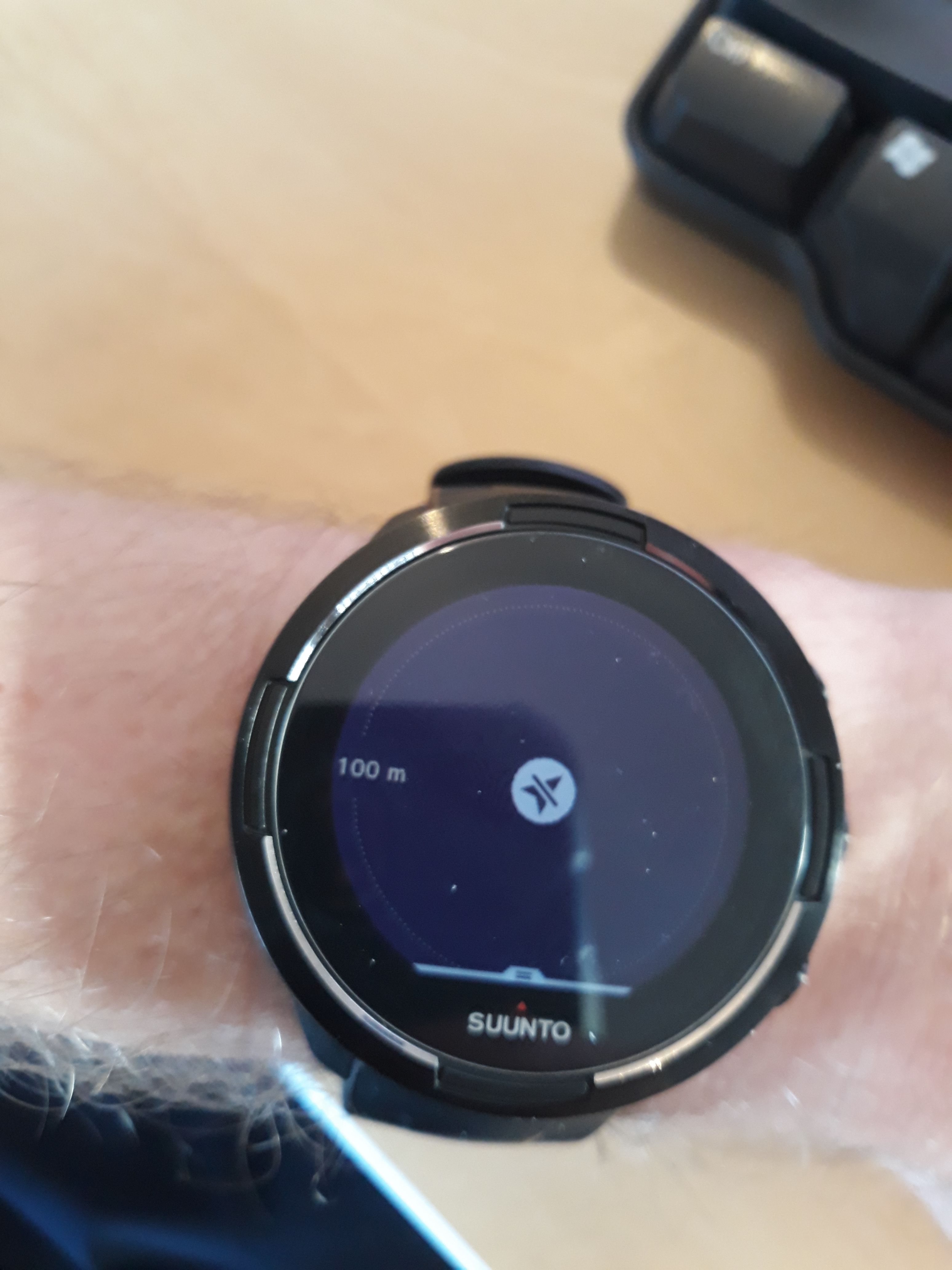

            What happened/what i can confirm is that
            the navigation display was looking like that:
            And all the metrics pace, distance, etc. were messed up. The activity was still running (so was I - literally).
