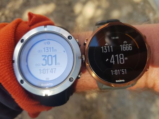

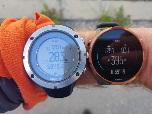

      Since the last months, my Suunto 7 is really wrong about ascent total. It’s always higher than my old same track and different from reference map.
      Today I compared with my ambit 3 and it’s really not good…
      The value of the ambit 3 are perfectly coherent with this known track.
      Pic1 top of a hill

      Pic2 after the downhill

      On the S7, ascent is growing up in downhill and flat road…altitude seems correct but it’s not stable compared to altitude on ambit 3.
      The wind was very light (1m/s).
      What do you think about this ?
