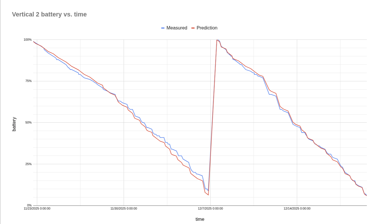

          Posting my experience here too. I continue to monitor in my next charging cycle. I have a feeling that the slight drainage increase that I experienced in the last day or so of the previous cycle continues but too early to tell for sure.
          Here is my recent battery experience with my Vertical 2.
          Over the past 14 days (and a bit) I managed to do 19.5 GPS+HR activities and drain 91% of my battery.
          I built a simple prediction model for battery drainage rate assuming that there are three different drainage rates: During GPS+HR activity (running and cycling in my case), during sleep (DND) and while idle (with notifications and raise to wake variations). Under these assumptions I tried to approximate the drainage model as close as possible to the battery levels and activity times I recorded during the day and came up with the following numbers (they imply slightly less than 5% per day without activities and more than the spec 65 GPS hours):
          Sleep tracking rate: 0.11%/h
          Non activity rate: 0.25%/h
          GPS Activity rate: 1.16%/h
          Flashlight rate: 20%/h
          The above model worked very well during most of the two weeks until the last day or so when the battery got to about 20%. From that point it seems to drain faster than my model allowed. In fact, until that point, the model showed about 1.07% drainage per GPS hour which I updated to the higher number above to compensate for the end.
          Settings:
          AOD OFF
          Raise to wake: Display only
          247 HRM
          Notifications ON
          No external BT connections except Android Suunto App (6.4.7)
          Wireless OFF
          BT discovery OFF
          Brightness LOW
          DND from 22:00-5:40
          Sleep tracking on with HRM but without SPO2
          NO USE OF FLASHLIGHT

                    Update on my battery consumption model:
                    Some of my GPS activities seem to consume relatively more battery than others. In particular, it seems that Mountain biking consumes more than running or bike commuting?
                    Vertical 2, firmware 2.48.16 ran from a full charge down to 7% in 12 full days with 28:45 hours (!!) of cumulative GPS activity (biking, running, mountain biking).
                    The corresponding model that was very close to this (and my previous charge cycle):
                    Sleep tracking with DND rate: 0.11%/h
                    Non activity rate: 0.24%/h
                    GPS Activity rate: 1.50%/h
                    Settings:
                    AOD OFF
                    247 HRM
                    Notifications ON
                    No external BT connections except Android Suunto App (6.5.9)
                    Wireless OFF
                    BT discovery OFF
                    Brightness LOW
                    DND from 22:00-5:40
