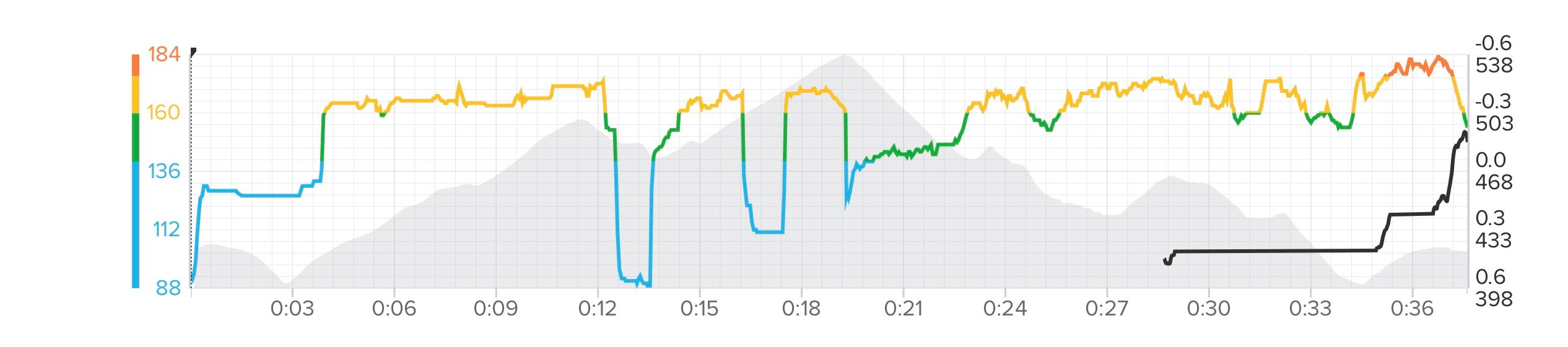

      @isazi I see there are some unusual drops there. Could it be because the belt was too dry?

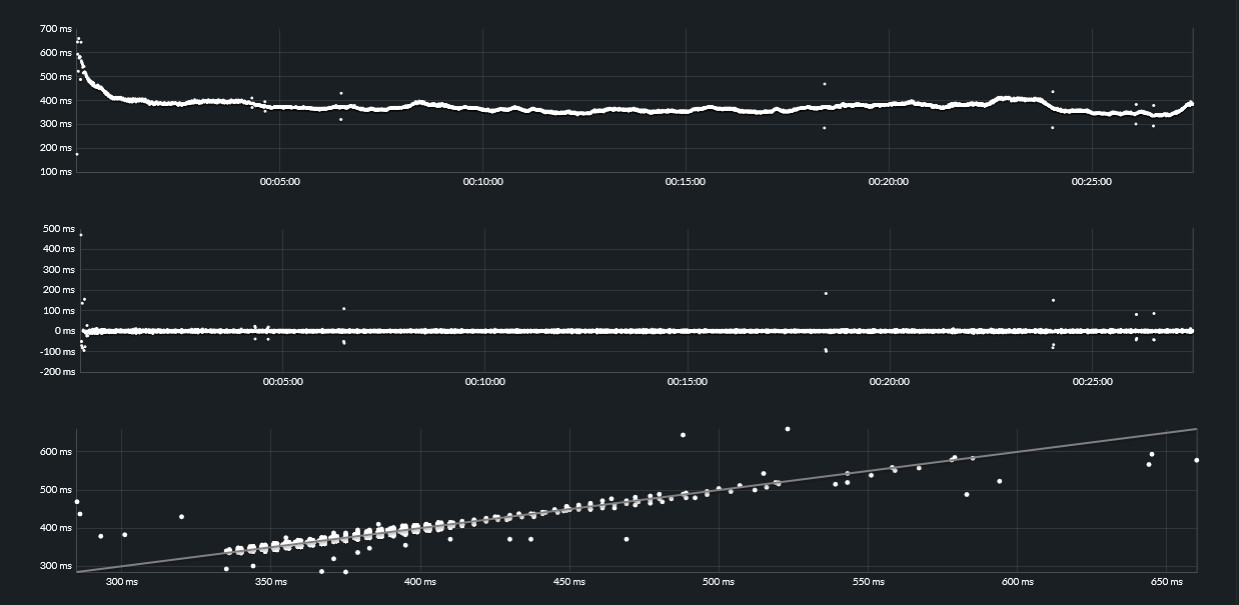

        @martintrail if I am not mistaken, this is the HR plot, but the drops usually correlate with bad IBI data. If you can get the R-R plot, you should see noise

            e.g. Runalyze tracks that data

                @martintrail weird! it’s perfect

                    @martintrail cannot see where the drops come from or why zonesense is not working from this, it seems that there is no noise in the data

                                  I sure hope it is! My replacement unit arrives today because you guys had a good streak with other units… And talking about streaks, the last bad one you had with strong drops in the HR (and ZS pruning) visavis a perfect R-R plot, did you upload the correct run for analysis? The timeline from the SA graph is ca 38 minutes while the R-R data has a timeline of ca 27 minutes.

                                    @Inge-Nallsson What I know, is the R-R chart is built from the beats the strap actually sent, so when the strap loses contact, those minutes simply disappear instead of showing as a gap. About 10 minutes are missing, all in the first half of the run.
                                    That matches the HR graph in the Suunto app: during the first 20 minutes there are flat lines and impossible drops (down to 88 bpm while climbing), which look like the watch filling in gaps. After that the HR looks natural, and ZoneSense started showing data around minute 28, roughly 10 minutes after the signal became stable.
                                    The R-R data that did get recorded is very clean, so it’s not noise, it’s dropouts.
