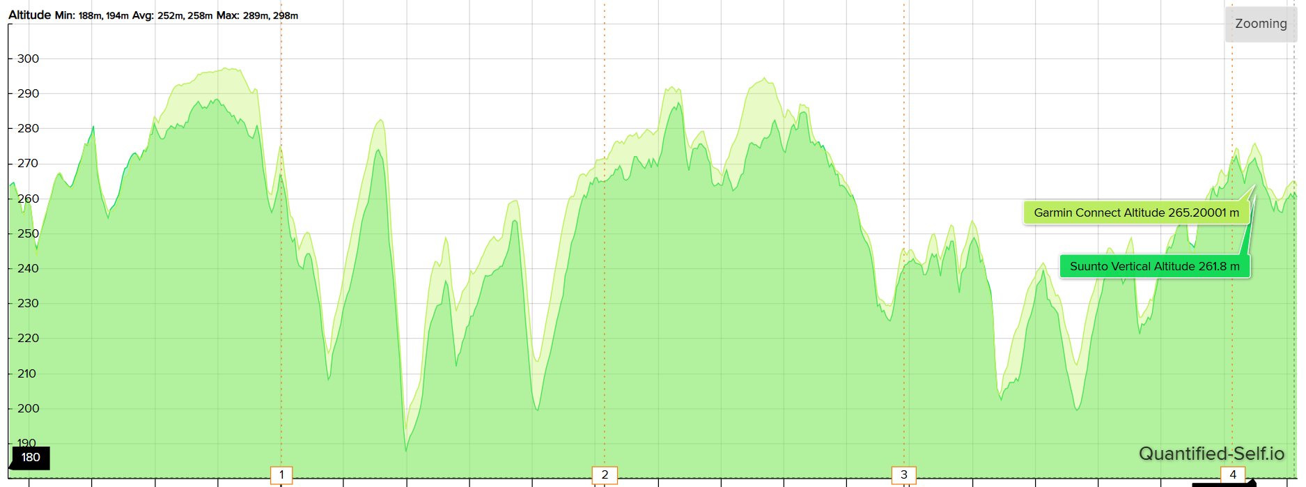

                Here is an example during this lunch gravel ride. Dual capture comparing Suunto Vertical (worn under arm sleeves) with Garmin Edge 1040 elevation data.
                If global d+/d- is roughly the same, there are some big discrepancies between the two. And regarding the terrain, elevation data of Garmin is more representative.

                  isazi Moderator @v.sacre
                  @v.sacre does not seem terrible. What happens in daily mode, if you set the watch to a certain altitude and do not move for many hours? Does it change?
