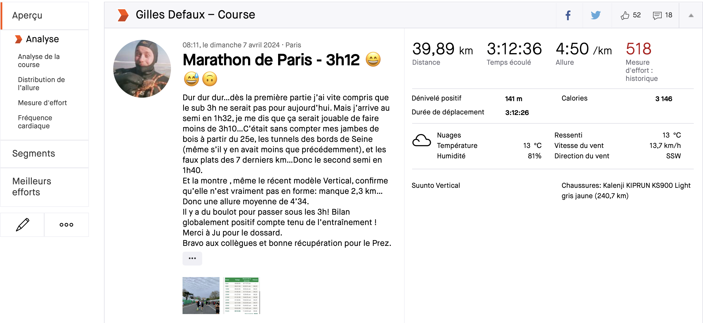

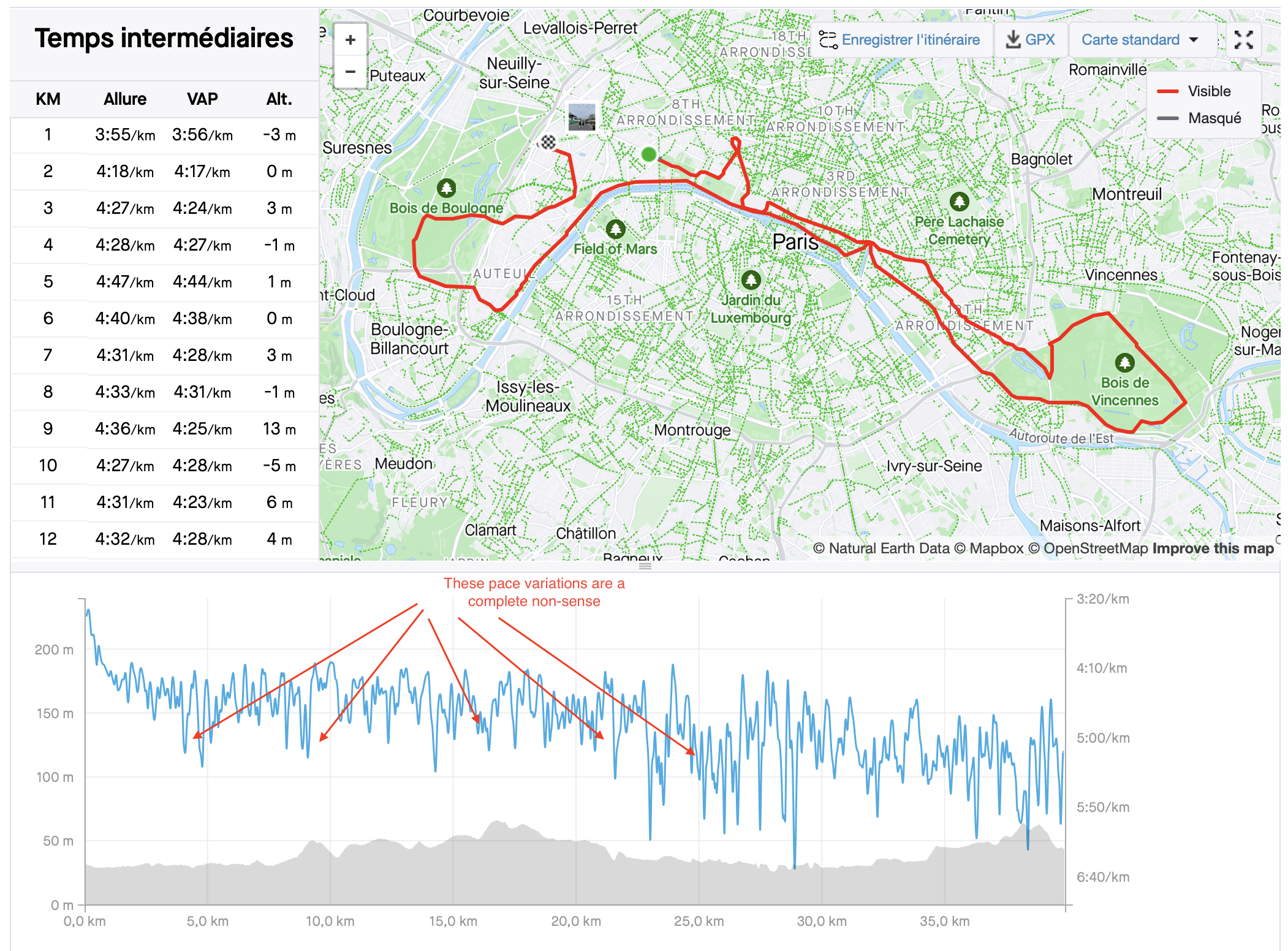

      I have a very recent case to submit and seek for help: this morning I ran the Paris marathon, and I was very disappointed by the watch. It was almost useless, except for the timer. I wanted to use the Suunto plus feature like the race pacer, but it is completely useless when the length calculated by the watch is not correct. As you can see in my screenshots, there are 2 things that are weird :
      • the total distance is 39.9 km vs 42.2 km, so 2.3 km missing!!
      • the pace variation is insane, and does not match the pace I had (you can check the 5 km pace which was measured by the organization, I was quite constant till km 25, after it was more difficult 😅).
        Every time I have an issue with distance, I observe at the same time the pace variation is going crazy.

          @Gilles-D If the Stryd was paired as a footpod all distance and pace will come from Stryd and not the watch. Auto-calibrate does not default to the watch and Stryd recommends not to auto calibrate with Suunto watches. Only if the Stryd is paired as a powerpod will the distance and pace come from the watch.

              @Brad_Olwin thanks a lot!! I was the one who post a similar issue with S9B, and the root cause is actually the same. So nothing to do with GPS and watch quality, rather a wrong configuration / understanding with a 3rd party device like Stry from my end! I think I am gonna drop the Stryd, since the Vertical has an embedded power calculator…
