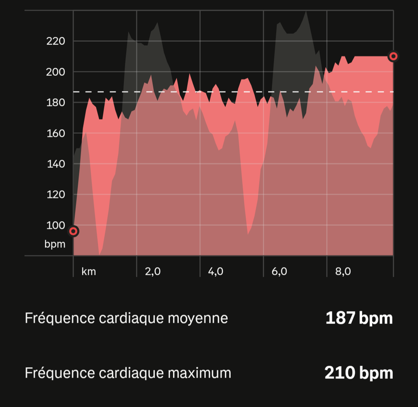

      @Brad_Olwin I just update my HR zone just in case.
      They were the default ones (not defined by myself) based on simple compute 200-age (if i’m right). Currently 36 years old (soon 37)
      I change my max to something like 198 (sometimes the watch reached that value or more but I set this one because the accuracy of the sensor is not the best vs belt HR which is in my case often lower) and I change the percentage of each zone to match with something “more” logical.
      Let’s see during my next exercice what will happen. I just hope all my previous training session will not altered the next result 😬
        Brad_Olwin Moderator @Liszto
        @Liszto That is not likely a good way to calculate zones. The Z4/Z5 interface should be your LT. LT should be an all out effort for 40 min. You can use the Suunto+ Cooper Test or LT test to get an idea of this zone. From looking at the HR trace I suspect somewhere near 170-175. I would base zones on a test or using ZoneSense for a week or more.

          @Brad_Olwin I would use my last 10km race because it was almost a perfect 40’ but I notice my vertical get an issue on it at the end… 😬
          I already noticed this bug twice before this one sadly where the sensor seems in default and stuck to something like 210 forever
          HR during 40min
            @Liszto Personally I do not get accurate HR using the optical sensor and always use a belt. But you could try the 40 min effort. Note that you should not be able to go any longer than 40 min at your LT.
