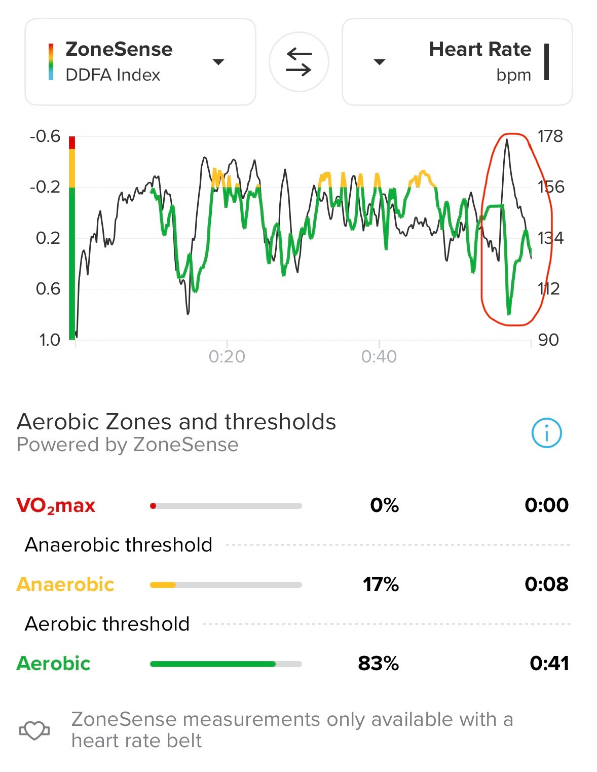

                                I still get some hard to justify measurements
                                Eg today on a trail run , going uphill , HR exceeded 180bpm for over 2minutes and zonesense was still on the green part
                                timecodeT 1 Reply Last reply Reply Quote 3
                                • timecodeT Offline
                                  timecode @thanasis
                                  @thanasis this happened to me just now. My HR was 176, Zonesense shows a huge drop. Not sure how to read that.
                                    Brad_Olwin Moderator @timecode
                                    @timecode ZS needs minutes to adjust. What you saw is normal. Your HR dropped a lot before it rapidly elevated at the end of your graph. ZS appropriately dropped then started rising. You were not long enough at a high HR! This has been stated many, many times here.

                                      This keeps happening when using Zonesense a lot. I am able to see data on my watch during an activity, but in the app the graph looks like this. HR strap is connected, HR data is there. Any idea why this is happening?
